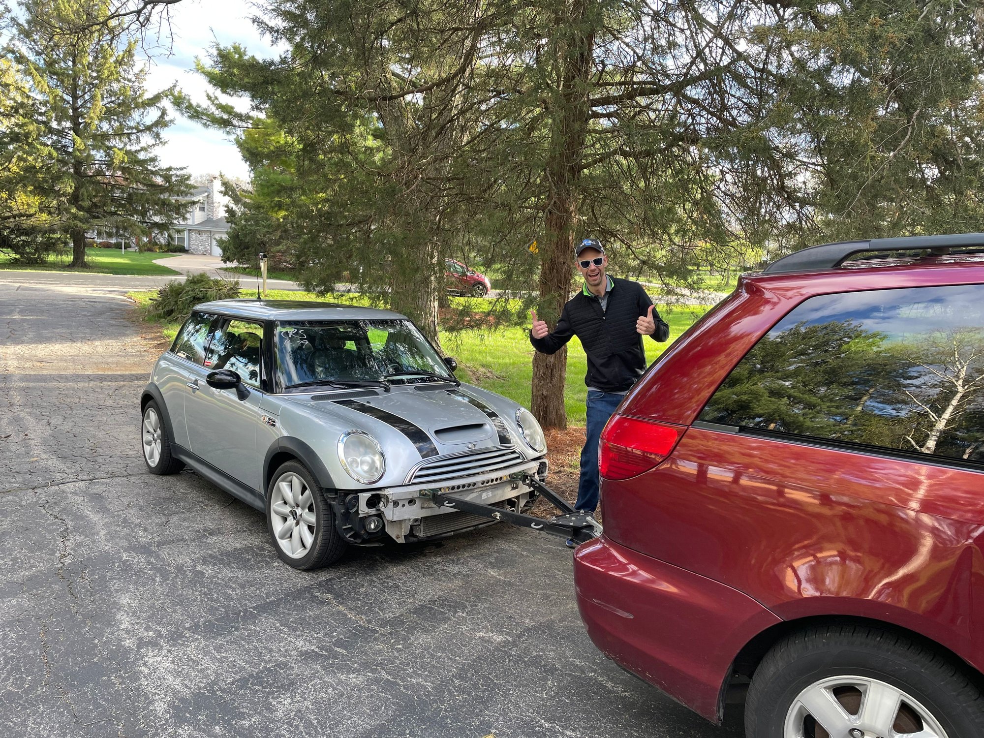

My mini partner in crime @wmcoons found a silver mini being sold for parts at a dealer locally that looked suspiciously like the subject of this thread. I was able to immediately confirm it was my old mini by the location of the rust spots. He found the car Thursday, and we flat towed it home with my Sienna after work on Friday. We have a front crash bar with tow supports mounted from a previous project, so all we needed to do was pop the bumper off and swap crash bars. I think this is going to be a permanent staple in tool kit.
We attempted to start it in the lot, and got no reaction from the starter, but knowing all the aftermarket parts that were on it, I thought the asking price was fair running or not. Gages worked, but that's it. We pulled it into the garage last night and did some very quick investigation. The engine was stuck but came loose with force, #2 spark plug and tube were pretty cooked but intact, and looking down the cylinders the walls didn't look smooth, but my borescope battery was dead so I can't be positive. Oil was overfilled, and the coolant reservoir was empty. And the intercooler diverter is pretty warped. See below. I think this engine got real hot. The sad part is, the odometer only has ~700 more miles on it now than when i sold it.
Uhoh
The plan is to take it apart piece by piece, save most of the suspension for the current project, funnel some upgrades to my dad for his mini, and part out the rest. Let me know if you need anything. I'll have a marketplace thread up shortly.
I'm a little sad that it's not going to live on, but glad it's back and I'm looking forward to a relaxing garage project. I need to load up on rubbermaid totes.

I very much understand, and share your sentiments. However, the picture above is just about the only good angle available.
Somewhat worse than when I sold it.
Both taillights are gnarly, as is the hatch. The driver's door is missing a 6"x6" section due to rust. The PO did do an excellent job of removing the packing tape residue that I had no success with. The roof looks great!
Part of the sale included stamping the title as "junk" so that's just another hurdle to saving it. Almost every component will go on to keeping other minis on the road, especially the electric blue project I've briefly mentioned in my other thread.
