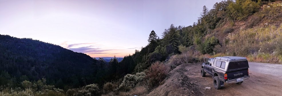

Jump to 2019 when I got a job in California, packed up my things and moved to San Francisco. I was looking for something to (once again) haul bikes with and do some camping with, so i bought a truck – Trudy, a 1996 Toyota Tacoma with a Wildernest on it. Then the pandemic happened and I started looking for a fun car to play on the backroads with again. Being in California I started looking at all the cool cars from the 80s and 90s that I always wanted but were always too rusty or too expensive to afford back home. Turns out they weren't rusty out here, but definitely still too expensive.

Trudy : I don't normally name my cars, but this came with one and it felt so fitting.
