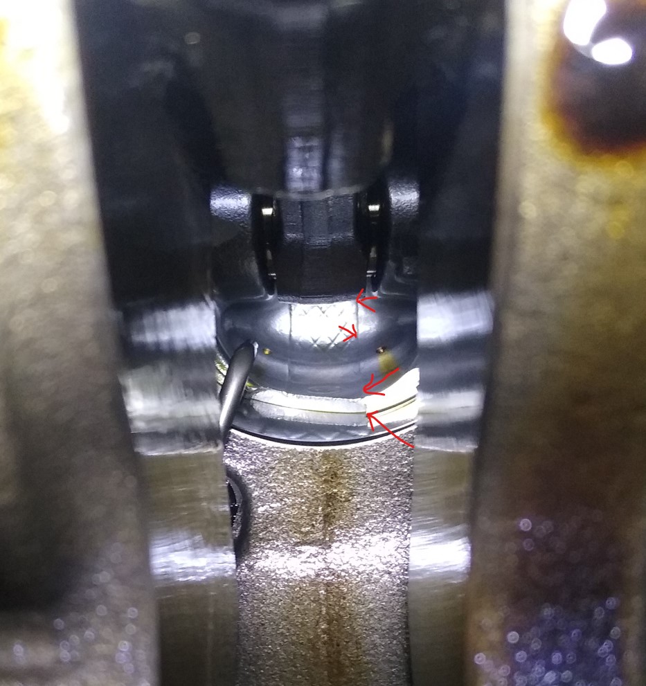

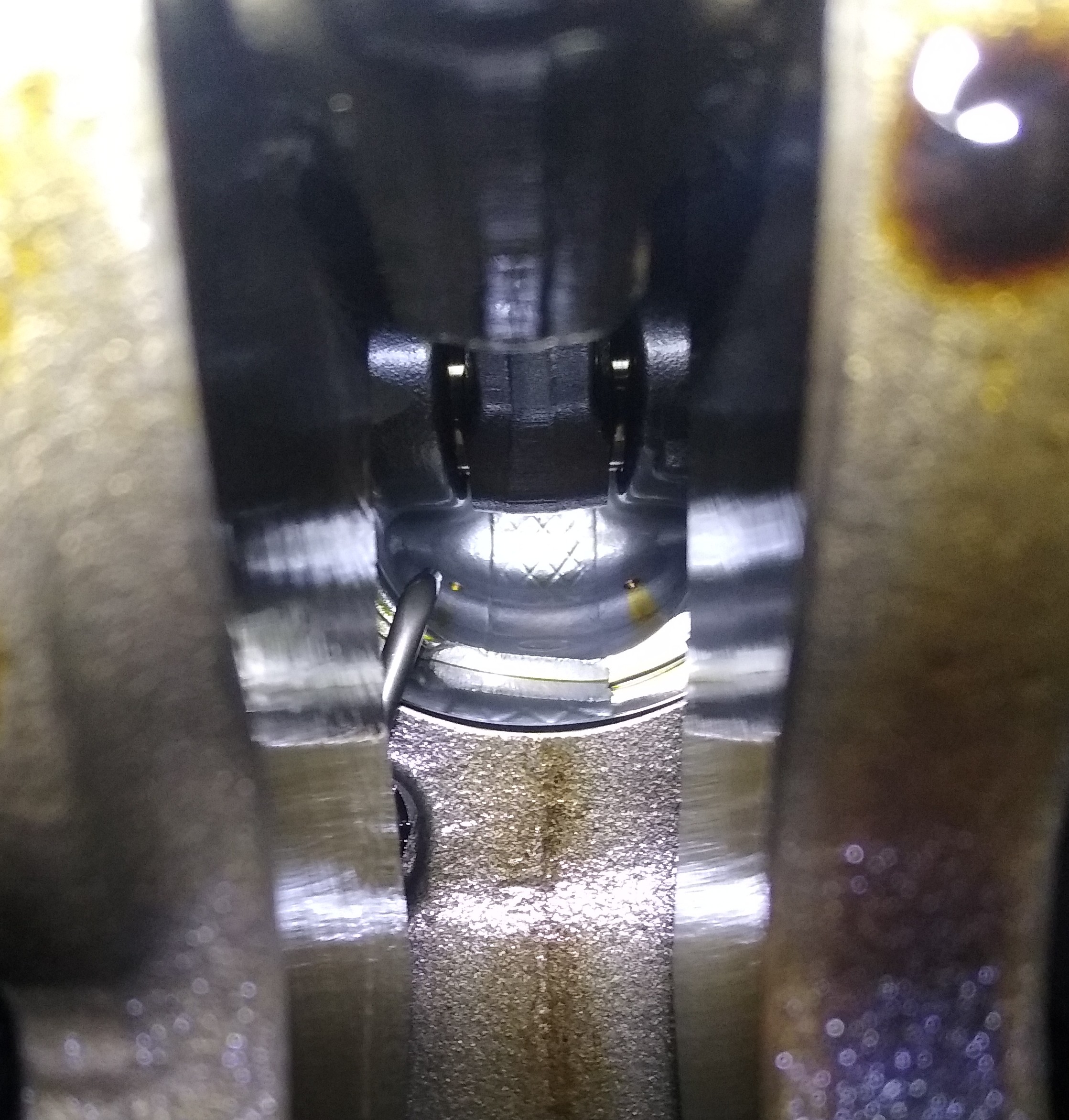

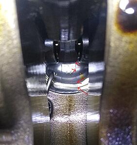

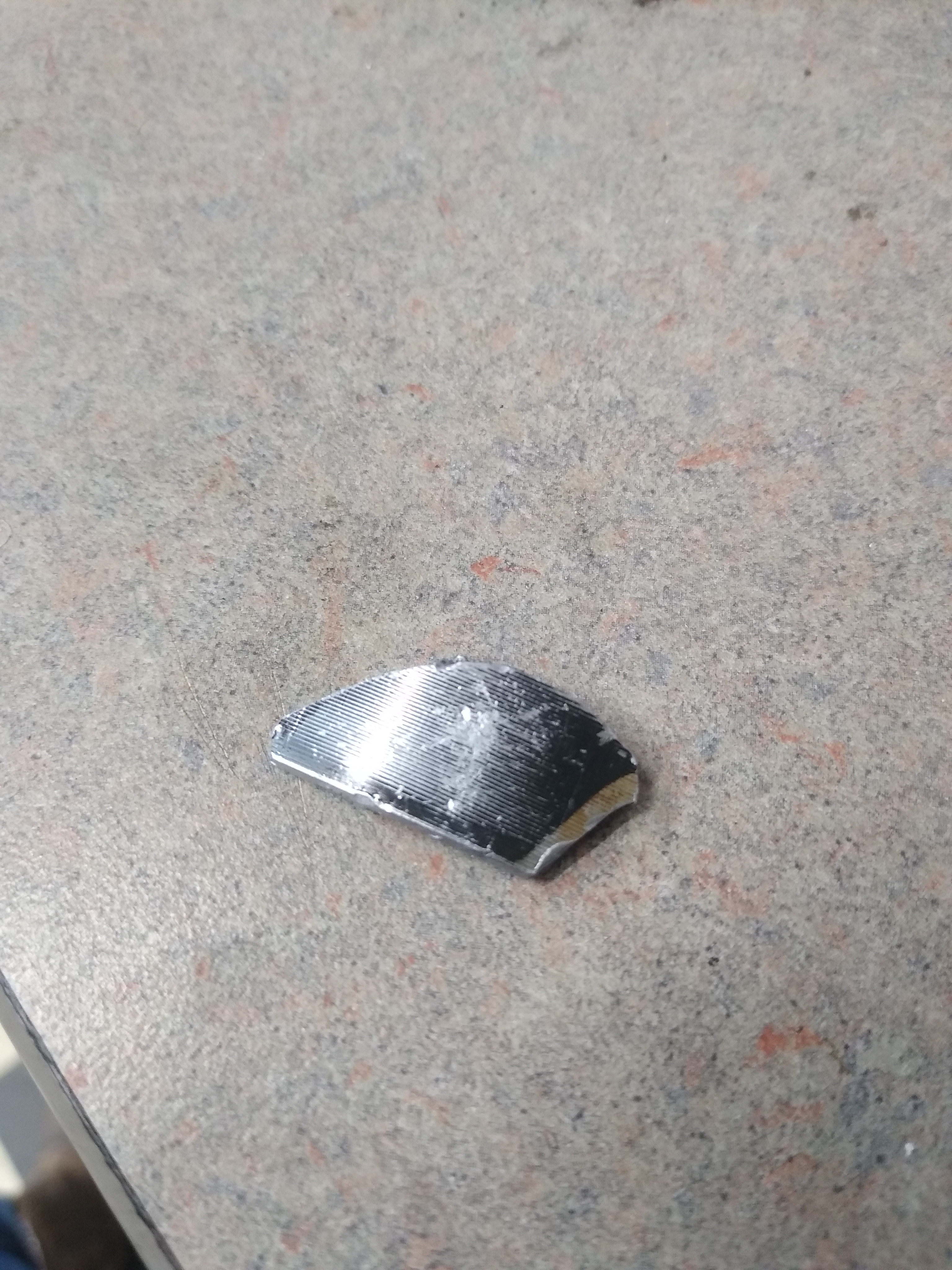

So after I pulled the pan off, I find this in the bottom. It's a small piece of a piston skirt. I looked up into the motor and found where it came from. Just a small little piece was missing. No marks in the cylinder, nothing scratched up.
The piece of the skirt down in the pan looks pretty worn, like it's been in there bouncing around for years.....

After looking at the picture a little more.....it looks like the crack started right where one of the casting lines was. I'm guessing this was a casting defect that caused this, not a mechaincal failure inside the motor with anything hitting the piston and knock a chunk off.

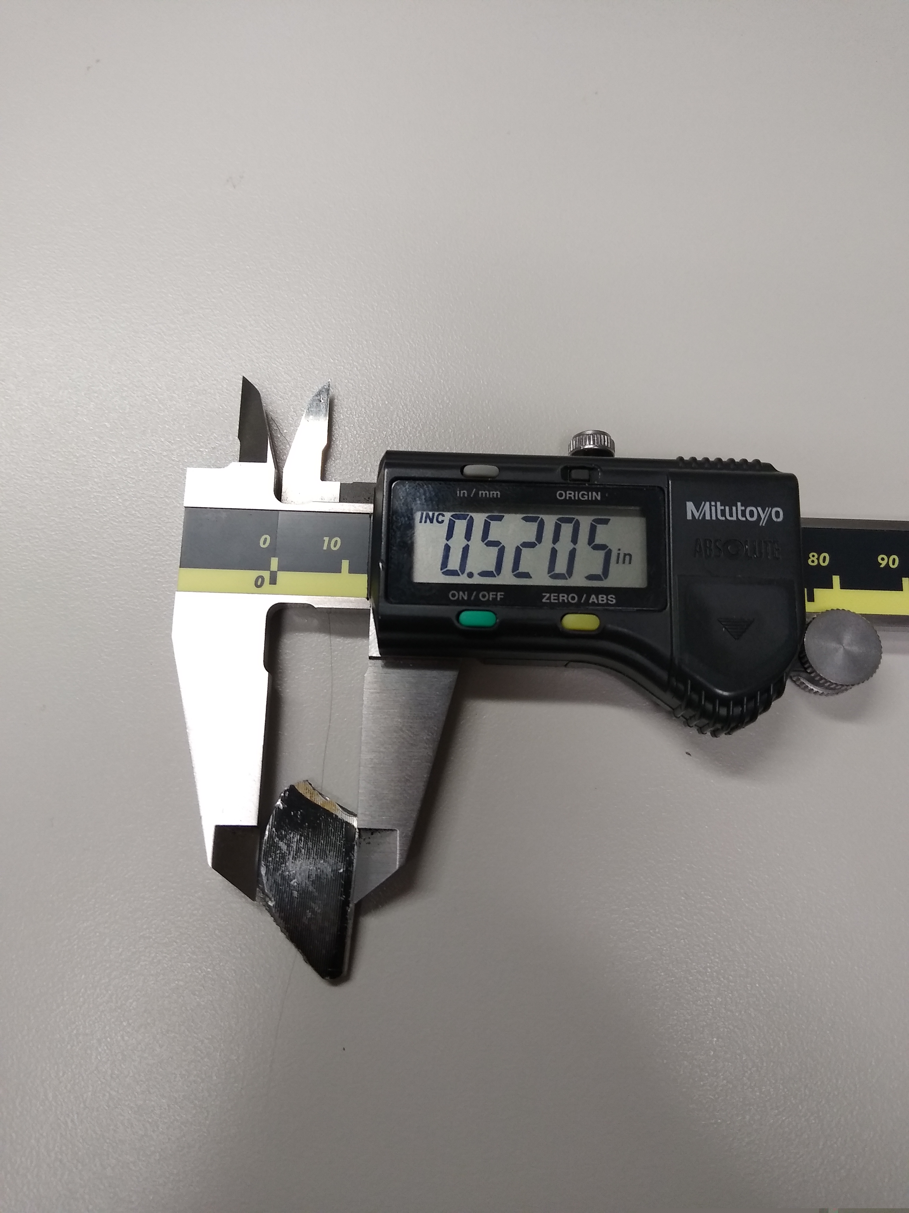

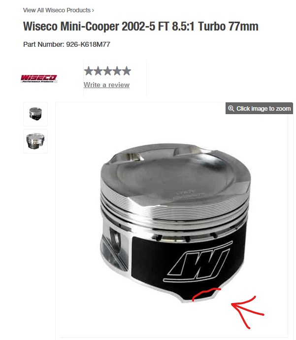

Yep, the cylinder looks great, not even a scratch on it. From what I can tell by looking at the piece I found, this is how much of the piston skirt came off. Doesn't look like enough to cause issues....I think the crack started on a casting line...and then traveled until it cracked completely off.
