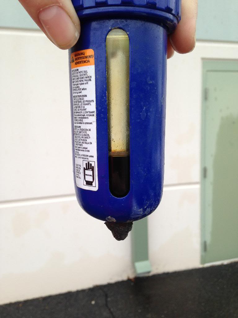

They work lol. I've used expensive cans as well as made my own from air compressor moisture separators.
This one was on one of my mustangs, it caught all that within 4-5k miles. Car only had about 90k miles on it at the time and ran great.
