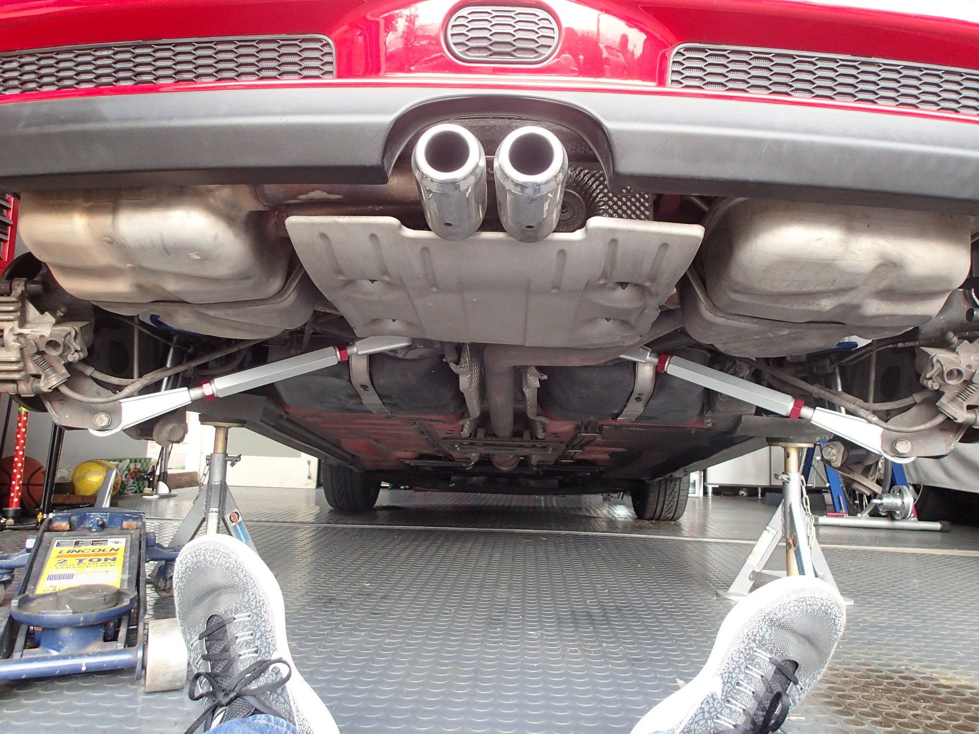

Another data point here. I put the Dorman version of the Eibach control arms on back in 2017 after we refreshed the suspension on the R53. So far, the cheap arms have held and has allowed the tech to set caster and camber exactly as requested. BTW, I got these on Amazon for about $30, they're now $45. A little more, but still quite reasonable.
Not a clean car contest, just showing the rear end of a 240K mile R53 with my kid's feet in the foreground.

I'm actually leaning more towards this Eibach form factor myself. Thanks for the input and the pic. Nice set up. I think it looks awesome. I'm hoping they're just as strong and reliable.
