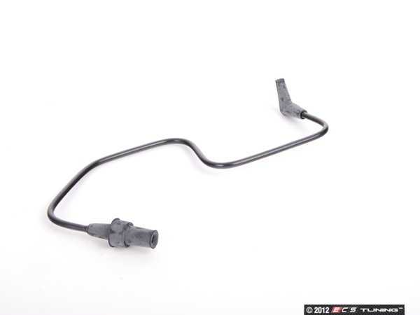

Something else to check, the vacuum hose of the fuel pressure regulator tends to disconnect when the car gets older (rubber boot). Advice: replace it with a proper silicone hose.

As to the vacuum fuel pressure regulator hose (you so kindly pictured): Is that the small hose that runs under the (passenger side) of SC intercooler horn?
It connects to the slim black canister looking "fuel recirculation valve", then under the SC horn to a 'T' connected hose?
If so; After the pulley mod, I tripped the SES light resulting in a P1477 fault. I found this hose was disconnected and the rubbery elbow had literally decomposed into mush.
I changed it out with a heat resistant rubber hose/tube (direct = no elbow).
Is that what you have described/pictured?

Wait a minute... It's THAT hose
I just googled "Mini Cooper S fuel pressure regulator hose" = Ugh! what a PITA to R&R that looks to be.....
Yes, that is the Fuel Pressure Regulator vacuum line.
what you've done to fix it is appropriate, and should be fine as long as it's a tight fit.
And yes, that hose being disconnected or cracked can cause real issues when it comes to leaning out the fuel mixture. (The T is probably there for a boost gauge, that's where most people tap in.)
Zip-tie'ing the valve closed basically takes the vacuum operation out of the picture, so if the zip-tie helped, your problem is almost assuredly the BPV.
And while the VGS mod will sometimes help, your better of skipping it and rebuilding or replacing the BPV.

As @nd-photo.nl pointed out - It just might be a failing fuel pressure line/hose responsible for the code showing up on the OBD. However - back to the power "jerk"; I suspect @BlwnAway may have a poignant assessment regarding a "sticky" (failing) bypass valve.
The Mini seems to run fine for now. With your help at least I'll have an idea of what to start diagnosing/replacing if it starts acting up again....
