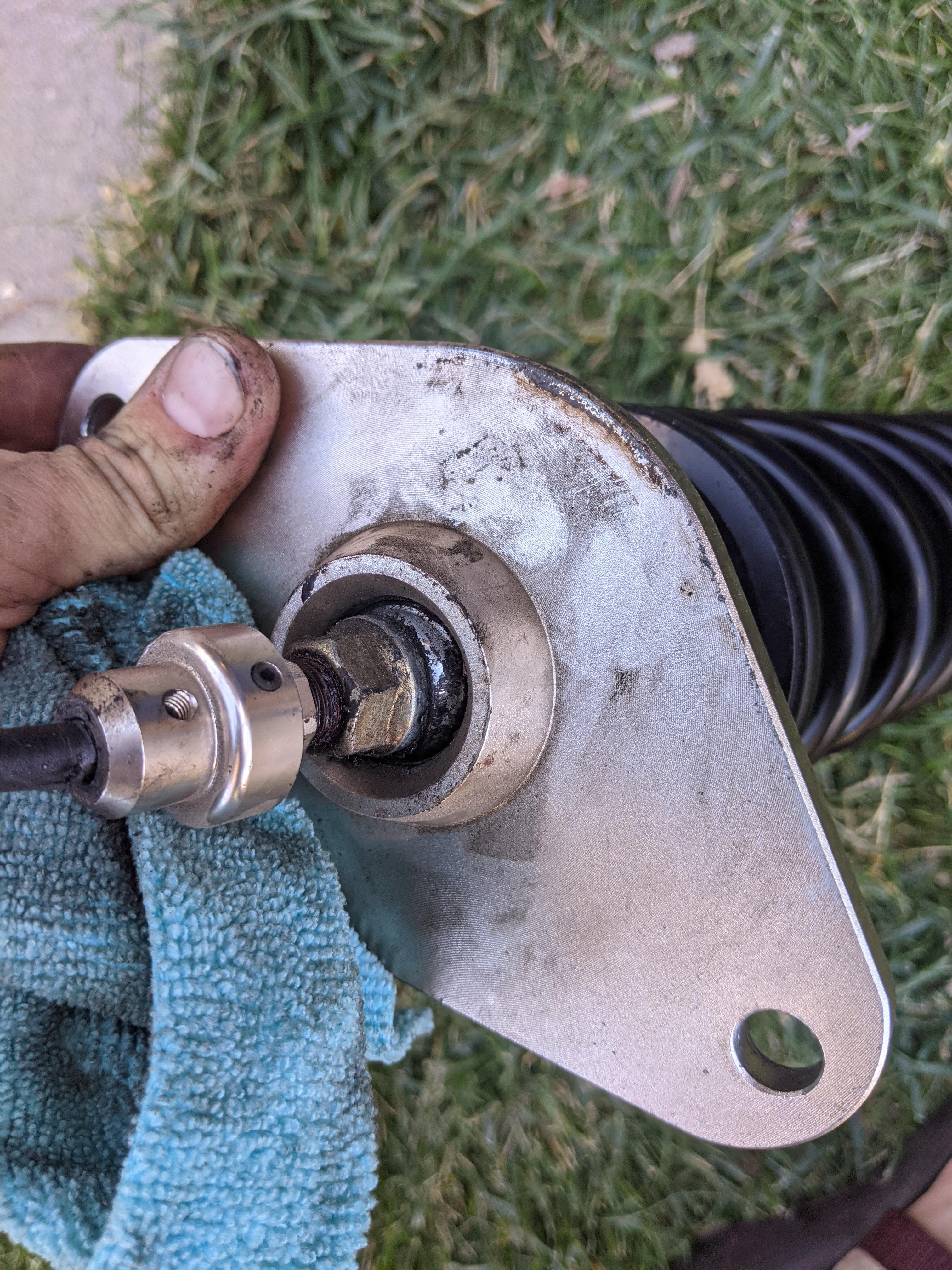

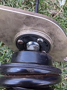

Pulled the coilover today and inspected. For all the **** people give BC Racing I think these look pretty good for ~40k miles. Dirty, but good. Removed the preload and cycled them - all was well and the adjuster makes a noticeable difference (hadn't had a chance to play with it on the car yet). with the coil out I was able to cycle the remaining suspension components and found the noise to be isolated to the upper-inner control arm bushing. Some lubricating fluid seems to have quieted things down but I imagine I'll want to replace that bushing. Looks like a real PITA. Hopefully, this helps the next person diagnose.

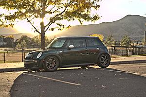

So, the good news I've actually fixed the problem, the bad news is that it was not in fact the upper arms. Maybe without a real load there just wasn't as much of a noise which fooled me into thinking the lubrication had quieted the groaning. In any case, I found that the adjustable hotchkis arms had loose locking bolts. Groaning cleared up and snows mounted has the car pretty quiet. Except for how badly the snows rub... Loose adjusters probably caused the car to lose some camber but I still think raising the thing an inch or so would be in my best interest. It could probably stand an alignment at this point regardless.

Looking good I like the height as is

Don't get me wrong, I like the way it looks, I just need the thing to be at least sort of practical. I don't think a little more ride height is going to slow me down at autox but it might get me to clear these snows without running tire-destroying camber
