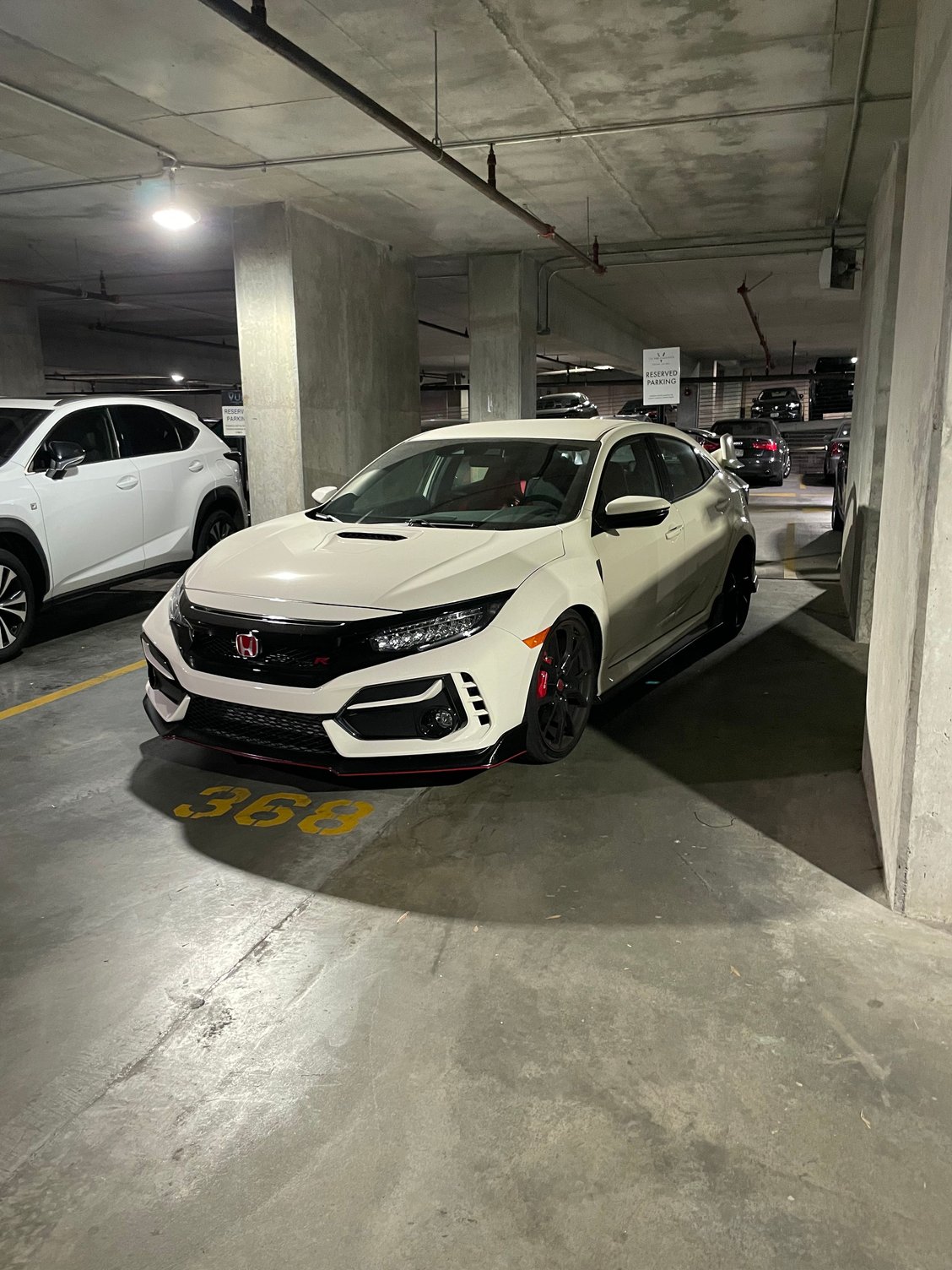

New to the forums and inheriting an 04 cooper (non s) with 23k miles from my grandma. Looking to start with simple mods - corbeau rrx seats, miltek exhaust, rotiform las-r’s & bilstein struts / h&r springs / craven camber plates to start. Any suggestions as an intro to this platform or any gremlins to know about? Other weekend car attached
