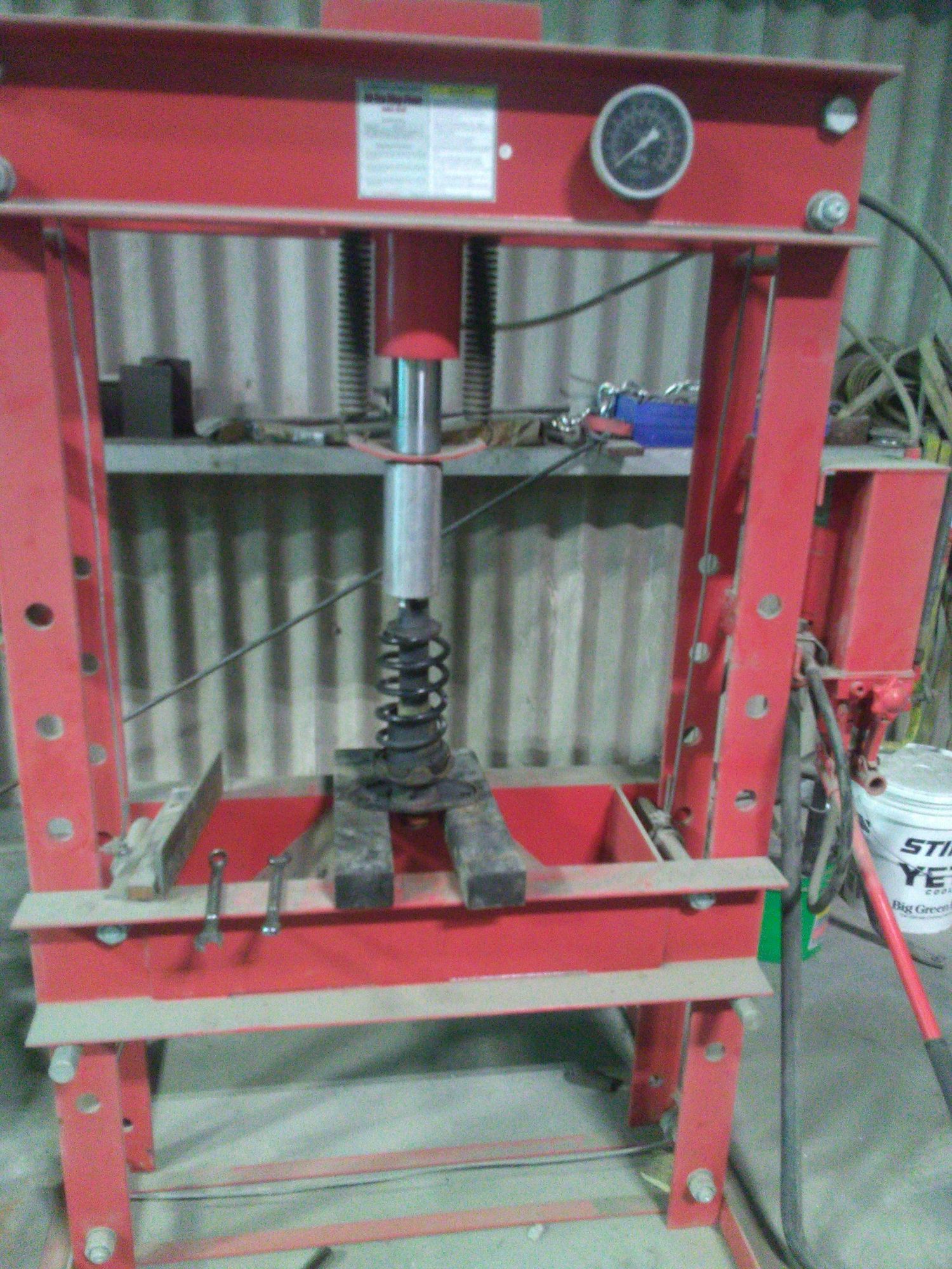

Installed a set of Bilstein shocks and struts, left the stock springs.
This was my solution for compressing the springs, it worked quite well.

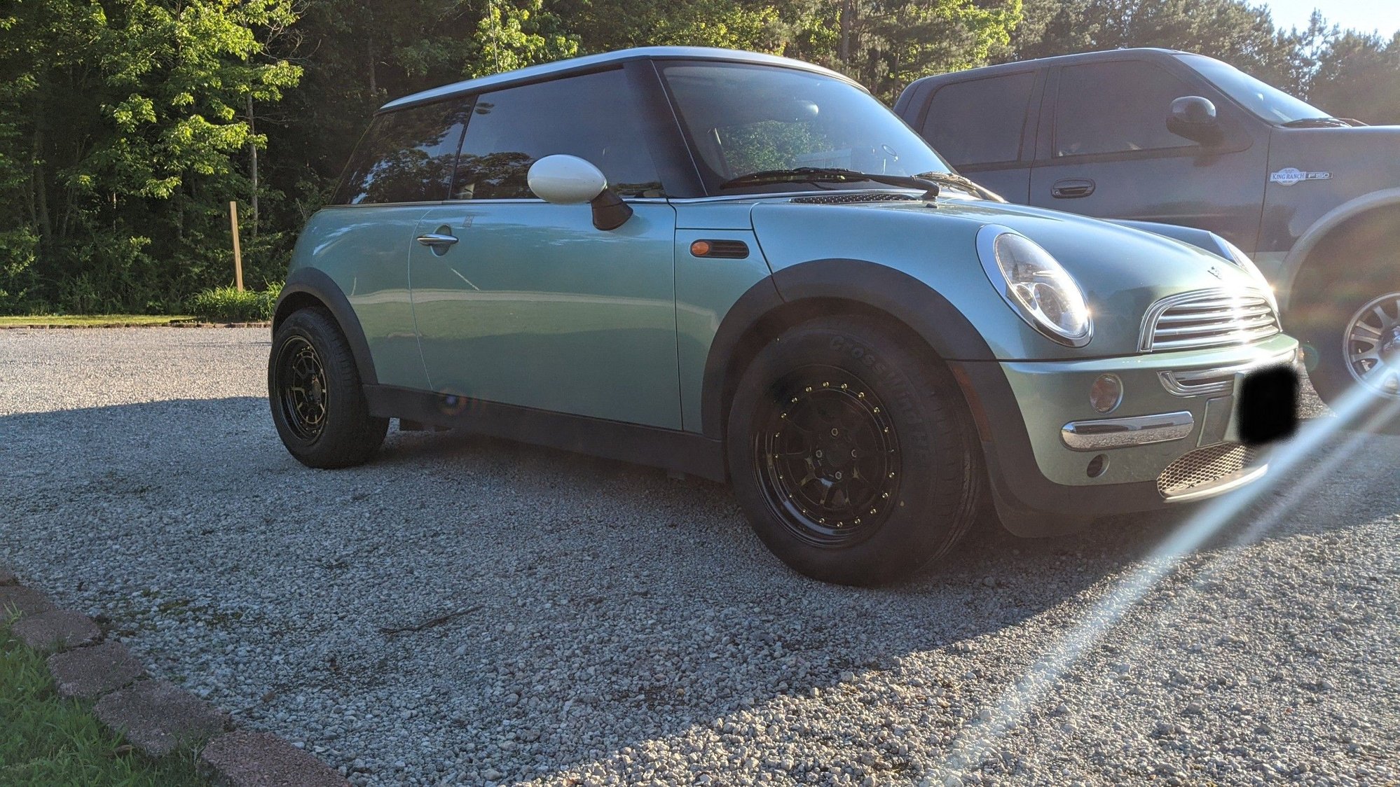

The most recent addition was a new set of wheels and tires.
I went with a 15x8" with an offset of 20 and 205/60-15 tires. More sidewall = softer ride. Even with the taller sidewall it still handles better than the 195/55-16's they replaced. It may be because there wider and have more grip or it could be because the old tires were pretty worn and hard.
Anyway, here's some pictures for anyone out there wondering if this tire size is an option and how they look on a stock height car.

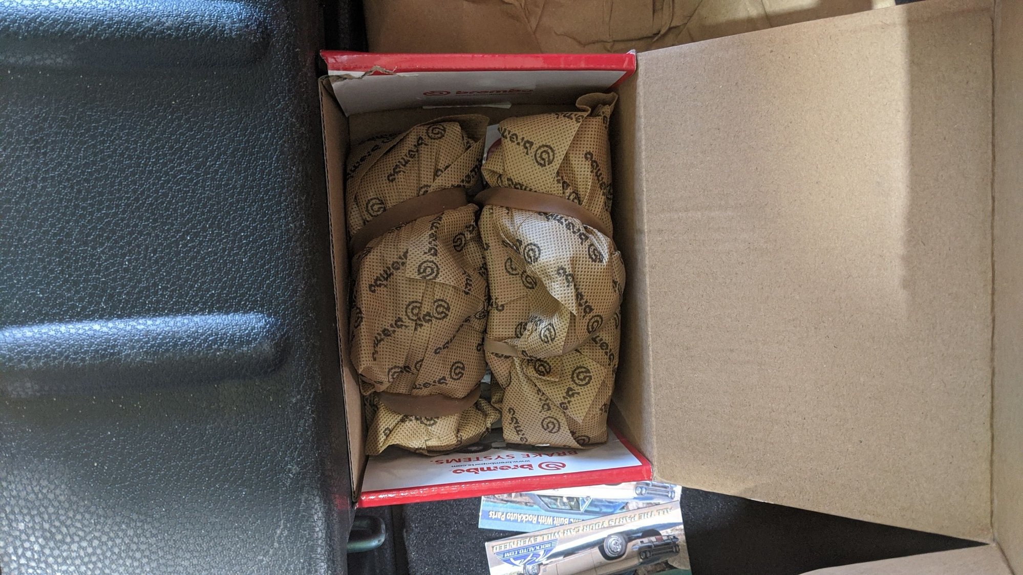

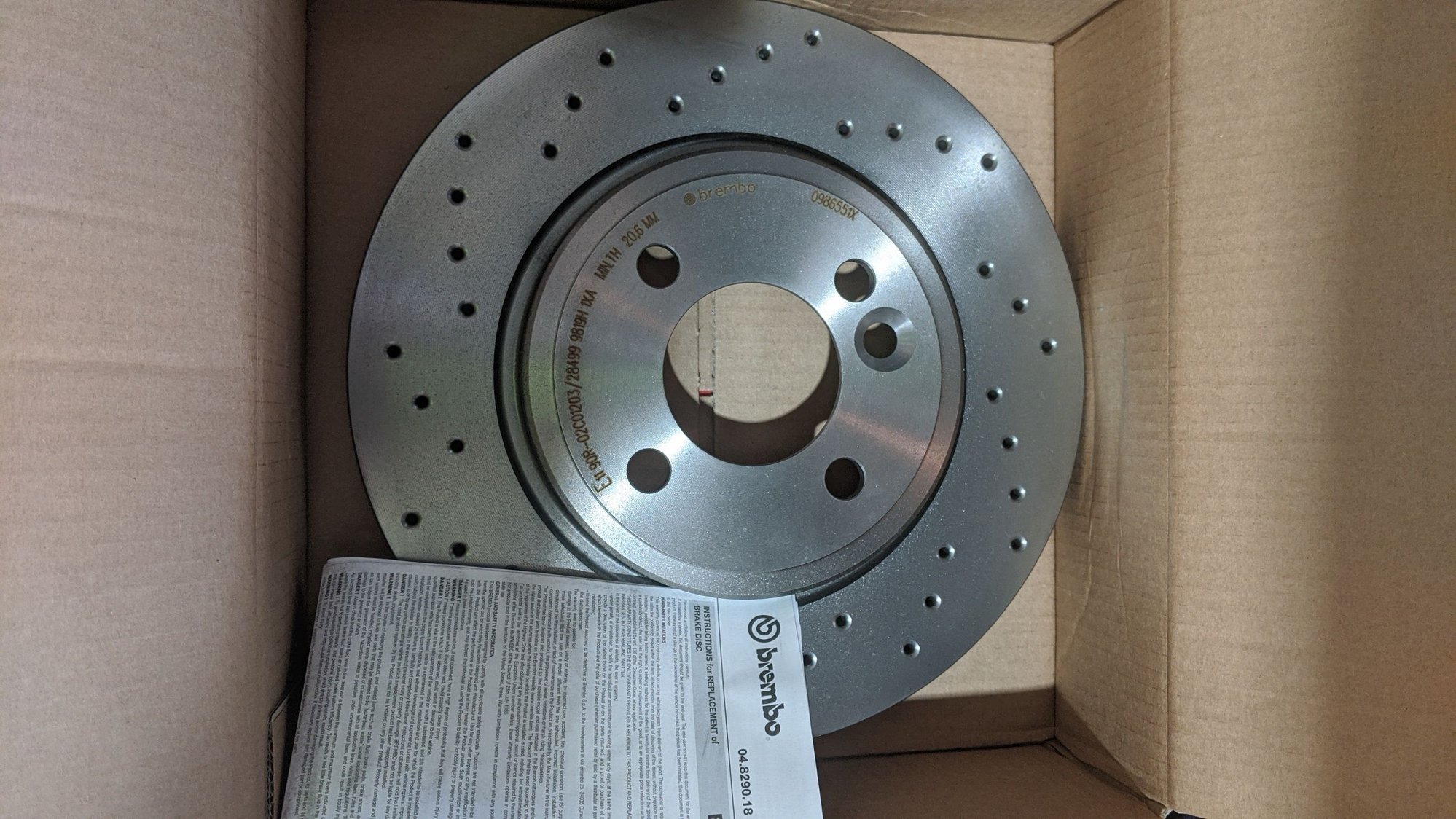

My front brakes were hammered so I ordered a set of Brembo pads and rotors. The rotors are drilled and zinc plated, pads are ceramic. Stock size replacement parts not a big brake kit. I haven't driven on them yet so I cant give any info as to how they compare to stock. I plan on bedding them in after work today then seeing how they do. I'm also trying to figure out if I should paint the calipers or not. Anyone have any suggestions for what color would look good on a silk green R50? Black? Red? Maybe just leave them alone so I don't draw attention to my chitty stock brakes? Lol.
Anyway, here are some pictures for your viewing pleasure...

Ok so I've had a few days to drive on the Brembo OEM style replacement brakes. They are very smooth and produce a lot less dust but I'm not really sure they are much stronger? They do stop very good and I notice zero fade from getting them hot but that's with spirited STREET driving only. I don't even think I'd try them on a track. I admittedly don't have much to compare them to though. I bought this car needing front brakes so I'm comparing worn out cheap brakes to quality name brand replacements. So far I guess I'm happy with them. It's a DD car that see's 150+ miles per day. They get the job done.

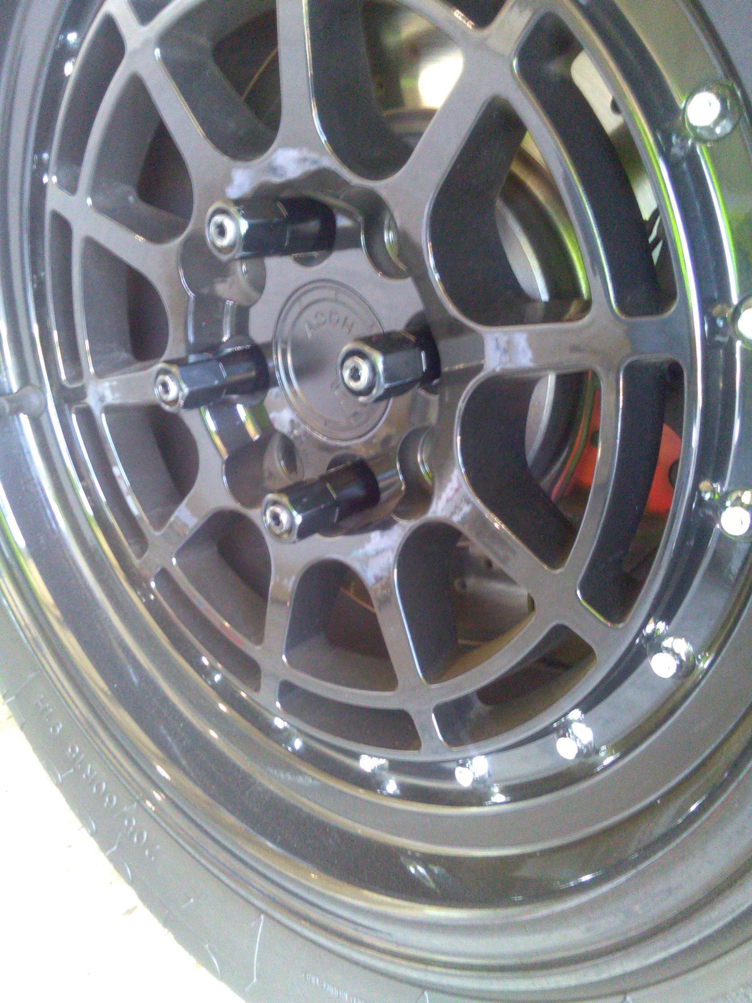

First, I put these eBay wheels on my car and I didn't realize it when I ordered them but all the little rivets around the outer edge are gold. Nothing else on the car is gold so that had to go. Same guy that told me about the tire shine also informed me that you can buy those little rivets in just about any color you want. I went with chrome, I hate chrome but this car has a ton of chrome on it so i figured it'd match well.

So I've had wheel studs and nuts listed in my signature since I joined NAM because I had them sitting on my shop bench (or rolling around the floor board for the last 2 weeks) but hadn't gotten the chance to install them yet. Well I finally put them on. I've seen nice kits for sale for BMW's with gold zinc plated studs but I'm cheap and wanted the longer style nut anyway so I ordered everything separately. I ordered a nice set of zinc plated studs and they sent some black oxide s***. I didn't realize it because I didn't open them right away and by the time I did the seller said it had been too long to return them. I was pissed because I paid extra for the zinc plating so basically I got scammed. The nuts are actually nice though so that's good. I painted the top of the studs so they wouldn't rust then coated them with anti-seize. I installed the studs with locktite and torqued them to spec by hand then hand torqued the nuts. I like how it looks and makes mounting the wheels a lot easier.
