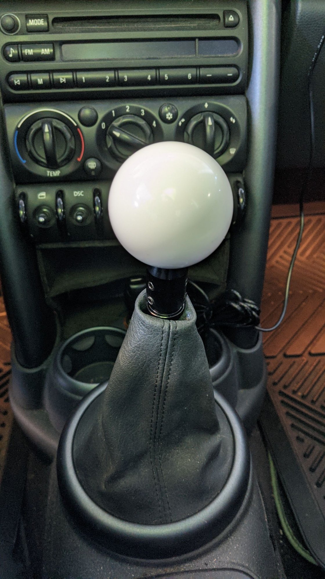

My little brother inspired me to put a better shift **** in the MINI. I bought an acrylic "Q ball" **** awhile back. Just got an adapter since MINIs use some kind of stupid snap on thing. If I like it I may either get a short shifter with the correct threads on the end or go my brothers route and cut the top of the factory shift lever and thread the top. I'm not really digging the adapter but I love the ****. I should have put it in today but injured my back last week and I've been trying to take it easy to give it a chance to heal. Maybe tomorrow I can pop it in.
Here's some pictures. I went with acrylic because we have an anodized metal **** in the mustang and it gets got as hell in the summer sun

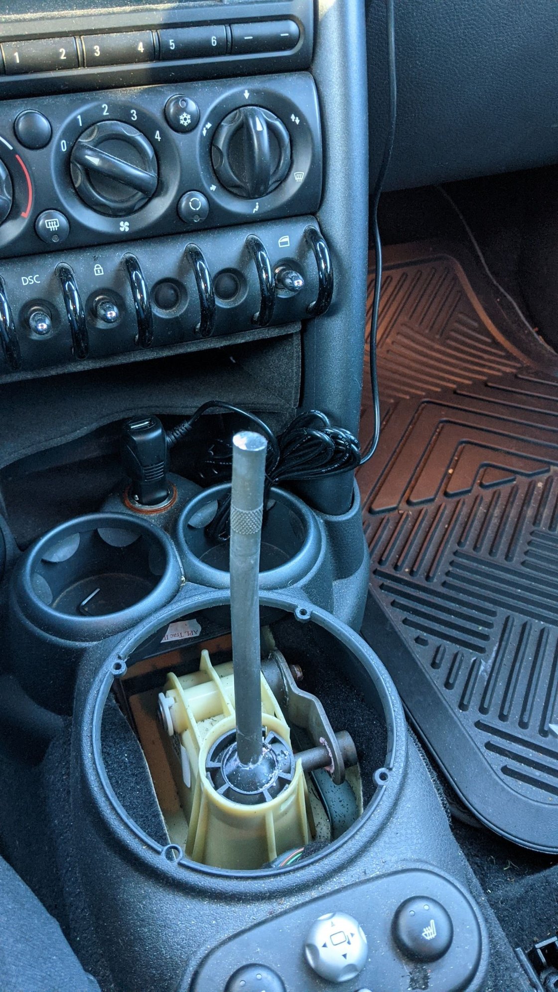

Well like I had hoped, I was able to work on the MINI last night. Please excuse the disgusting state of the car as I've been busy lately and its cold out lol.
Here is the box stock R50 5 speed Midlands shifter.
I popped the **** off without much drama and slid the threaded adapter onto the plastic lever and it just happened to be the exact same size. It was actually a teeny bit snug and I had to smack it with the palm of my hand a few time to seat it all the way down. With the set screws tight I couldn't move it at all. Very Nice! Buuuuuuuuuuut, it was a solid 2 inches higher than the factory ****.....which is already too high.
This is with the boot pulled up, still looks like crap. It also reminded me of driving the old 1950 something International Harvester dump truck on my neighbors farm growing up. Notice how the boot is stretched tight too.
So I pulled it all apart and took an angle grinder with a cut off wheel to it. The goofy looking plastic piece on the top of the lever is held on by friction. You can see the hash marks about halfway down the shaft. I ended up removing all the plastic. The only downside is the shaft is a smaller diameter so the adapter isn't as snug. I remedied that by wrapping it in 1 layer of self adhesive electrical insulating tape.
This is the end result. I cut about 2 inches off the shaft to get it to the same height as factory.

I saw a tip on NAM somewhere to do a conversion to a more "handle" style ****. I also had the orb one, but the Mini shifts way better with a handle type ****. Try it out somewhere in the future, when you are ready to try something different

Yeah I already had this one but the cool thing is the adapter is a standard thread size so I can easily swap out whatever I want now 😁.
I was thinking maybe something like this. I had this "****" in my old Conquest TSI back in the day and loved it.
https://www.ebay.com/itm/Universal-M...-/402532504717

Ha ha will do.... although I don't know when. I'm enjoying the Q ball for now, plus it matches my white top and mirrors perfectly
