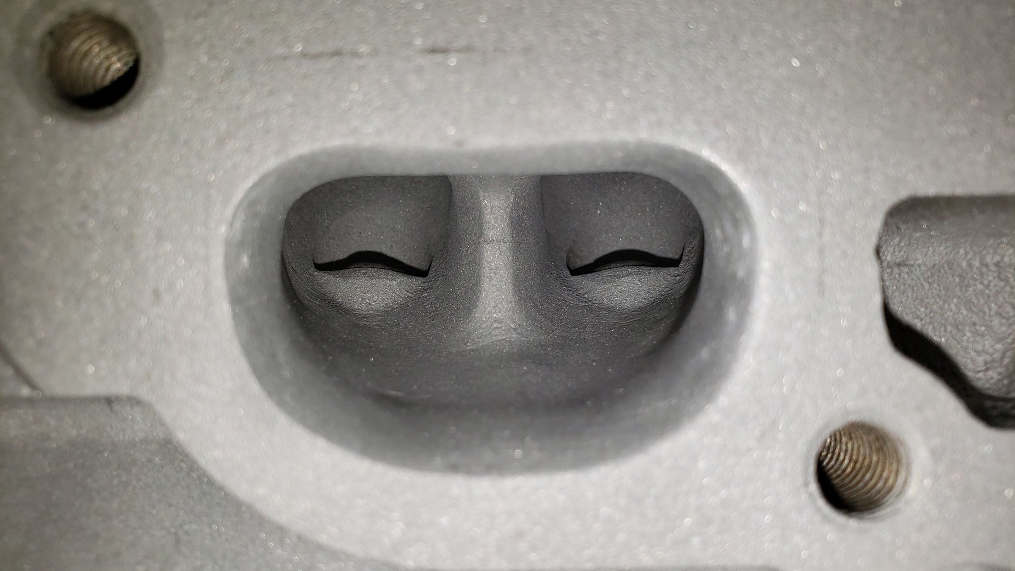

I dug out the R53 head I picked up awhile back and started porting it. I think I have at least one burnt valve. Meant to do a leak down test while I had it in the shop but completely forgot and went on to other projects.

I still haven't had a chance to weigh the new tires but I did finally finish the R53 head I picked up forever ago. I did a mild port job. Gasket matched the intake and smoothed the mismatched casting seams. Thats it for the intake side. On the exhaust side I opened up the runners a little being careful not to change the shape. I also opened up the bowls below (above) the valve seats. Then I bead blasted the entire head.
I may go back and polish the exhaust side. Haven't decided if it's worth the effort....

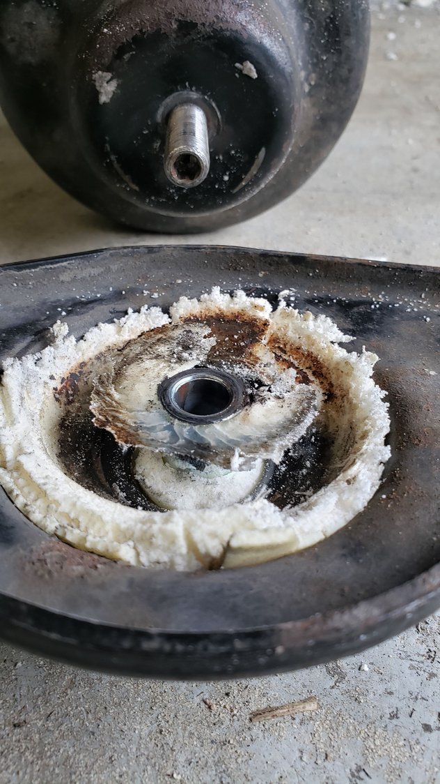

Rear shock mounts lasted all of 2 months and started disintegrating. Noticed bits of the white foam they're made of all over the garage floor. I ordered a set of red poly bushings for it.
Tires are shot. They were cheap Walmart tires I put on at 166k, 222k on it now so I think they served me well lol. Hopefully I'll have time to get a new set mounted in February. Trying to decide between the set I ran before thats made by Falken and Accelera phi R. Also have to pick between 195/60 and 205/50. Would love thoughts from anyone thats tried either tire or size. I have Konig Helium rims, 15x6.5"
Last but not least, I looked at the speedo on the way to work the other day and saw this so I snagged a pic.

Put the white bushings on in November IIRC. They held up great 🙄
Got me some red poly replacements this time. Hopefully they last a little longer.

Wow never saw a rear one that bad, seen them muchroomed a bit. That one was coming apart!
Good upgrade to the PSB
