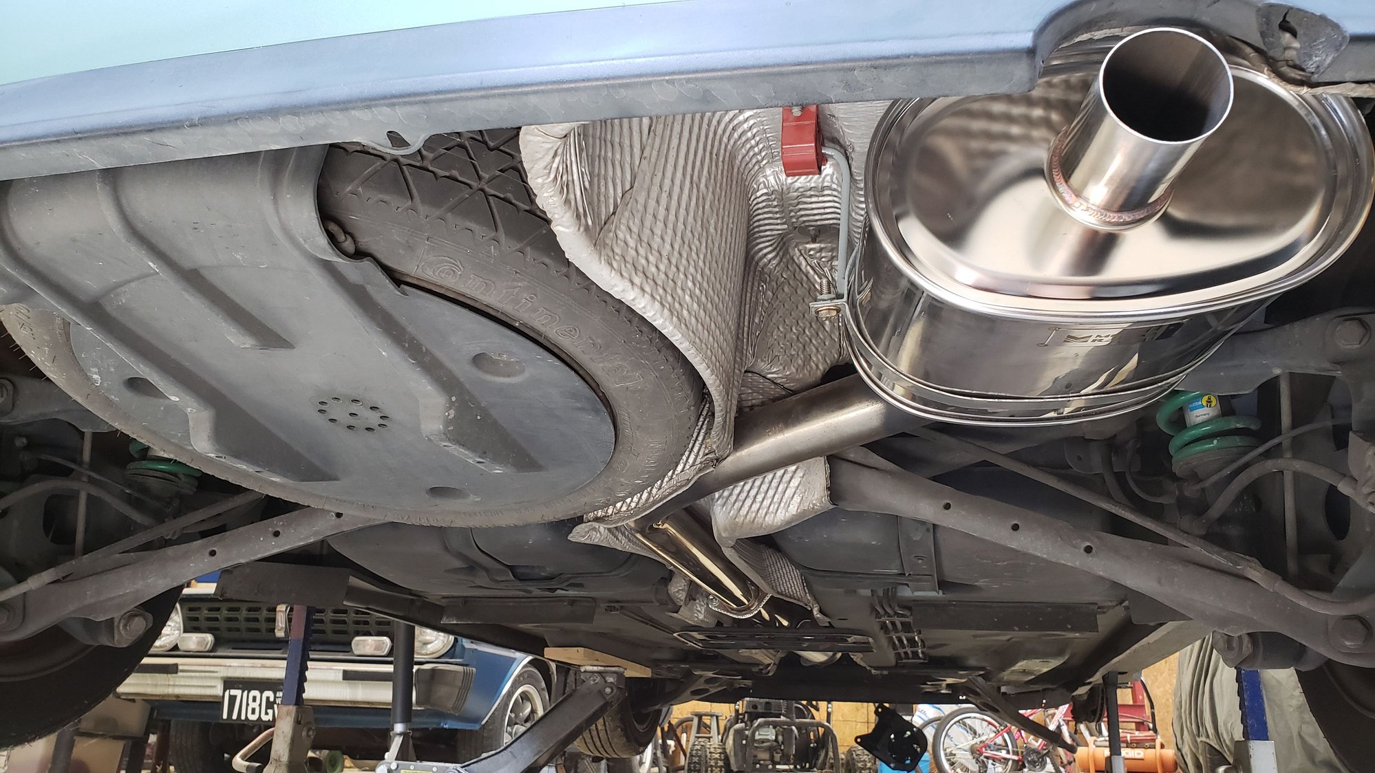

I got a chance to put the new muffler on today. Its a center in, center out Megan stainless universal. I wanted the offset version with a tip but it was out of stock everywhere I looked except 1 ebay seller that wanted $800 for it 🤯. I ordered a long stainless 45 but in hindsight I should have gotten a short radius 90 also. I pie cut it since I didn't have a 90. I've never tried that before. It came out ok but I used a flux core welder so it looks pretty messy. No leaks though.
It sounds SOOOO much better. That little fart can thing I've been running sounded so bad. And it got worse the more I drove it. It was honestly kind of embarrassing. Live and learn. And hopefully other people will read this and learn from my mistake lol.
On to the pictures!
Shiny
Working out the bends.
All done.
Its a little crooked but thats from the muffler bracket pushing the whole assembly to the right. I can fix that easy enough but i ran out of time so thats a job for another day.

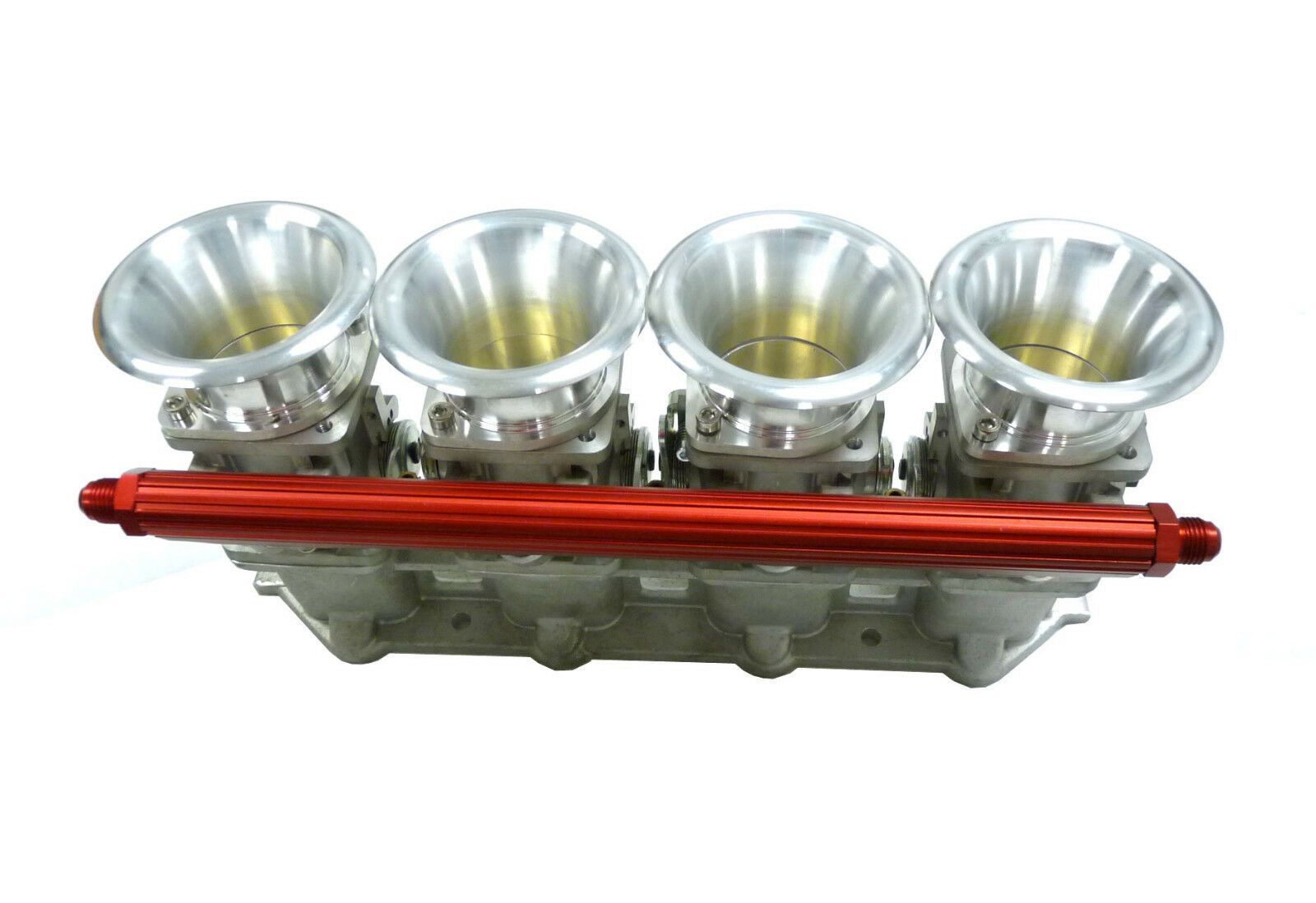

Found this little gem online this morning. It got me to thinking though, ITBS are sweet. GSXR's are fuel injected with individual throttle bodies, as in you can separate them and space them as needed. They come in 600cc, 750cc, and 1000cc. I'm guessing you'd match the size to your target HP? So maybe 600/750 on an R50? It wouldn't be that hard with the exception of the drive by wire throttle. I wonder how hard it would be to dismantle a stock TB and hook the linkage to it. That way you could retain all the factory pedal/sensors. Thinking out loud here but sounds like great fun...
Edit: That is a Mini Cooper 2002-2006 ITB. It cost over $1500

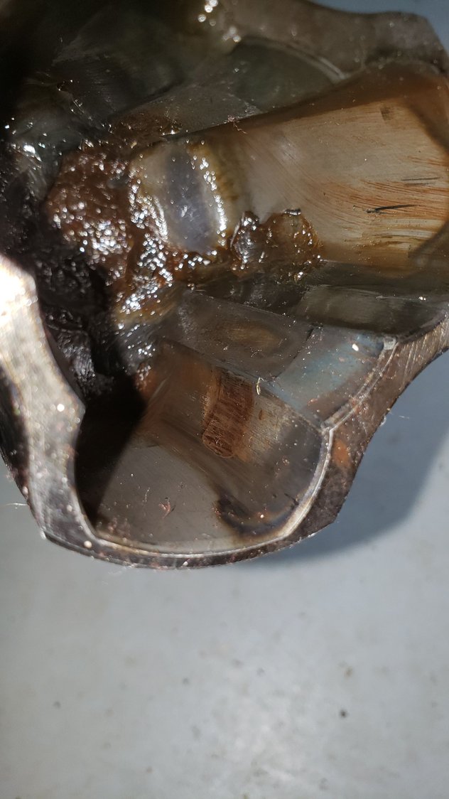

The new cv axle came in so I started swapping it out. I say started because the output shaft seal is leaking so I had to order a new one. The swap is pretty easy.
Remove the wheel,
remove the axle nut,
pop the lower balljoint off,
pull the axle out of the wheel hub,
I have a skid plate so removing it is an extra step most people probably won't have to do,
then I pulled the lower engine mount and bracket,
remove the carrier bearing bolts,
and pull out the axle.
Easy peasy. When I pulled the axle half the gear case oil spilled on the floor. Wasn't expecting that much to come out so it made a mess. It was due for a change anyway so that's OK. I removed the ps cooler fan too so I had better access to replace the seal.
Here's the cause of the vibration:
You can see the groove worn in the lower channel. The other 2 have no visible damage.
You can see the bad bearing here, its the rusty one lol.
