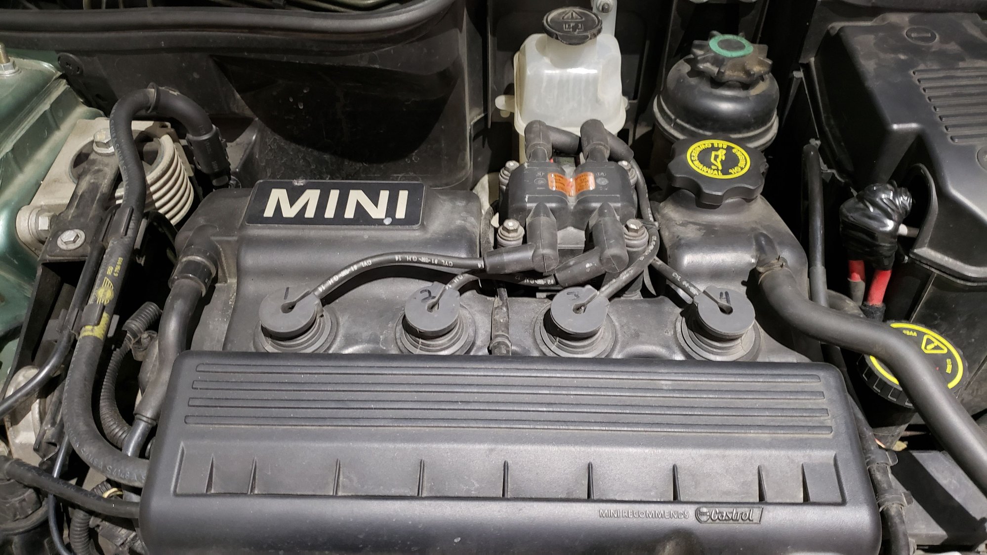

Next up is I finally replaced the coil and wires. Staying with the budget build theme I decided to give the red coil and wire set off eBay a try. I don't expect a performance gain but I am hoping it'll last awhile.
Stock parts.
Fancy bits.
The plug wires are massively thick. Like 10.2mm or something like that. There so thick there actually difficult to work with.
The other problem I ran into is oem bolts didn't fit in the aftermarket coil holes. The oem bolts are sleeved with rubber grommets and the end of the sleeve is 3/8 inch thick. I didn't measure the holes in the new coil but they were smaller than 3/8. I drilled them out on my press. The sleeves in the new coil are aluminum so it was really easy. Might be a pita for someone that doesn't have a lot of tools at their disposal so I figured I'd mention it.

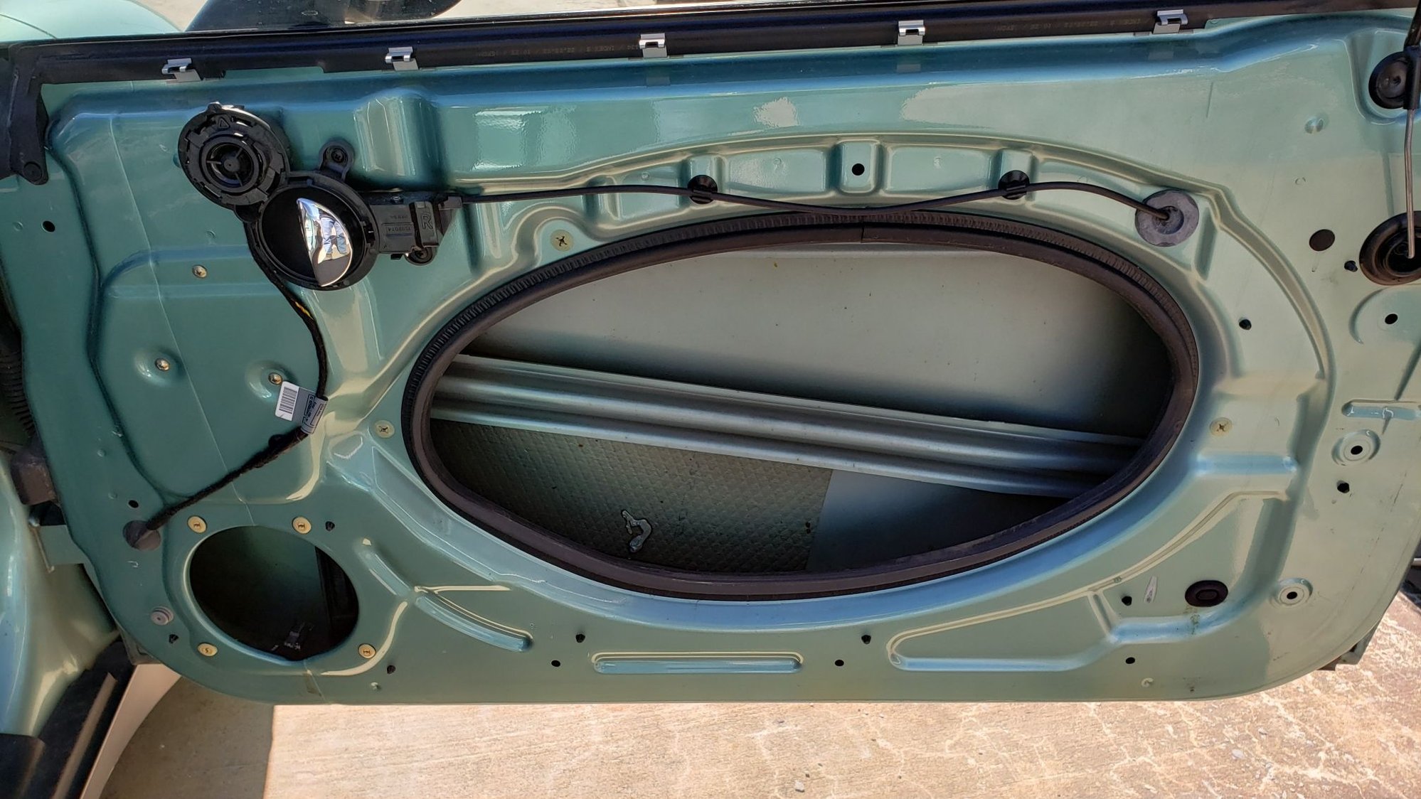

First thing is to get the door card off. The video I posted above is a good reference on how to that.
Door card off. The speaker is already removed in this pic also.

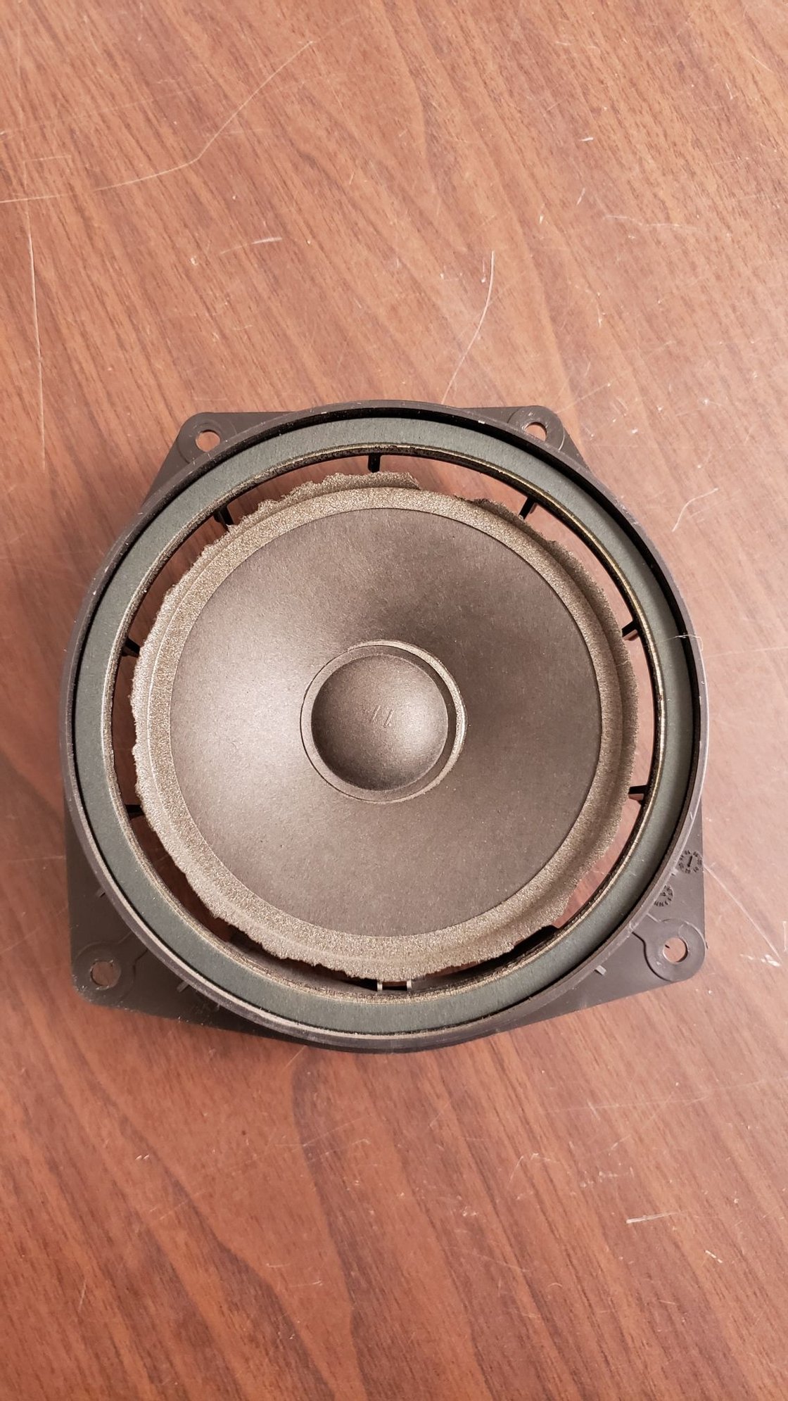

Original speaker....Nasty

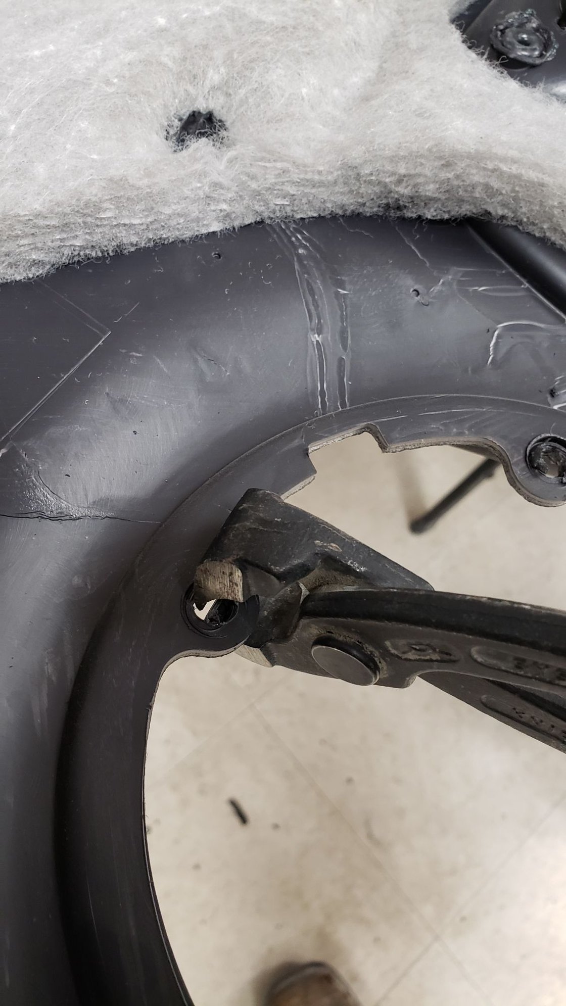

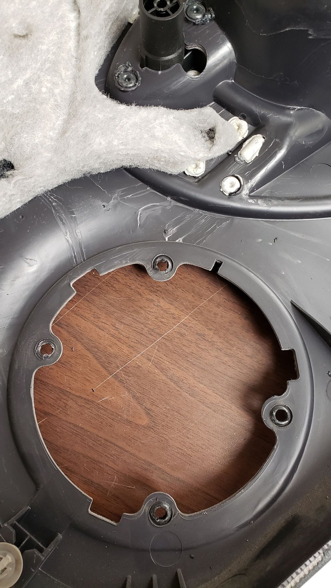

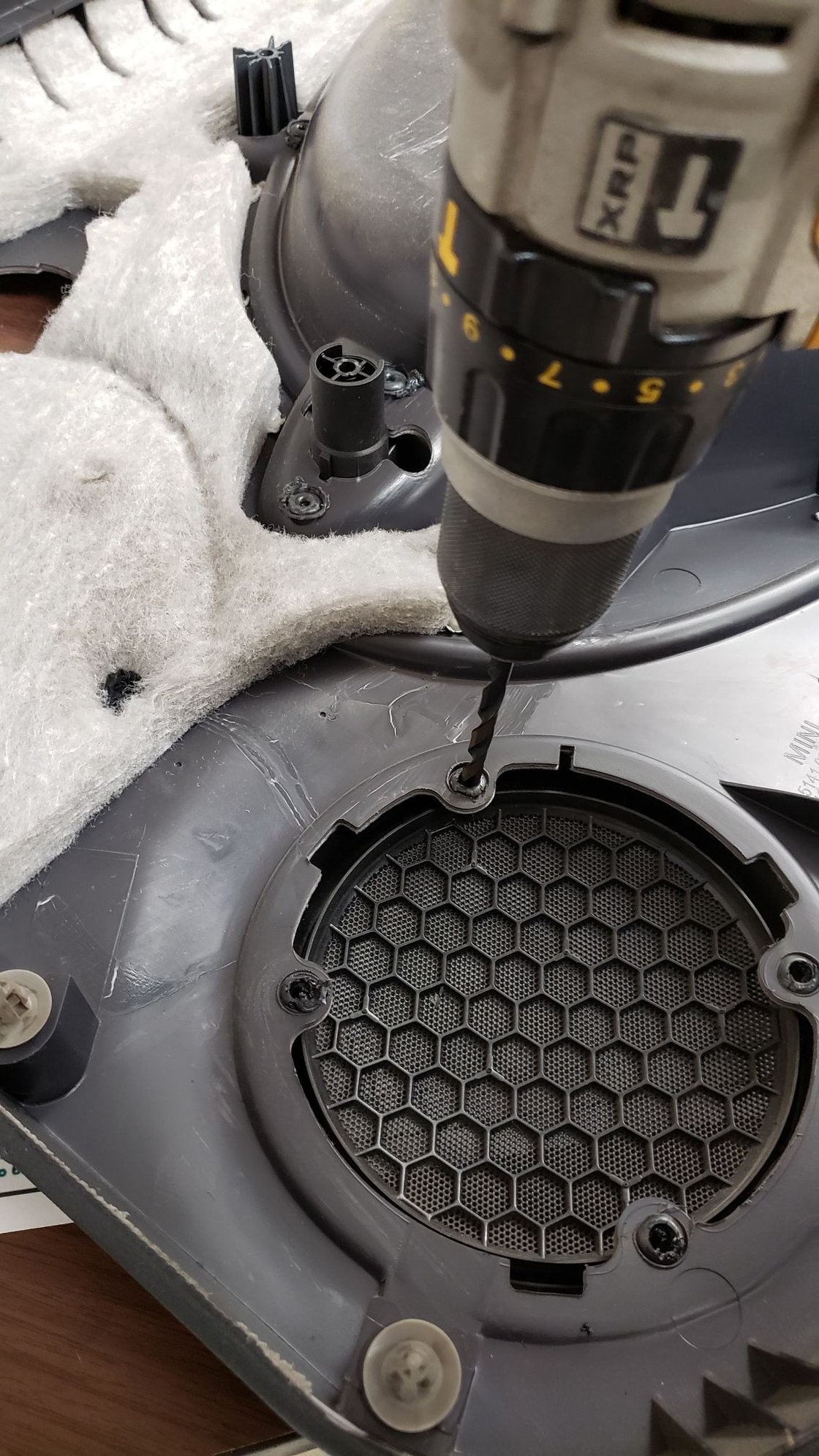

Once you get the door card off, flip it over and drill out the rivets that hold the speaker grill on, and pop the grill off.
It will look like this when your done.

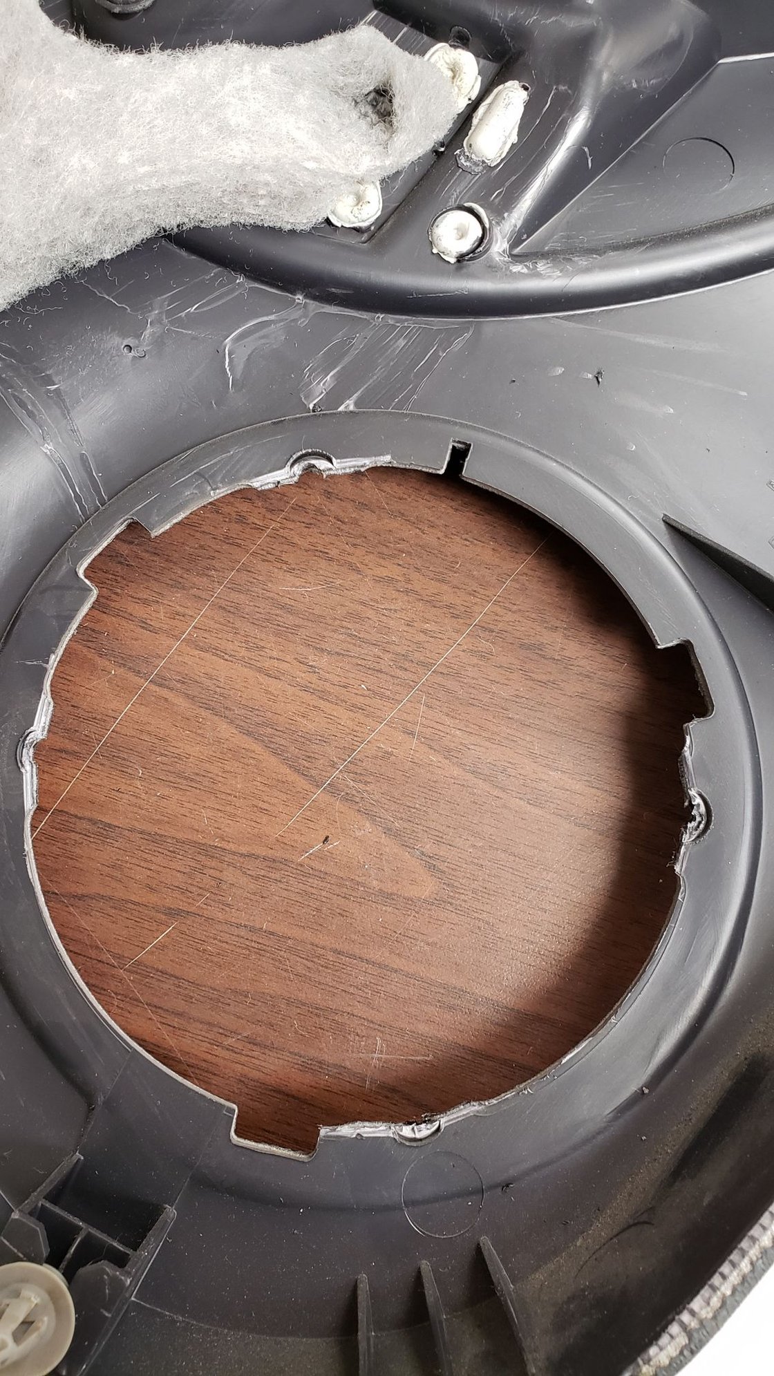

Next clip off the tabs that the rivets went through to make room for the new speaker basket.
You will end up with this.

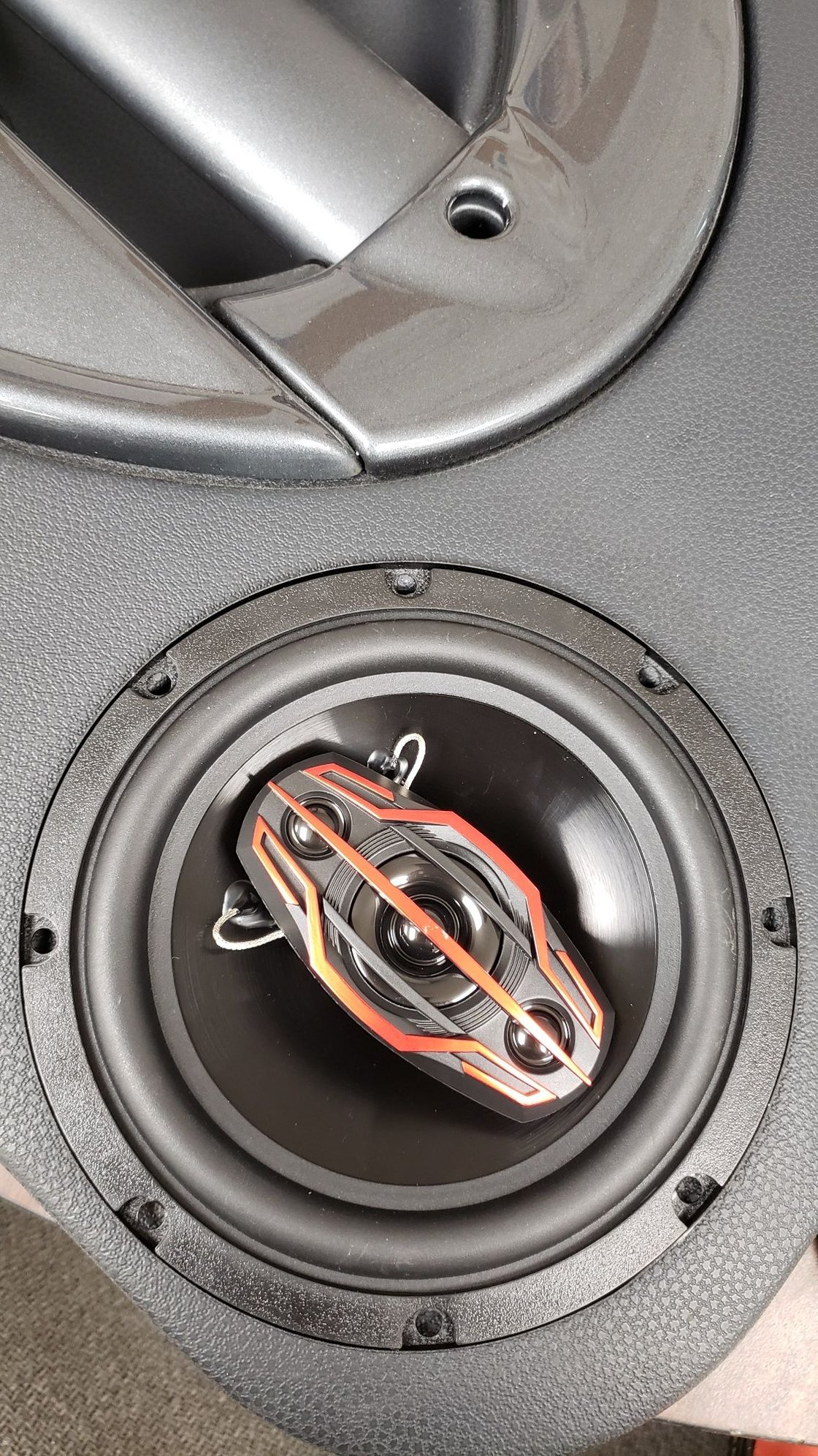

Now flip your door card back over and line up your new speaker. I used a cordless and put the screws in with just the speaker lined up how I wanted it. Next I removed the screws, put the grill on, and reinstalled the screws. I did it this way because it was easier to hold just the speaker while I put the screws in rather then fumbling with the speaker and grill and keep it all lined up.

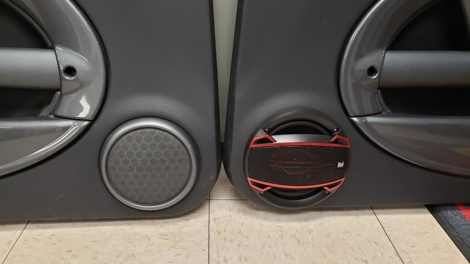

And here is the finished product next to the original.
I mounted the speaker to the door card instead of the door itself because I wanted to be able to see it and it let me run a bigger speaker. The problem you will run into if you try to mount a bigger speaker in the original location is the depth. You have less than 2" of clearance behind the speaker and the magnet on most decent speakers will hit the window regulator that is directly behind the speaker. Mounting it on the surface of the door card gives you a ton more room.
EDIT: The front door speaker wire colors are Yellow w/Red stripe for positive, and Yellow w/Brown stripe for negative. I ran into conflicting info online about this so I decided to post it here.
I also used the wires that came with the speakers and added standard male spade connectors and plugged them directly into the original speaker harness, I did not cut the factory harness.
