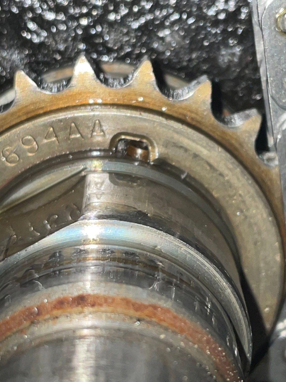

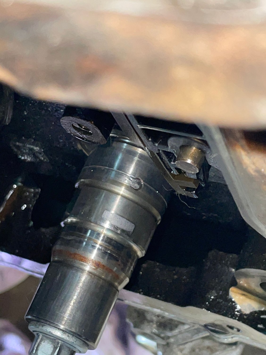

actually it’s worse I found the issue, when the chain came off the cam sprocket because I didn’t release the chain tensioner the chain came off and lodged in the bottom. Caused the crank sprocket to shear off the dowel pin which I didn’t catch so even though I would time it perfectly it really wasn’t since it had spun. Now I have to figure out how to remove what’s left of it???

Well I can’t get the sheared pin out and I’m not removing the crank so I have decided that after my new sprocket arrived I’m going to weld it in place with the dowel notch.

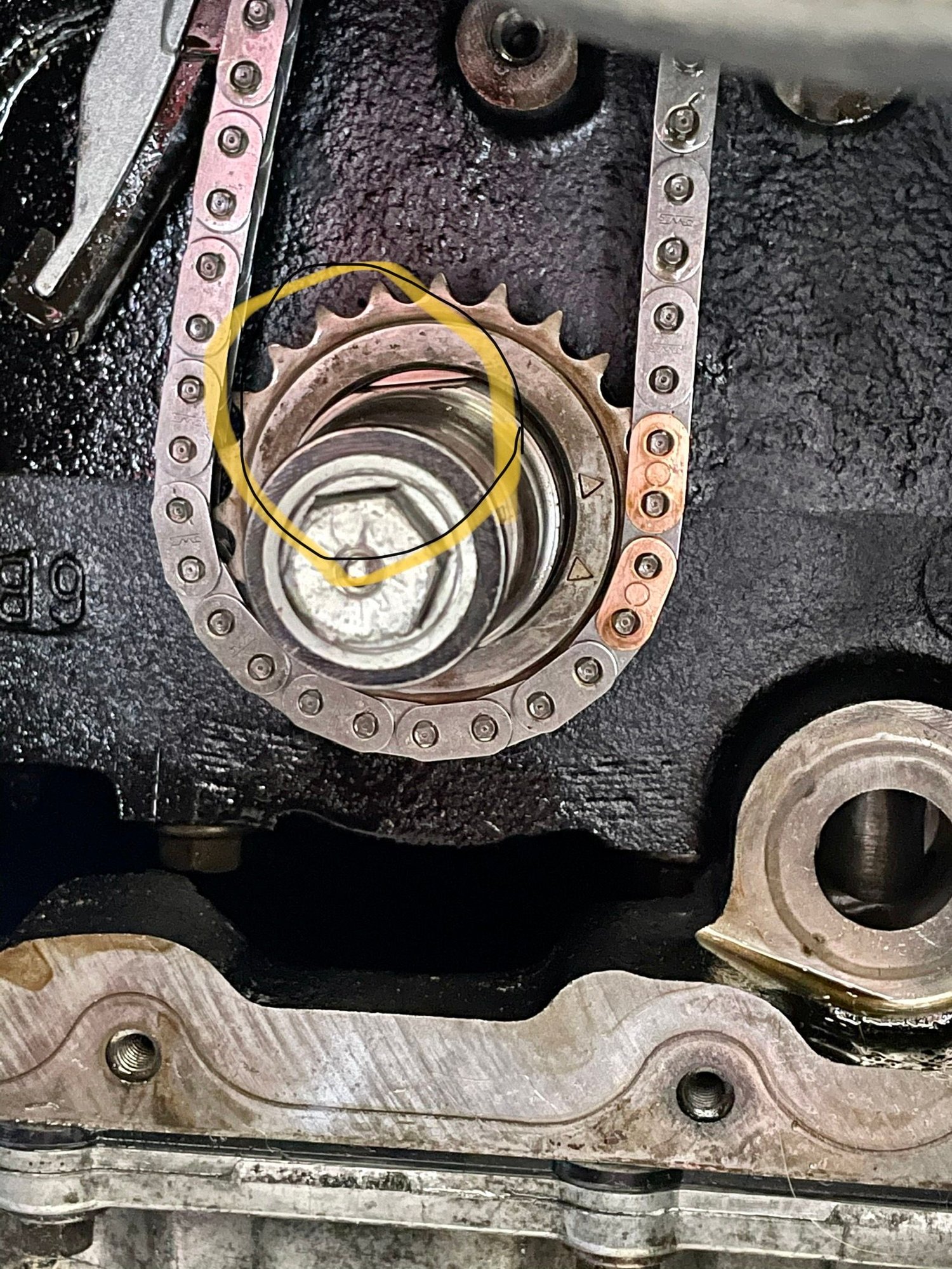

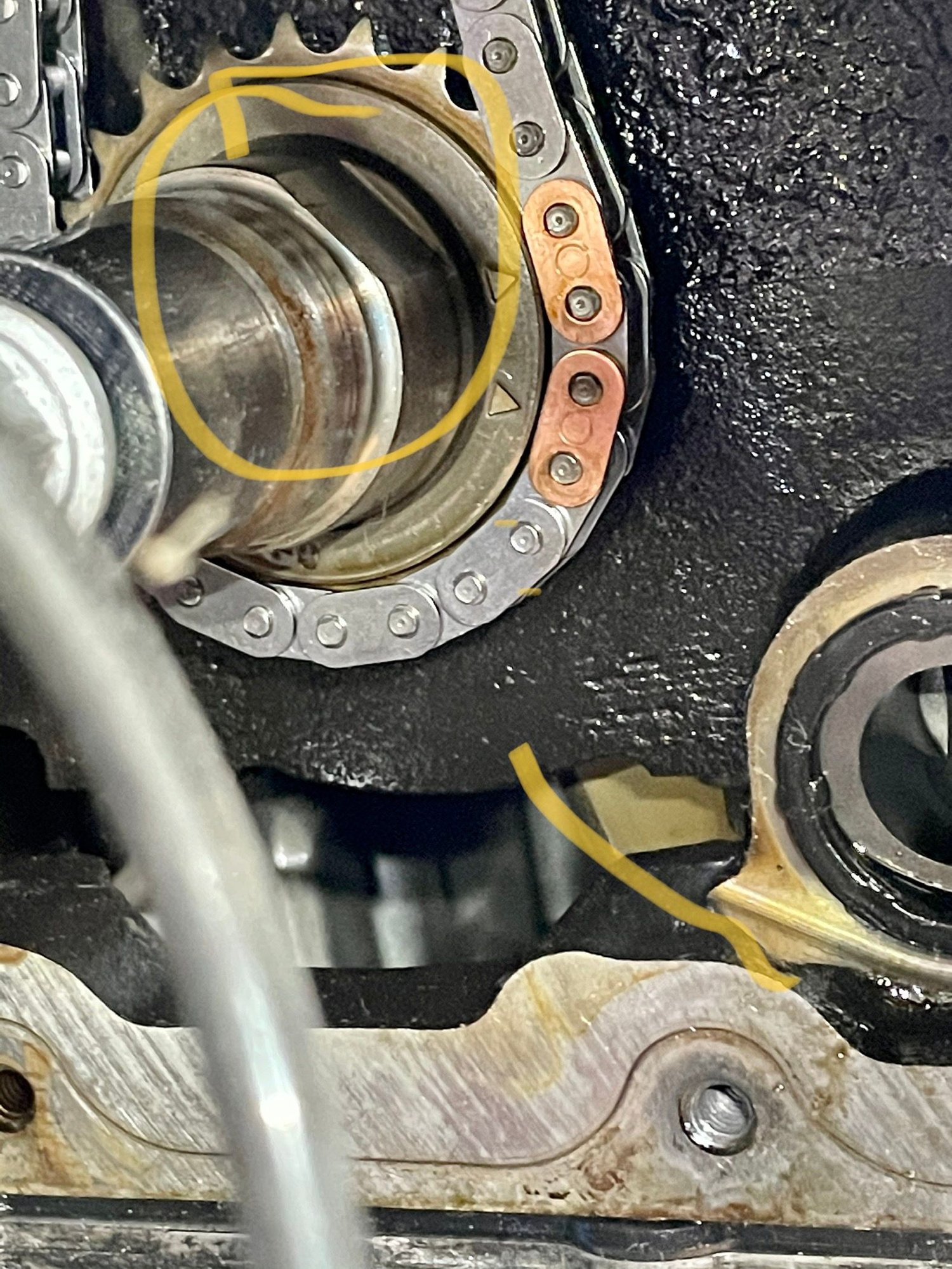

ahh maybe.. I welded the sprocket on today so we’ll see. Amazing how far out of time it was or should I say the sprocket spun. The first picture it the spun and second is how it’s supposed to be. Look at the flats that run the oil pump in relation to the copper links. Big difference!
