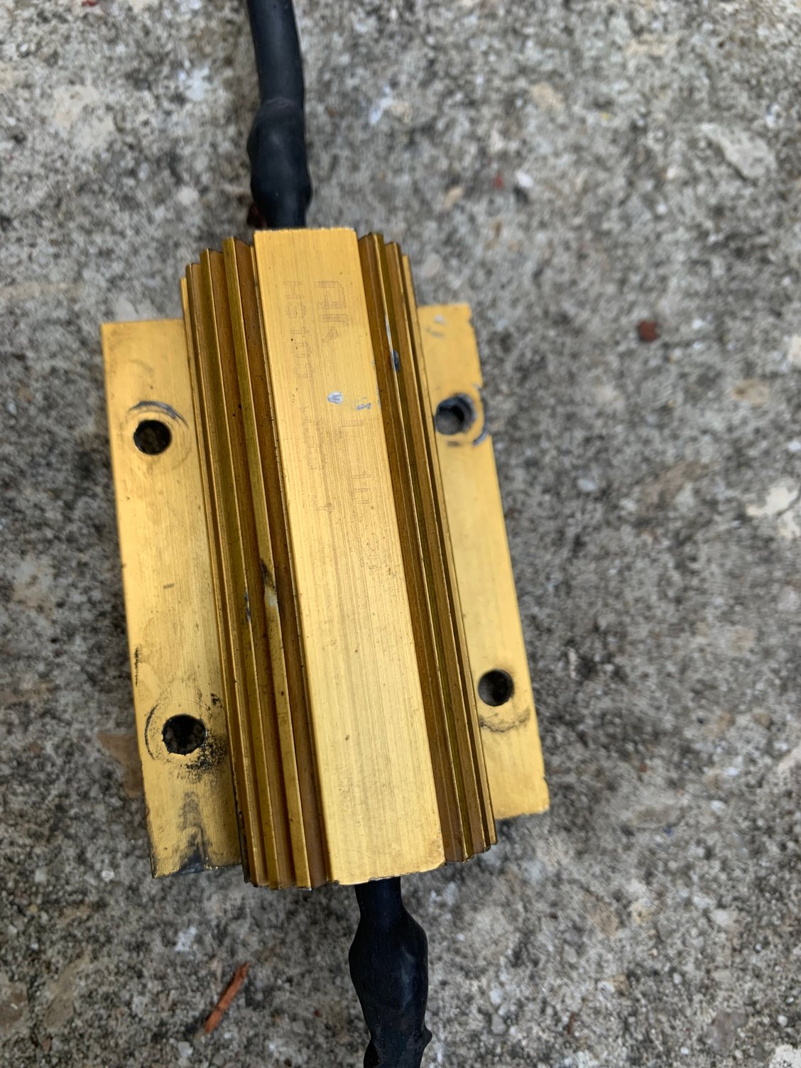

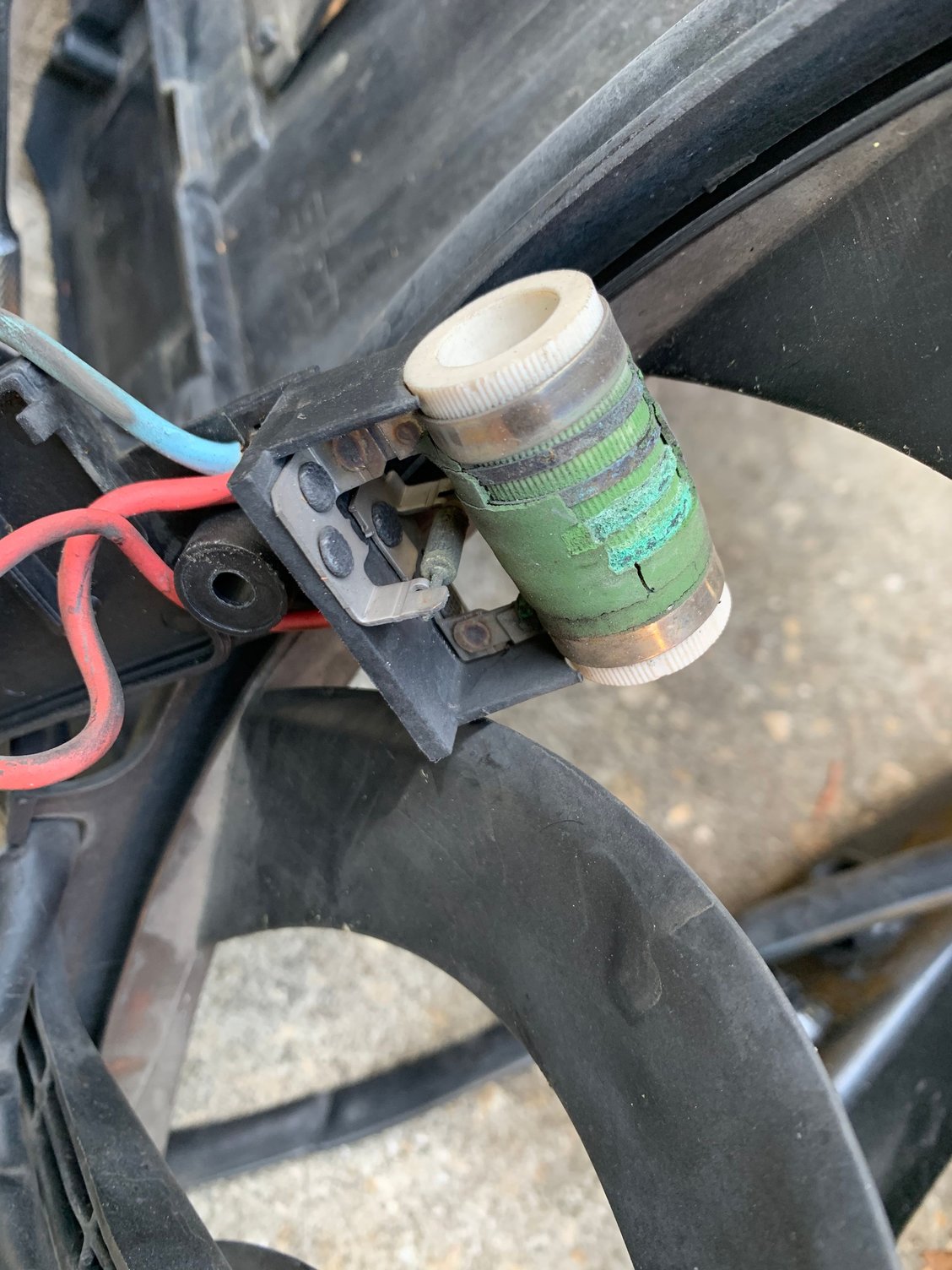

So I found the low speed fan relay was bad, and whomever had this car before and spliced in this relay. When the car was running this guy was scalding hot to touch. Would the low speed fan cause a overheat? I am getting a new fan and relay (package)….the high speed fan works fine (verified by putting 12v to it.

Yes it would. There was another thread in here just recently on the fan relay. I think you found your problem.

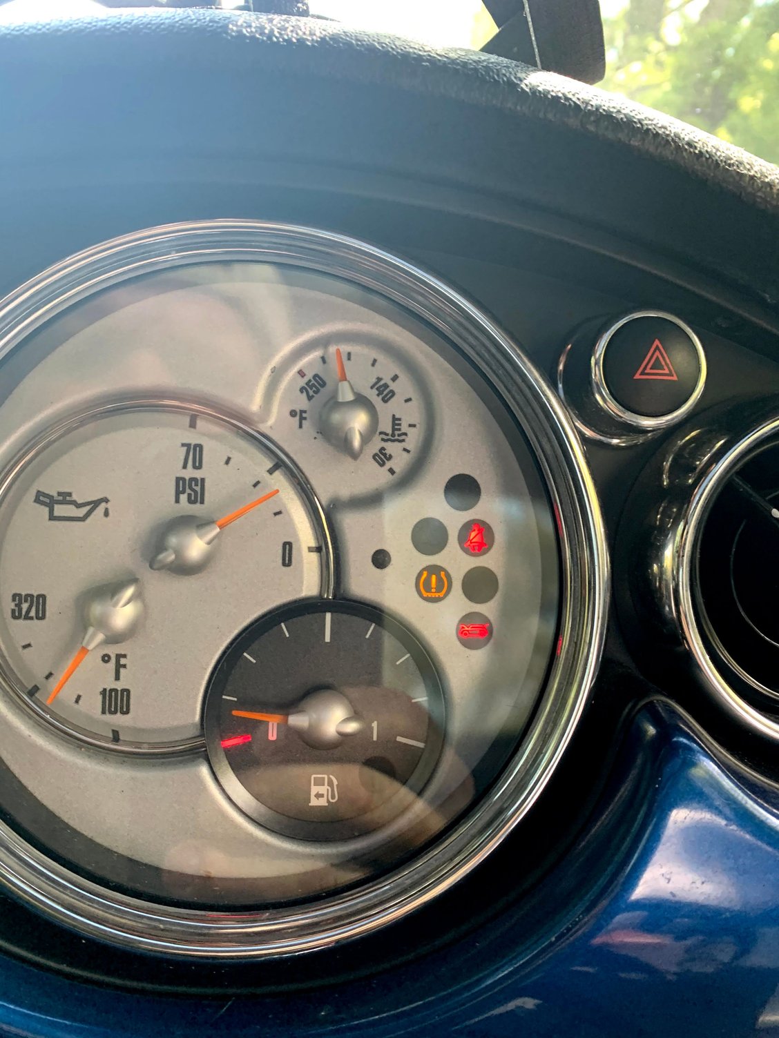

so I replaced the entire fan assembly, filled it and it still ran hot. I definitely heard the low and high speed fans....it never fully overheated, but there was a point where water was backing out of the res tank.........also, when I got it back I opened the bleeder and left it open and nothing but air until I had to shut it off

Minis normally run right at 212F or slightly higher when idling for any length of time. The factory manual warns against extended idling for this very reason. At highway speed, my '04 S runs a fairly constant 164 degrees but can easily heat to near boiling if the fast-food drive-thru is busy.
