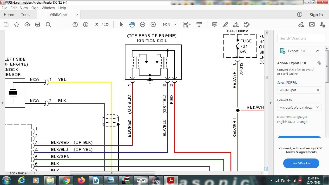

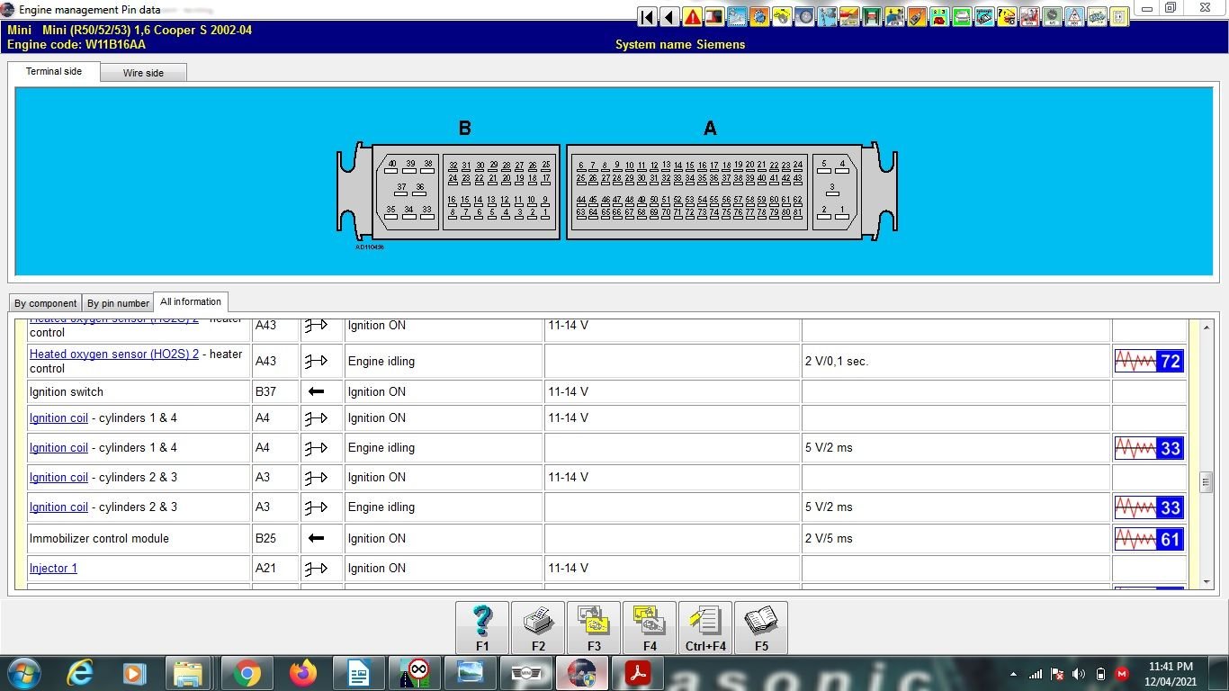

Check the red wire from the coil connector.With ignition On must get plus 12V on pin nr.2
If is OK ,check the wiring between Ingnition coil connector and ECU.
Pin 1 from coil to pin A3 from ECU big connector
Pin 3 from coil to pin A4

I tested all of that and everything checked back ok . Could it be a timing issue maybe the car jumped timing idk . Cause all it’s doing is cranking I get 12v at the red wire and I get 12v at each signal wire for the coilpack when I turn the key
