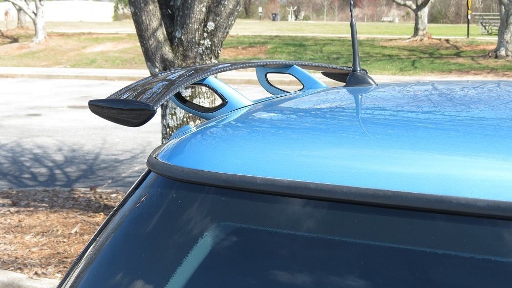

Hi! New here, I have an R53 and just acquired a JCW spoiler. Suggestions for attachment? Heavy duty 3M tape, Windshield sealant? I did a quick search but found nothing.
Thanks in advance!

Do an Amazon search for 3M automotive adhesive trim tape. Many widths and parts descriptions will pop up so you have a lot of options. Or go to any parts store; they have it.

Thanks! I thought 3M Heavy duty would work, the stuff that holds the original wing on is a tape and super strong. Just wanted to make Sure it wasn't going to fly off!! Probably not a lot of downforce going on.

Hi Johnmini, Here is the Mini's official installation doc for the JCW spoiler. I've done the same mod to my 2004 MSC a few years back and it works great. I used the adhesive listed on the doc. I wouldn't use any tape products because over time the the pressure and heat will weaken it.

factory use epoxy to glue it.

The stock spoiler is bolted to the hatch along with the tape. The JCW spoiler will probably fly off with tape only.

Totally in agreement, Do not use tape!!!! The OEM JCW wing spoiler is attached only with adhesive, there is no mechanical screws. That is why they used a strong epoxy to attached it, so it doesn't go anywhere. And yes it is a permanent bond but the wing can be carefully removed with piano wire.

Awesome! Thank you everyone for the replies! I'm ordering the epoxy today, looks like the best route to go. I'll post a photo of it when it's done. Thanks again!!

So the Betalink K2 that is suggested by Mini is no longer available, any suggestions for an alternate adhesive? I see a Betalink 1K available.

Also want to know what glue recommendation to reglue my JCW Wing ? instead of the Betalink

+1 my vote is for OEM betalink, you don't want to loose that rare JCW spoiler

Used by body shops all the time, many different types. Go to autobody tool mart and ask questions, or go to a local body shop and ask questions, they can surely help and it would be local to you. OEM is likely rebranded 3m.

In my former (SFX) industry ; Plexus MA (methalacrylate) was our go to industrial solution where a superior mechanical attachment was necessary but not possible.
Plexus It is not epoxy but mixes like epoxy by ratio via the gun operated dispenser. It's impressively strong!
Sets up fast, toxic smelling as heck / the fumes are overwhelming. Use in well ventilated environment.
