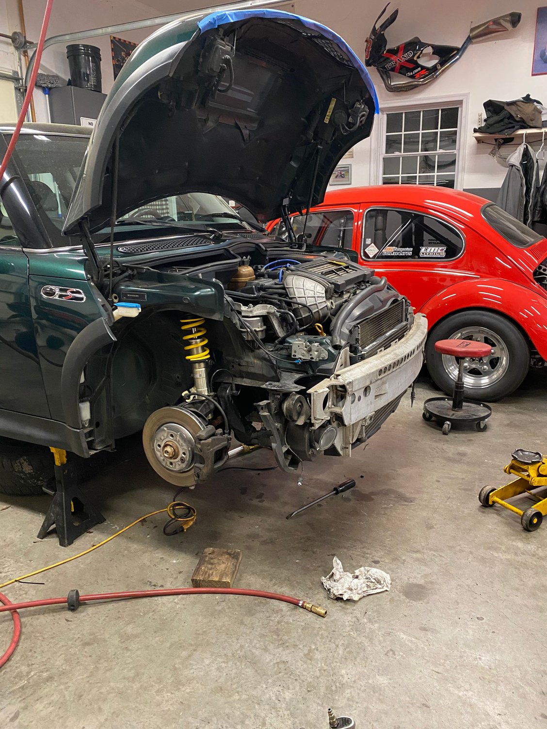

I've had my 05 S for about 4 months now, 113K miles on it. I have done a 15% pulley, and a Hobo style intake and a nice used Invidia cat back. I also fixed a few oil leaks the previous mechanic owner didn't get to. It's not quite oiltight, but its pretty good. I fixed the headliner, but in a way that I'll probably take a second swing at it at some point.
Since I bought the car I agonized over what to do for suspension. I have a thing for lowered vehicles, I have/had several, my daily driver at one point was a 5/7 dropped 93 chevy shortbed (I still have it 20+ years later). compounding the problem is that the car came with 15s, and I'm pretty set to keep them for now..
Every time I would add up the cost of quality struts (koni yellows, swift springs, ireland fixed tophats) I came to the conclusion that coilovers were just a little bit more. but I know I'd be dissapointed in the way the car sat. I always end up playing with this on a variety of cars and motorcycles. I don't want this to be a race car, just a fun commuter, Sundays with my wife in the mountains kinda car.
So in the last week I bought...

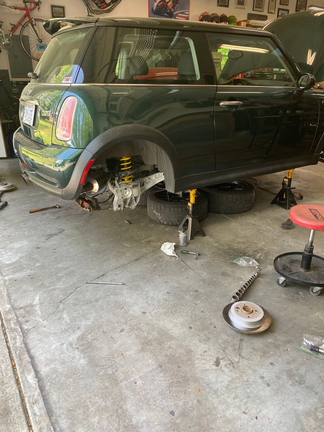

ST XTA coilover set, Lemdorfer inner and outer ball joints and tie rods, Powerflex control arm, sway bar, and steering rack bushings as well as powerflex R56 rear control arm bushings and the shock adapters to go with the control arms I got from the junkyard a couple months back. I also bought the WMW 25 mm hollow rear sway bar. I also bought some parts to make my own rear camber rods, because the cheap ones seemed cheap, and the nice ones seem too expensive for what they are... (I'm a machinist. they'll end up nice.)
I don't like doing stuff halfway, and I figure this setup will serve me for many years to come.
What am I missing?

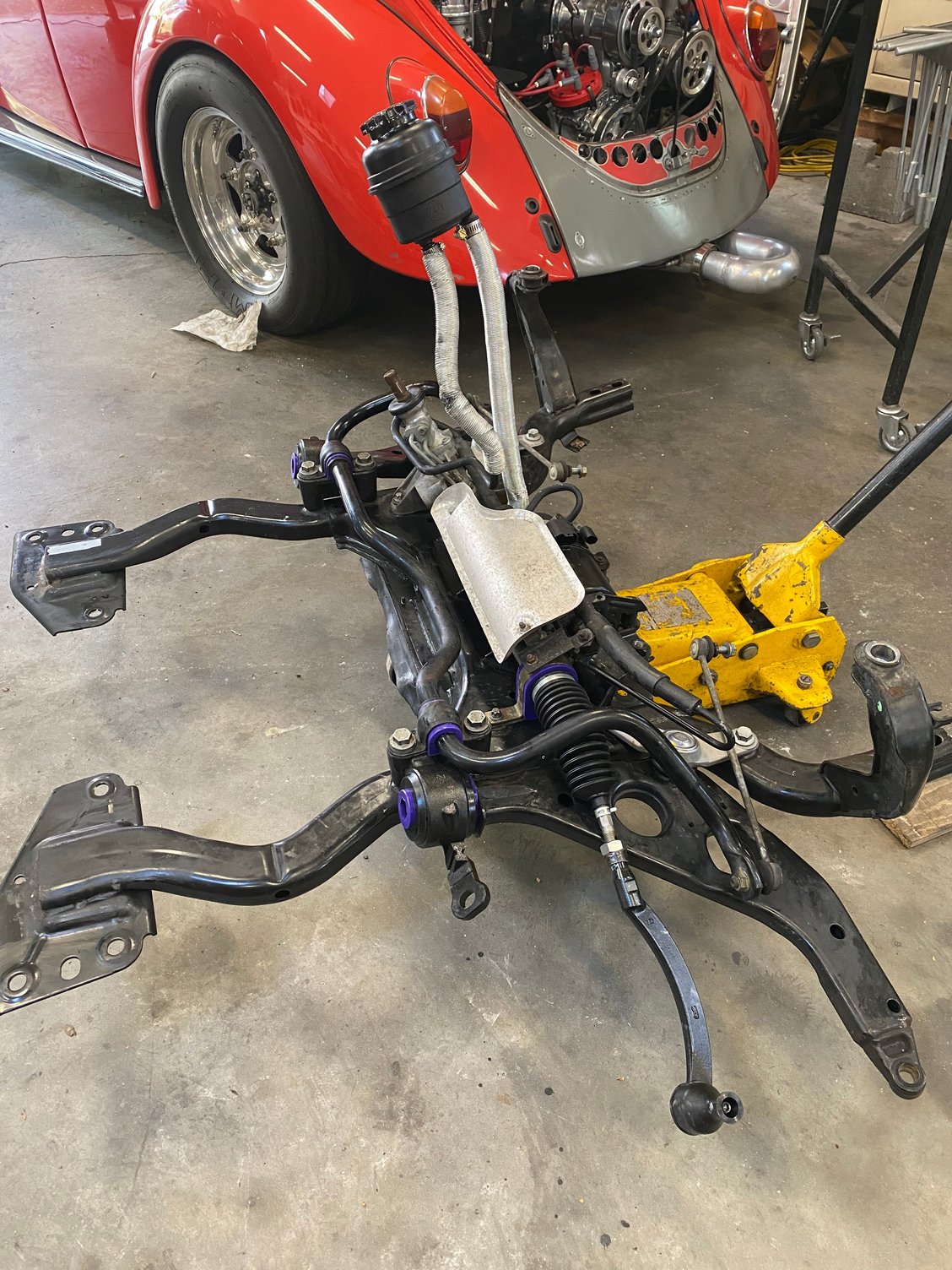

There are multiple online how tos. I followed the pelican one, kinda. It isn’t really difficult, just time consuming. I figure I have 13 hours to redo the front, and not busting my ***.
I did my power steering pump connections with the subframe dropped a couple inches. That’s the tightest job.

Looking good. Few things satisfy like cleaning & reinstalling a gunked-up subframe assembly.

I’m contemplating ways to shorten the rear sway bar end links, possibly by cutting and threading the stock ones.
I “made” my own adjustable lower links from Afco radius rods and bushed rod ends from speedway motors. After reading some complaints about the bushing material I bought a replacement urethane bushing by energy suspension. I wasn’t crazy about how most of the aftermarket rods put the adjuster in the center at the weakest spot when force is applied, and I thought the price was kinda high considering what the part actually was. I considered making my own fixed billet upper arm so I could use the same bushings on the upper arm but decided I was letting my OCD get to me a little
