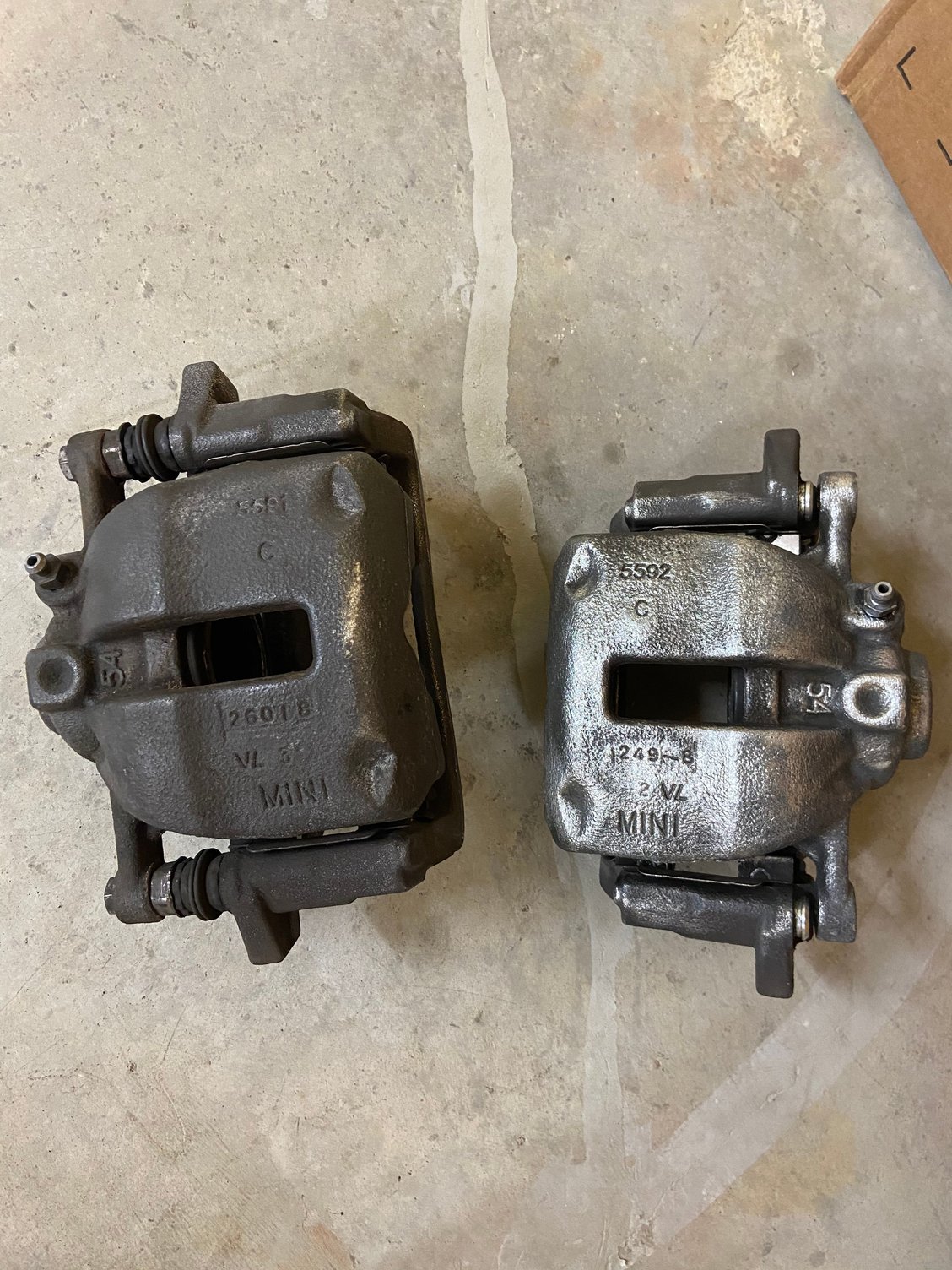

I’m getting ready to install my R56 brake calipers, but I want to paint them red to match the rears (painted by the po of my car) I’m pretty settled on the G2 epoxy paint, but I’m kind of at a standstill when it comes to cleaning the calipers. I’ve been using a drill and wire brush with brake cleaner too and they’re much cleaner than they were, but still no where near sparkling. But I’m not really getting anywhere with the wire brush anymore. I was thinking about using my little belt sander, but I’m not sure if I smooth the surface of the caliper if that’ll affect the adhesion of the paint worse than having some brake dust in the crevices.
anybody have any experience with it? I’ve never painted calipers before. It honestly is a big pain in the butt. I’d really just like to instal them and my new stainless lines and start enjoying the improved braking.

You are on the right track with the drill, wire brush and brake cleaner. I also used a wheel cleaner specifically designed to breakdown brake dust. Prep is the key to making the caliper paint last! Continue to get them as clean as possible. I would not suggest sanding.

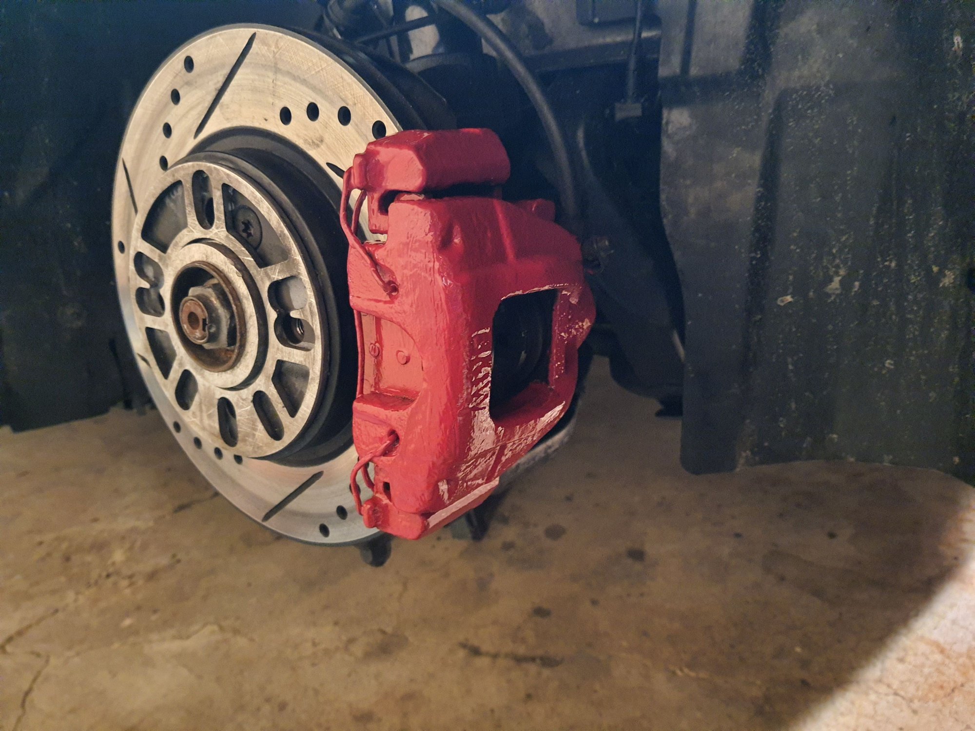

I paint them with rustOleum brush on.. its never chipped or faded on any of my calipers. Heres my lazy touch up I did after grinding my calipers for clearance
the paints so durable you can paint over dirty calipers even. Just spray them with brake cleaner and thats it , though if they're off obv clean them best you can with a wire brush 1st but the paints super durable.

Thanks, that's what I was generally thinking. The G2 is brush on and I'm in the lucky position of having them off the car already, so that helps. I've just been surprised how long it's taking to get them clean. I probably have 3 hours in on the cleaner caliper, and 1 hour spent on the dirtier one. Also gone through 3 cans of brake cleaner so far. I think I may try some wheel cleaner to see if that helps me make any headway, I might also bust out the pressure washer I got for christmas. I'll probably put the sander a way though.

Prep determines the quality. If you want them to be colored, you can do whatever you want. If you want them to look good (like a factory finished, high end caliper), you need, to do, the thorough prep.
​​​​​​When I refinish calipers, I take them down, to bare smooth metal with a die grinder and a 3M Scotchbrite Roloc discs. I take off more, than just surface dirt and corrosion, and am actually polishing the metal, giving a smooth gloss surface for the paint. Then use a high quality spray paint meant for high heat (typically requires curing in an oven).

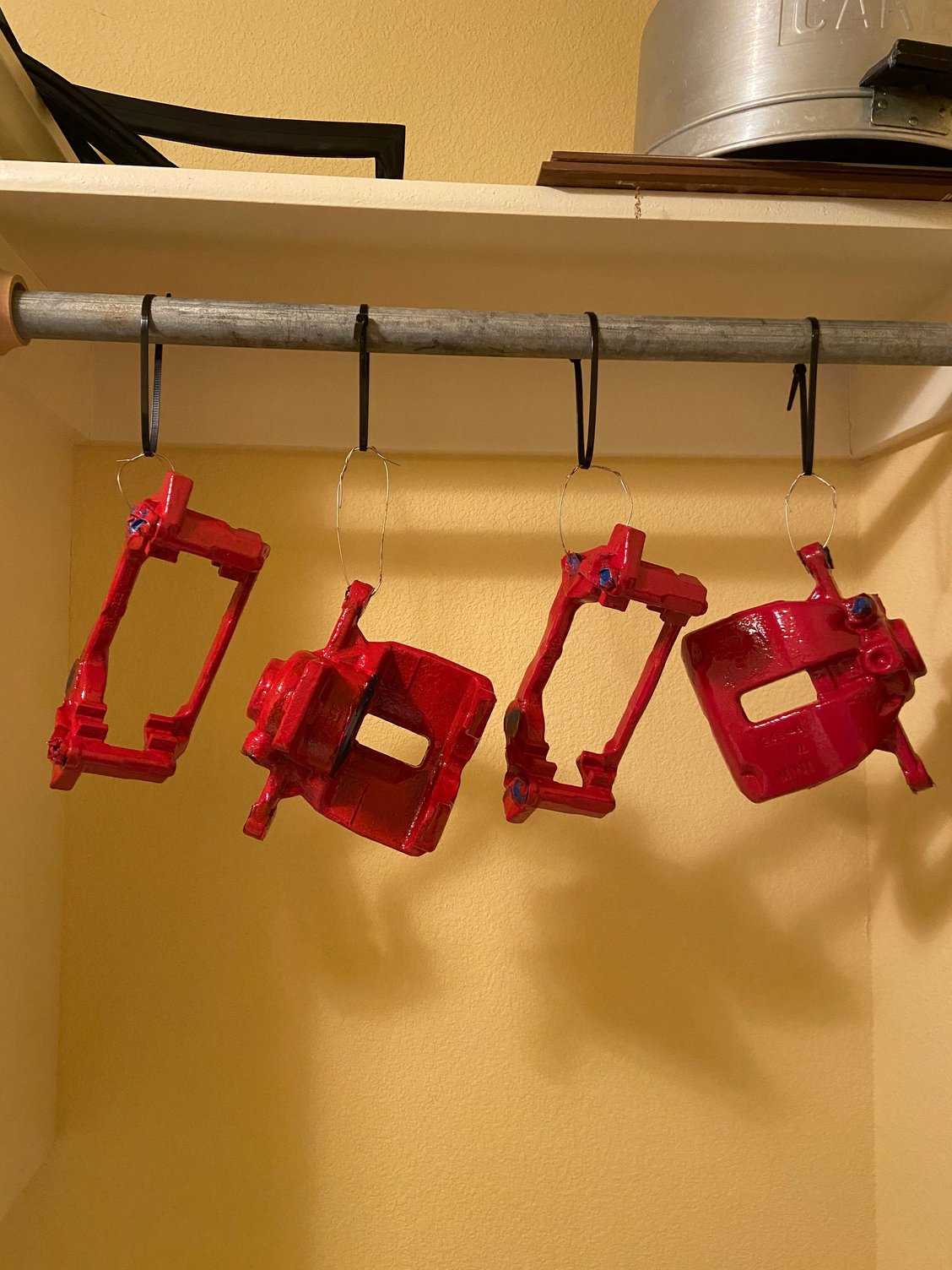

Paint applied! I’m pretty excited about how they’re going to turn out. I’m sure I could have gotten them cleaner, but honestly I was tired of scrubbing them, and thing I got them prepped good enough. I’m pretty impressed with the paint, goes on pretty well, and looks like it’s gonna have a nice glossy finish. Now I just need them to dry so I can put them back together and get them on the car.

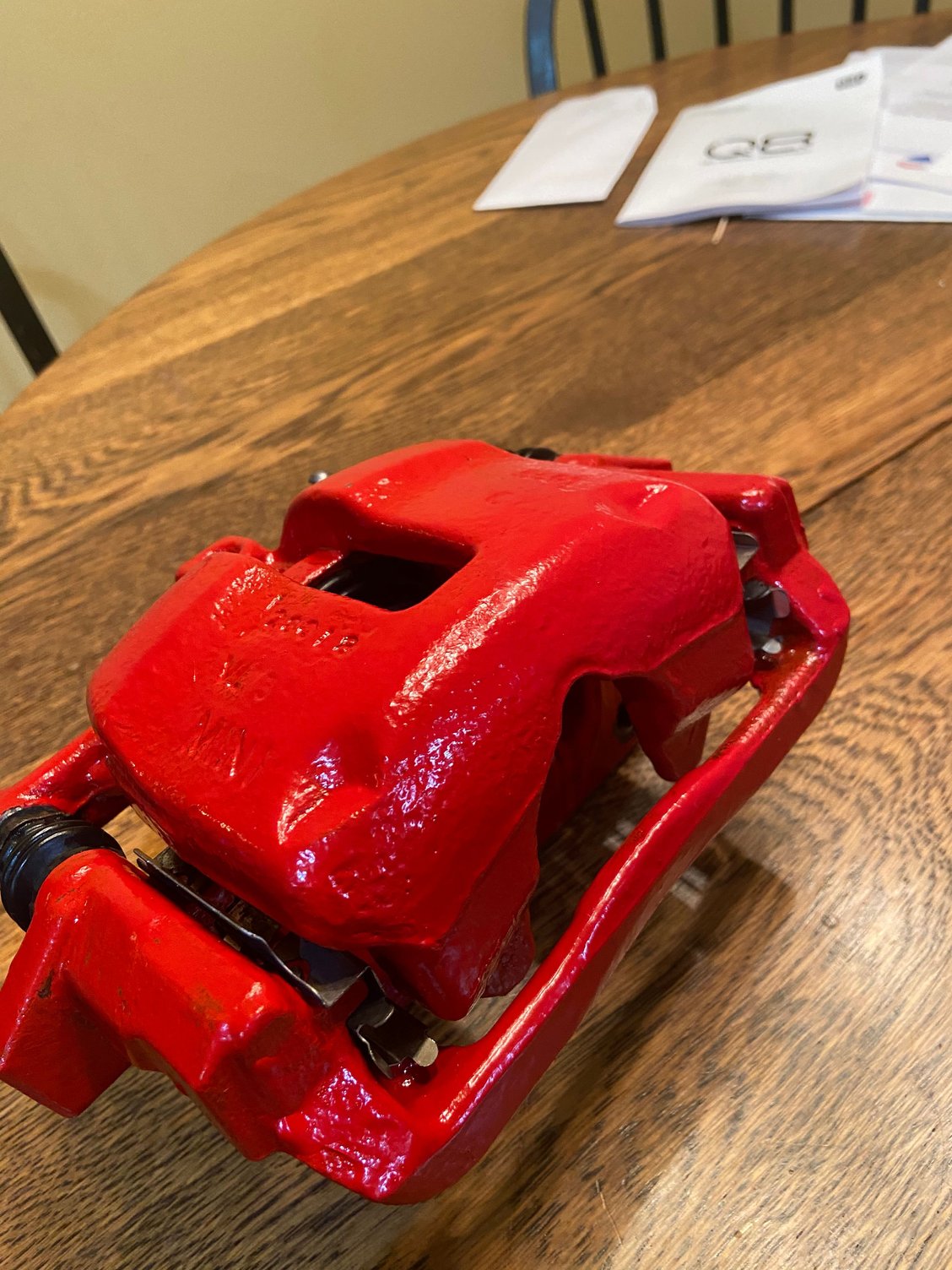

Welp, they're going on the car tomorrow, so this is probably the best they're going to look. I'm very pleased with how they look. I'll be even happier if they work. Before I started working on this upgrade, I'd never disassembled a caliper, and honestly didn't quite understand how they worked, but lots of googling and youtube watching helped me get this done. Thanks everyone for the help.

Here's what I was telling you , all you had to to was spray them once , wire brush them and spray one more time and then paint. I even went rite over the old paint and it evened out very well.. you DONT NEED to meticulously prep them. Trust me ! Pm me anytime and ille send you current pics of my calipers and other than them being dirty , I bet the paint will be just as nice as it is today.
