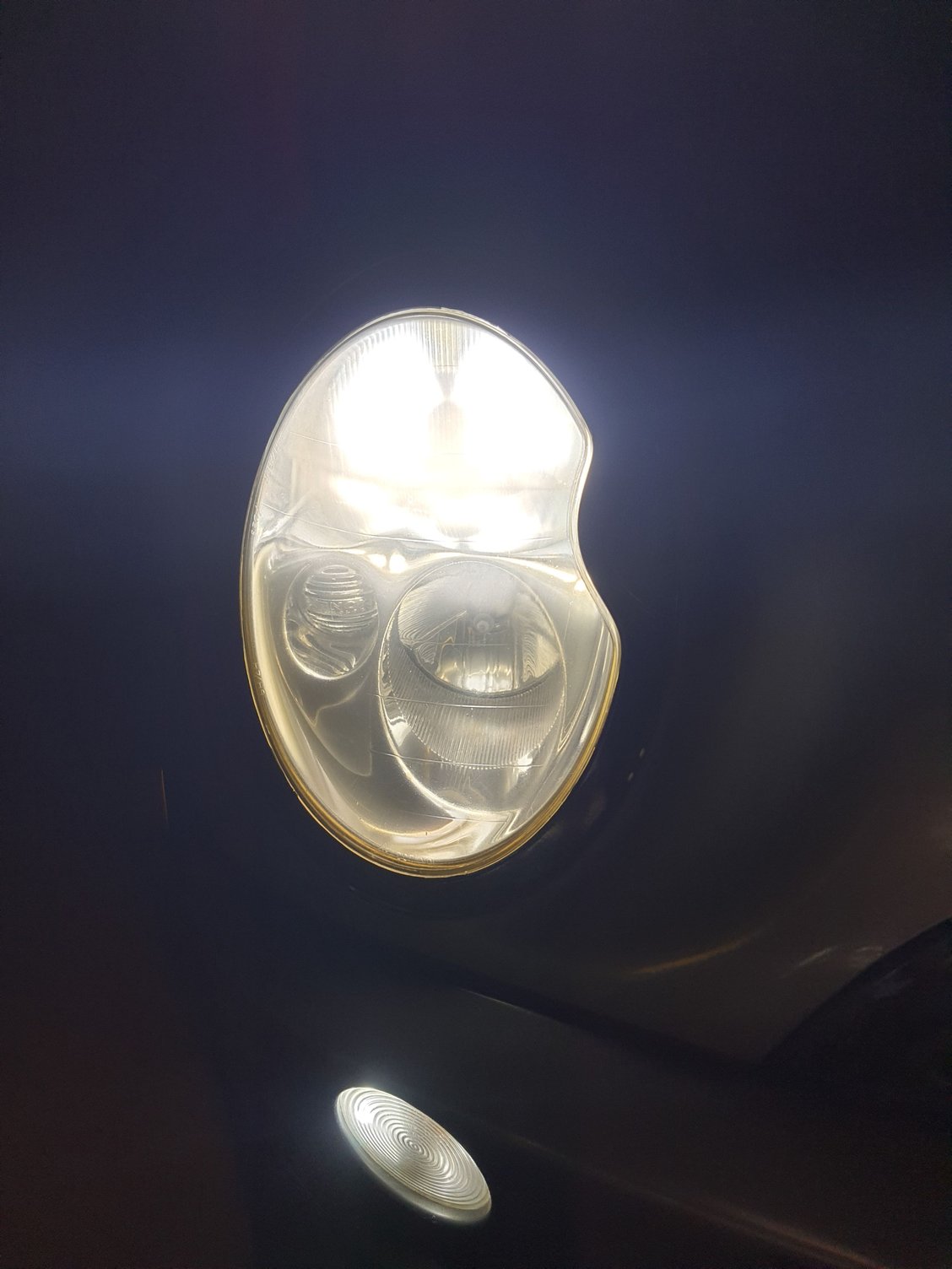

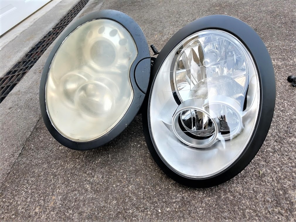

I think the washers are dumb too.
I retro-fitted halogens on my 2006 and had no problems whatsoever with the swap,
an easy straight trade.
https://www.northamericanmotoring.co...ml#post4552265
My xenons were so hazy that the halogens were actually brighter LOL
plus adds a little lightness!

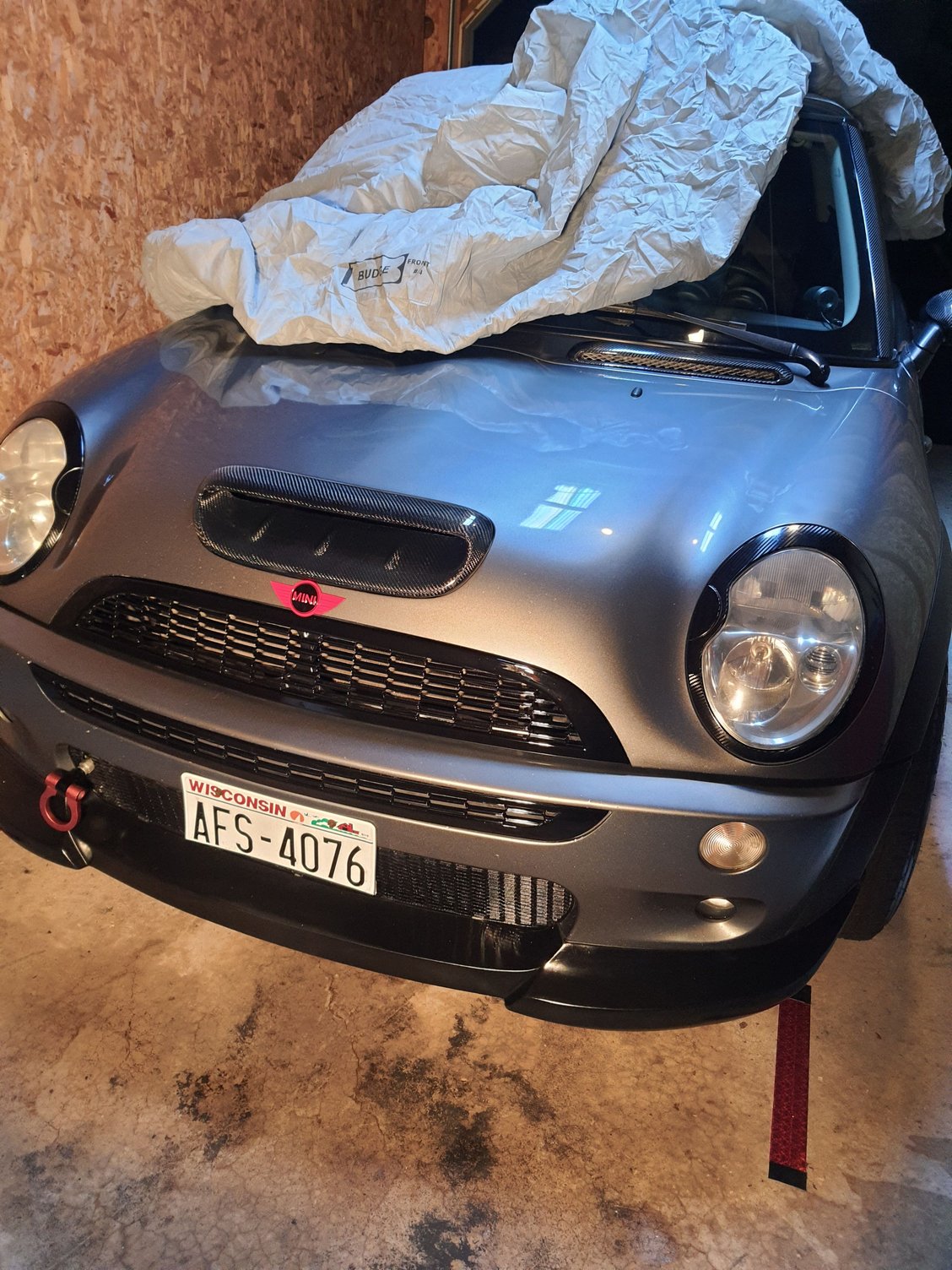

Yup you sure can. I just went from xenon to led on my new Spec D headlights.

I used these light. Just had to wire the halo an blinkers in. Easy to do. Just tie the blinkers into the side makers on the scuttles. The halo i tied into ignition sense. Ran wire to a relay. Then ran power an ground to relay. After that I tied the halos into the relay. Headlights themselves are plug an play.
I had xenon. I just did not like them. Plus the wires are toast. So these worked out great. As far as bulbs go. I used a led lite set..
So that I would not have issues with flickering with led lights an canbus on my mini. I used these.
