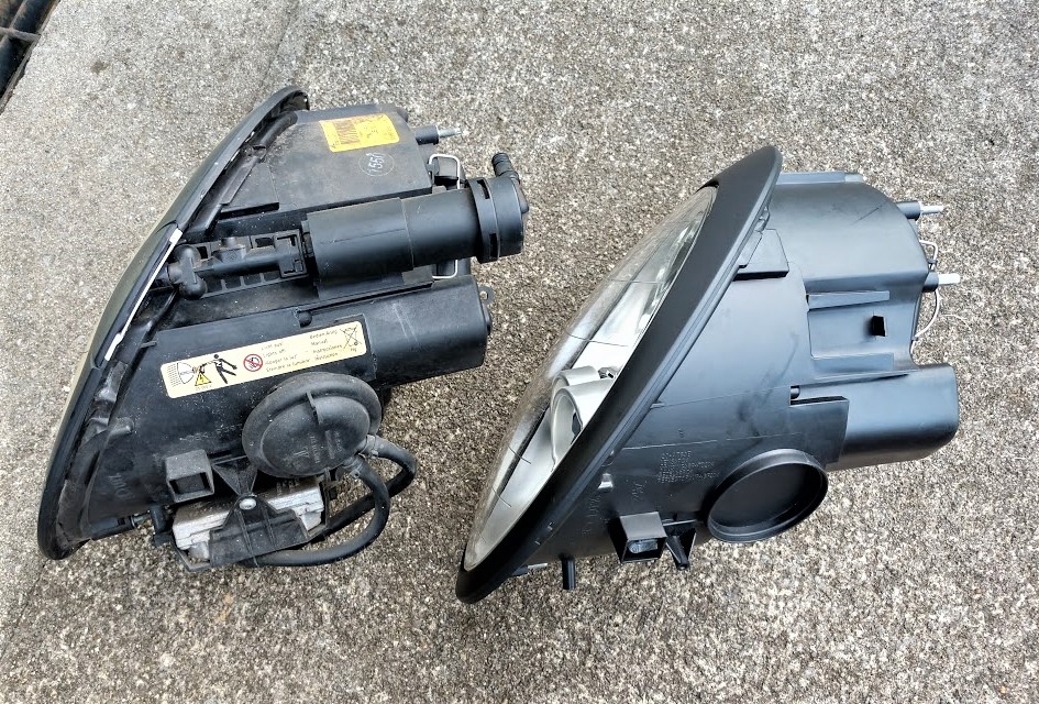

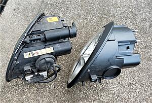

I've been wanting to do this for a while and now finally getting round to it.
For me it was more an aesthetic choice because I like the look of halogen better , even though it may sacrifice brightness at night I rarely drive at night anyway but I'm curious to see the difference when I do, probably I'll test drive tonight and find out.
What bothers me about xenon you ask?
Goofy cross-eyed squirters and the techno-robo lasergun look clashes with retro styling.
Perhaps I am luddite, or shallow, or both! LOL
Weight savings is minimal I'd reckon, but weight is weight and I guess it depends on how much Colin Chapman you got in your blood or whatever as to concern every ounce counting...
...like how the GP went with halogen as opposed to xenon when they were doing the weight-watcher rundown.
But in reality it ain't really much --- I don't have a nice scale, but simple analog bathroom scale puts the difference at around 2.5 or 3lbs each, so around 5 or 6lbs total.

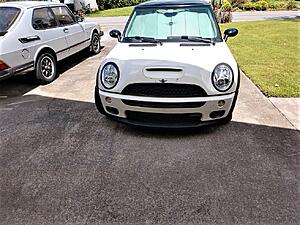

Done.
Very simple plug 'n play.
The most time consuming aspect is getting the washer hoses out,
otherwise just 3 easy bolts per side.
Will test drive later this evening to evaluate dimness difference, but as it stands right now I'm stoked because I dig the look.

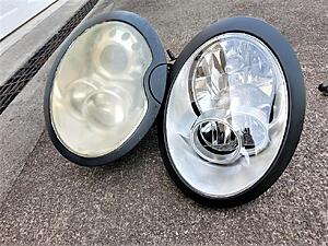

I painted them with SEM Trim Black 39143.
Curious to see how they hold up, may end up vinyl wrapping in the long run if they chip too easily with the paint.
