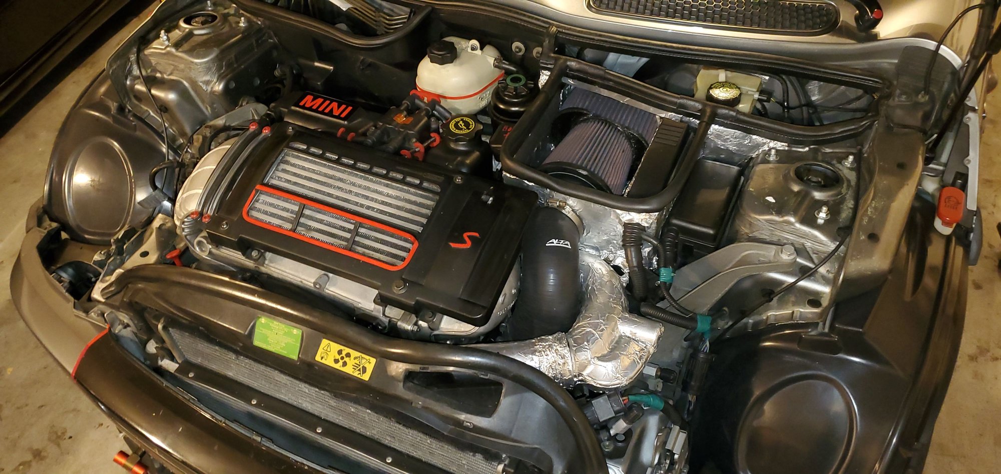

Hey there my name is Douglass Enriquez. I am a 40 year old Pipe welder and father of 3 boys... Ive only had 1 car see 1 mechanic shop 1 time in all my years, but IN NO WAY do i think I know every thing. FOR FROM IT AS A MATTER OF FACT.... My point is that i know my way around a car OK but every one can use a hand from time to time. I now own a 2005 Mini Cooper S r53 and An 04 E55 AMG Mercedes W211 and have done well thus far maintaining them.
That being said, I'm honestly starting to thinking my name should probably be, bad luck Chuck. LOL
A few weeks ago the fan resistor switch went out on my Mini Cooper S ( or so I thought ). The Cooling fan on the radiator stopped working as well as the AC compressor.
After that I Started to notice the stereo sounding odd, a sort of a distorted sound through the speakers a light ground loop sound, and no sound through the mids in the doors, tweeters worked fine. At the time I was working 10 hours a day 6 days a week with a 2 hour drive on each side of work daily! SO just no time to look into it. Shortly thereafter my heater core went out on my way to work. I got it back home after it had leaked a ton of water into the floorboard of the car ( from stopping and putting water in radiator repetitively on my way home ) not really thinking about the fact that it was all going into the carpet, it was a long week. Went through the process of changing out the heater core and resistor switch on the cooling fan. AGAIN not thinking about the fact that the car had gallons of water in the floor, it was still jacked up when i started It, everything was fine the next day I went to start it and now NO POWER to the interment cluster. I mean the interior lights come on and the dash lights Illuminate but NONE of the warning lights come on when its turned to the 2nd position like it normally would....! I immediately started to try and figure out what was up...... unhooked the battery made sure it was fully changed and it was, so i hooked it back up and still nothing, No sound from the fuel pump no ticking from any relays ONLY parking lights, interior lights and radio come on and along with that when the car is completey off ( no key in the ignition ) the radio still comes on and the PASSENGER side parking lights are on as long as the battery is hooked up. EVEN when there is NO KEY in the ignition! which I know it did not do before. Could anybody please help me with this situation?
So: 1 Cooling fan resistor switch went out ( stereo started acting funny around that time )
2 heater core busted ( water in the floor. GALLONS OF WATER )
3 No power to anything except the interior lights and dash light. Can't hear fuel pumps come on no head lights, no wipers, ⁶
no power to anything.
4 except the stereo which now plays with out a key In the ignition
For all the Grammer police out there, I'm fully aware that my spelling is terrible, along with my punctuation. so I greatly apologize if you have a hard time understanding my point, due to a lack of sentence familiarity. Im a 40 year old father of 3 and a pipe welder with ADD, dyslexia, among other literacy related problems so thank you for your patience......
Really Im just hoping somebody else may have already been through this and be able to point me in the right direction..... Id really hate for this my beloved Mini Cooper S R53 to be a total loss..... PLEASE HELP ME!!!
