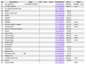

The JCW rear partition....Part no. 51-71-7-174-999
As for the body of the air box, the only time a MINI client received both a new bottom and top was when they purchased the 205hp kit which came with the 380 injectors...Otherwise the bottoms are the same.
What you can do is what's called a "flapper delete" too. Basically is when you remove the large rear flap in the back and disable the vac system and line going to the module which would normally open the large rear flap at 3,800rpm's.
If your purchase came with a "foam filter" that's not standard filter but aftermarket. Alta makes a foam one as does Pipercross...These require special cleaning kits/solution meant specifically for foam filters. They also require oil to be sprayed onto the foam to act as a medium for trapping dirt particles. IMO the foam filters do not trap dirt as well as the paper filters....that said, I have a paper stock OEM JCW filter...but when I do replace it....I'm looking at a better flowing but DRY paper filter from Amsoil.... https://www.ecstuning.com/b-amsoil-p...r/eaau3570~ao/
And while the lower portion of the box may be the same, I believe there may be two parts absent possibly from yours ? # 18 and 19 below. ( been a while since I swapped mine out ) But you can assess that once you have eyes back there. And yes you can remove that lower plug as well. It adds more ambiance to the driving pleasure but it also reduces air box pressures resulting in torque / power reduction. Why the JCW MINI flapper gizmo didn't open until 3,800 rpms when it was wired up.

I am indeed missing #18 and 19 from the picture above. Do they represent an inlet to the plastic shroud or is that a cap of some sort?

Here is the # key to the diagram that Eurothrasher posted:

If I remember correctly, the JCW includes a T fitting to tap into the vacuum system and nothing is touched from stock if the flap controls are not connected. I just removed the flap and all of its components, including #10 and #11 before installing the JCW top half to the stock bottom. If you remove #10 it will leave a hole in the top that you’ll need to seal. You can leave it on, but I just liked the cleaner look of not having it there.
Also, if you go with an aftermarket cone filter try and use #3, the air cleaner element stop, to help secure the filter in the box so it’s not just hanging from the intake. Just an extra precaution to help keep the cone filter from shaking loose over time and having the engine suck in unfiltered air. The Amsoil has a nice metal end plate the stop can stick to.
#18 should already be part of the bottom half of the stock airbox with #19 not really being needed. I’ve read one reason for the flap on the JCW box was for noise laws in the UK/Europe. Most people wouldn’t be driving over 4,500 RPM’s around town too often so the flap would be closed and keep the supercharger whine down. #19 just closes off the existing stock opening for this purpose and isn’t needed if you don’t want hook up the flap. Since you’re missing #18, you can get a replacement or cap off the bottom hole on the airbox and the firewall panel with some plugs.
