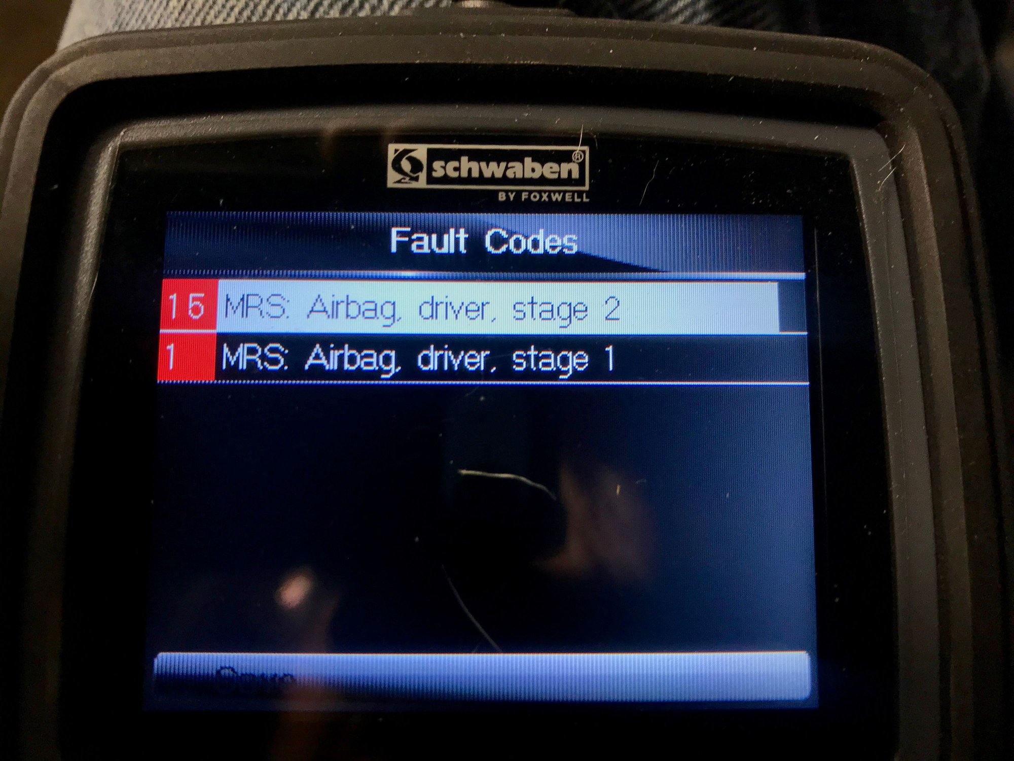

Getting around to tackling this issue. After the build and a week or so with no issue the Airbag light came on. The codes indicate it's the drivers side.
I tried to clear it with the Schwaben Scanner but couldn't. It's reported this scanner will clear the code unless there is actually an issue.
To be honest I'm not sure that I'm trying to clear the code in the correct manner, or if I really have an issue. I'm going to try to clear it again.

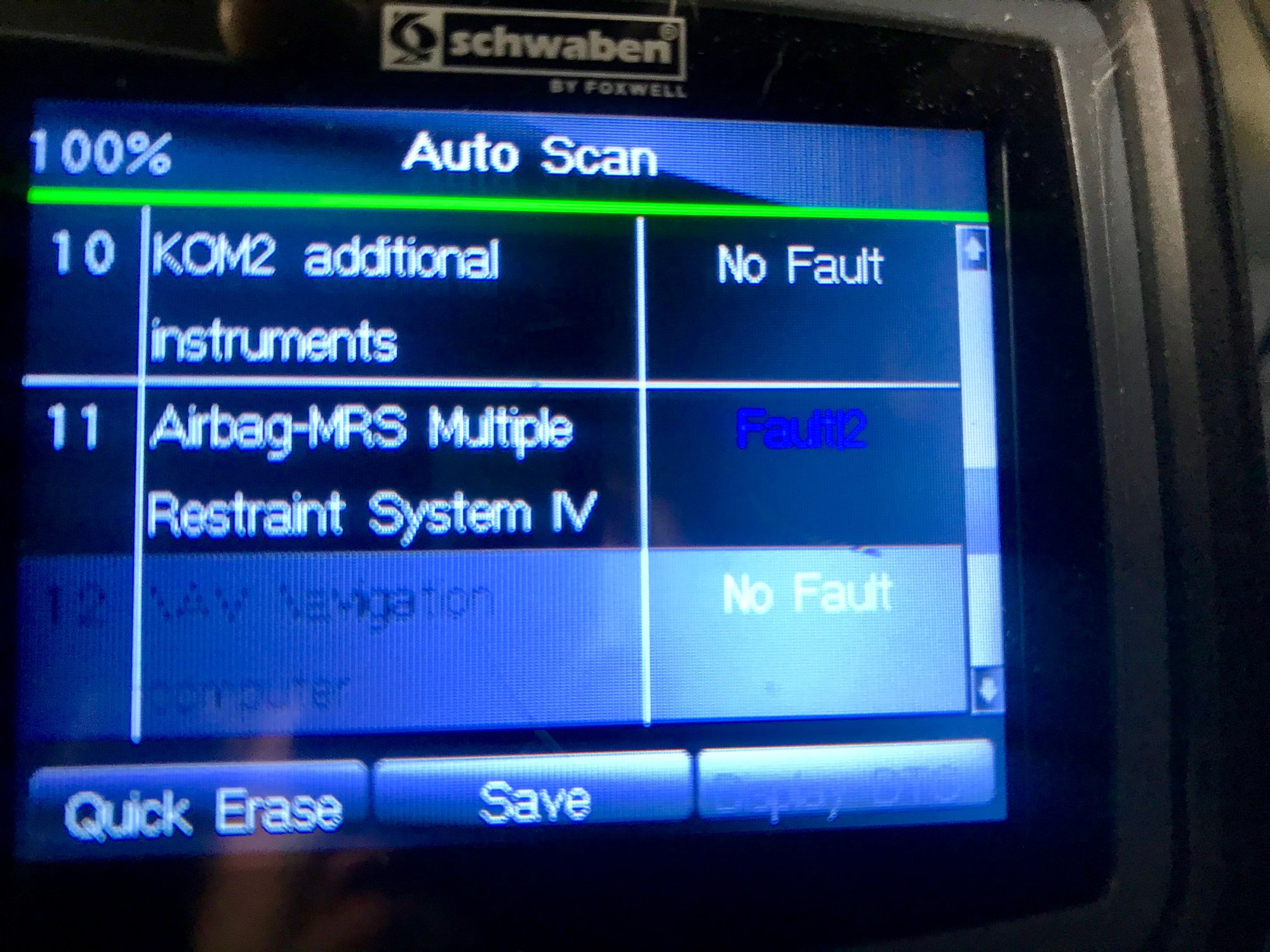

Originally Posted by ssoliman
Do you know where the fault is? The code should tell you
use inpa to find the code / fault
SS,
I'm a pretty good mechanic but I'm such a novice where this stuff is concerned I don't even know what questions to ask, including what inpa is.
I ran a scan and this is what showed up. [here's how dumb I am] Are these the codes and if so, how do you figure out what they mean?
Again I apologize for my ignorance.
rob
And this.
Obviously this is telling me something. How do I figure out what?
Thanks so much for any assistance,
rob

Originally Posted by robj
SS,
rob
And this.
rob
yes sir. Not familiar with that scanner. Many times there is a number code very specific to the cause. The documentation on the scanner might be a good first check. I wish I could help more with that.
inpa is the bmw diagnostic scanning software. Runs on a windows laptop and uses an obd cable to the USB port. if you manage to get it installed it will be worth your time...you’re doing a lot of work with this car...
the airbags can be disconnected if the battery is disconnected and no airbag light will be triggered. If the batt. is connected you will get a light and have to reset...with inpa or other capable scanner.
id want to know where the fault was before chasing this...and it’s a bit strange to get many failures at ones, no? Unless it’s the module or a common component...

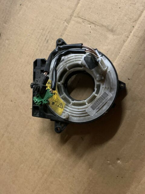

My codes seem to indicate drivers side. I've read where on some models the wire to the clock spring is too short allowing it to become disconnected although with the way the connectors all are I''m not sure how that can happen.
Is there a method to test the clock spring once it's removed?

42,
Yes, I did. Posted it on the build thread but forgot to add a link here.
It was the clock spring which was damaged from allowing the wheel to spin free when disconnected from the steering rack when the sub-frame was removed. Best to center the wheel and leave it locked. Live and learn.
When I replaced the clock spring the airbag light didn't go out right away but after driving for a day or so it went out. Later learned the computer doesn't believe it's fixed until it's started and stopped a few times and it doesn't see a fault. Then it believes you actually fixed it.
[photos etc.. of clock spring replacement on my Bargain $500 Mini thread]
