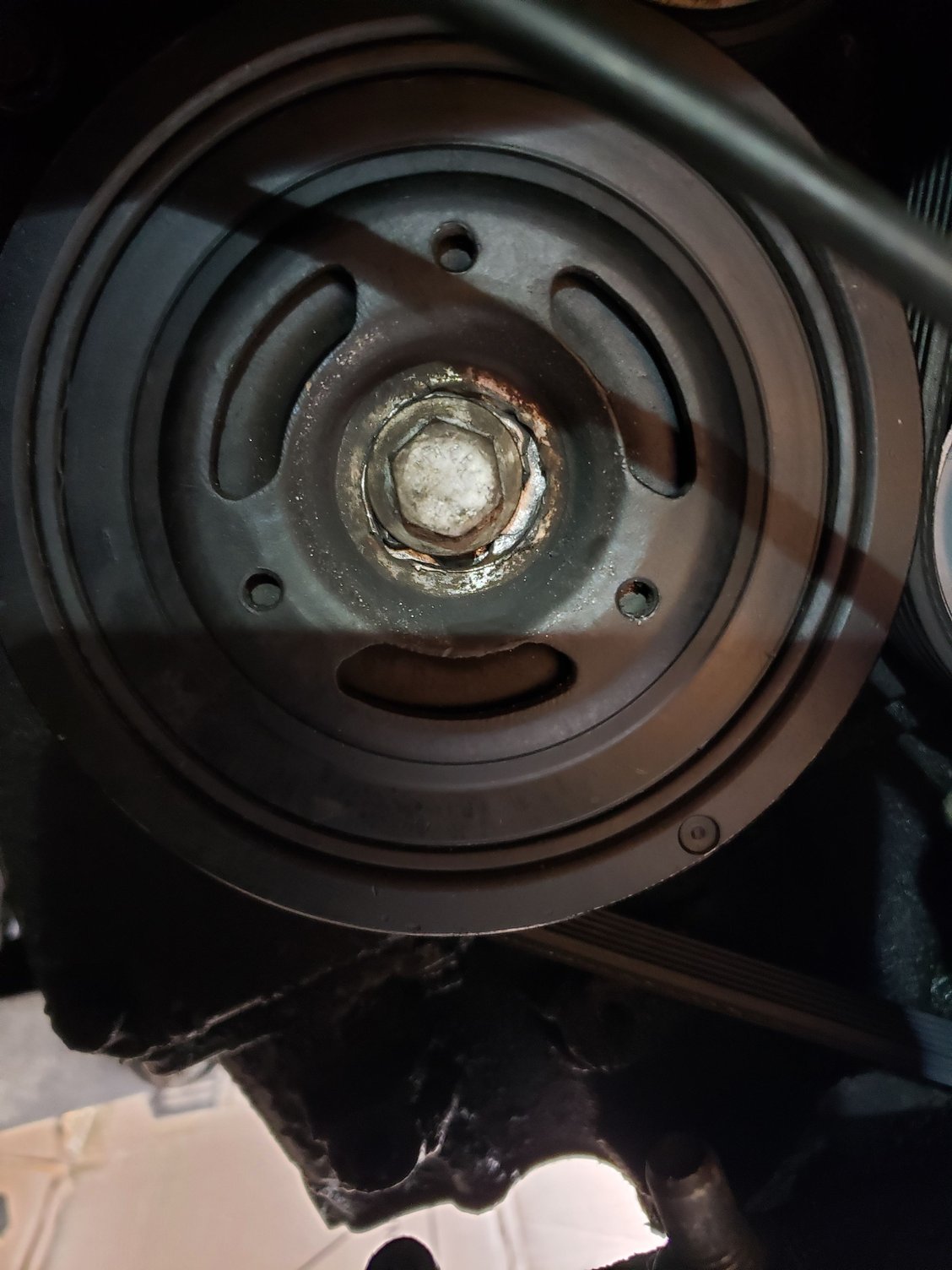

Possibly a bad crank pulley ?
I was loosing boost and had a terrible noise . I tightened my alta tensioner and the car now makes more boost than it ever has, it went from 11psi to 15psi. But I hear a rattle kinda noise at idle and when I shift gears and the rpms drop. You can hear it as the engine shuts off clearly in the video I uploaded . I also looked at the crank and as you see in the pic it has that gap where it looks like its worn on the inside around the bolt i could also wiggle it alittle and there was some play in it which I assume isn't normal would I be correct in assuming I need a new crank pulley/dampener ?

For sure replace that crank pulley. Just looking at the picture the rubber and outer ring there is a big gap between the two. On a normal stock pulley that rubber is flat and very tight against the metal without a gap. But then you seen whatever is going on behind that crank bolt like i'ts cracked or something. Don't bother anymore, just replace it.
Go with the ATI damper as it is better than stock, and more reliable. I have them in stock so if you order ASAP I can get it shipped today to get you back on the road asap.

it has that gap where it looks like its worn on the inside around the bolt i could also wiggle it a little and there was some play in it
100% toast. When you pull it you'll find that it neatly separates into two halves, like an English muffin.
Dang, 350$$$.
The good news is you'll only have to do it once and never think about it again. Be careful ordering - believe both PRW and ATI offer standard and oversized crank pulley options.
anything else I should address while I'm in that area ???
Belt tensioner if it's bad, at least the strut if the bushings are looking sketchy or rotting out. Front crank seal if it's leaking. Some people replace it even if it isn't. Mod MINI changes it in the same video.

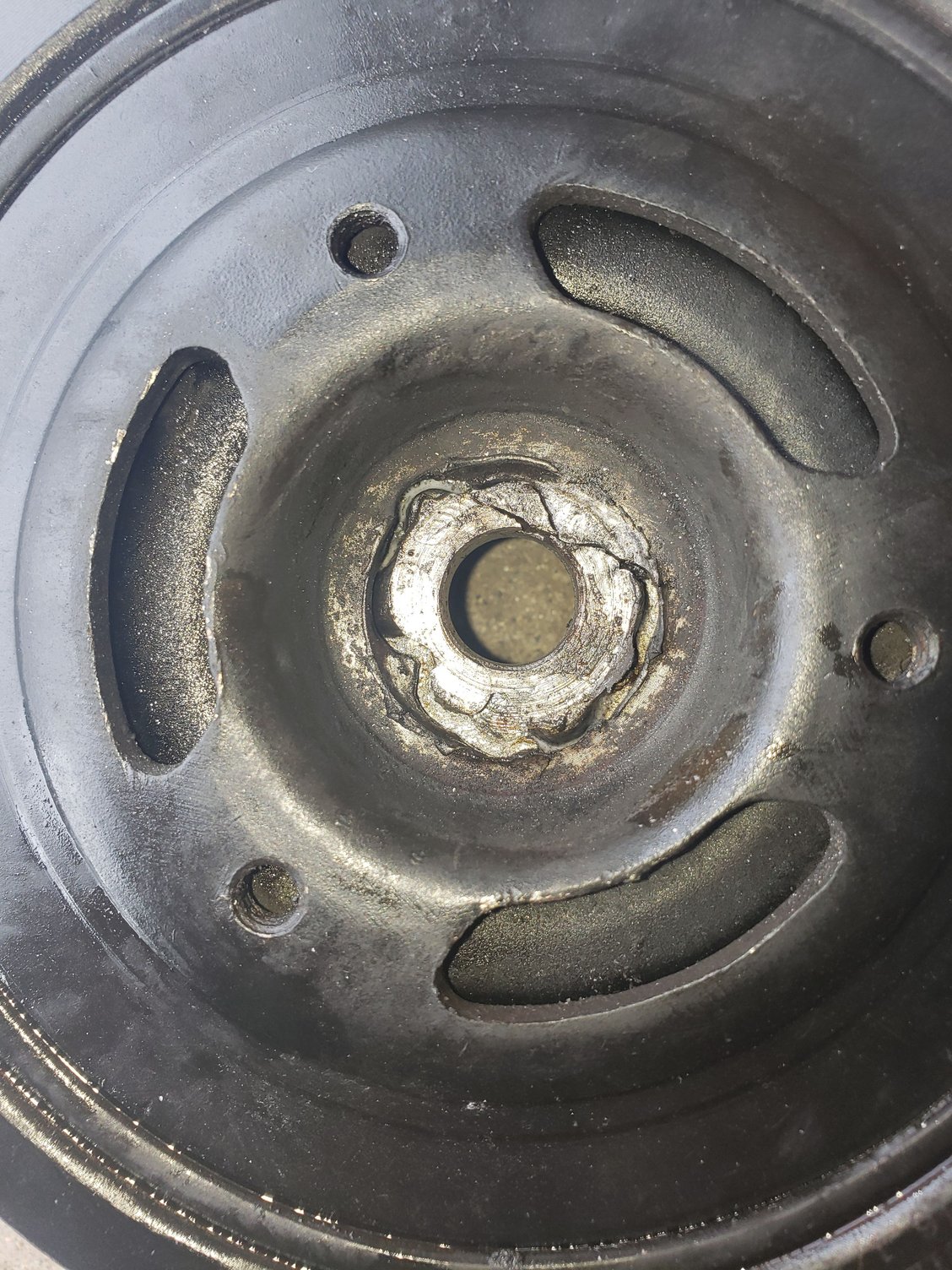

Could the crank snount be bad? It sure looks like it .
I'm going to autozone soon and renting the belt puller and pulley puller so that's gonna help save a few $$$..

From those pics it clearly looks like it's getting worse by the crank bolt. Likely the 3 welds that weld the center to the metal the rubber is bonded to is likely coming apart. For sure want to replace ASAP or stop driving cause it will leave you stranded or worse shred the belt and damage an alternator or axle boot.
If you are going to go with an OEM pulley make sure you get it from someone that will honor the warranty, we have found the new OEM ones just don't last as we have had customers only get 6 months out of them before they came apart too. So we will no longer install an OEM in the shop will will ONLY do the ATI or not do the job.

Success. Got the old one off easily with an air impact gun . I also went to home depot and found a little longer bolt to be able to pull the new pulley on. Im going to pick it up monday.
I will heat up the pulley too before I attempt to press it on.
lol I even rented a pulley puller but didn't even need it as I seen pulling the pulley off is the hardest part . Mine literally just slid rite off thx to it being all cracked and broke where it attaches to the snout .

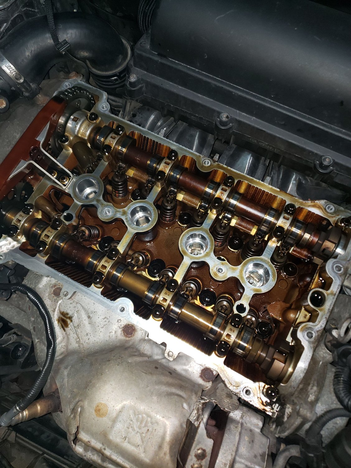

Then me n my buddy got done and went and inspected his timing chain and put a new valve cover gasket on.

Problem fixed , very easy job .
omg...its been bad from the day I got the car. Theres no belt squeal now that I thought was the sc BUT now that I'm making 16lb not 11lb and it makes boost sooner and holds the boost properly so its all around better driving but no exaggeration it's like 40-50hp stronger . I literally cannot hold the car strait with a 1st gear launch now and that sc scream with my exhaust is just great sounding . I absolutely love it and I'm soooooooo glad that it broke because it's running better than ever and I'm finally actually satisfied with how fast it is.
