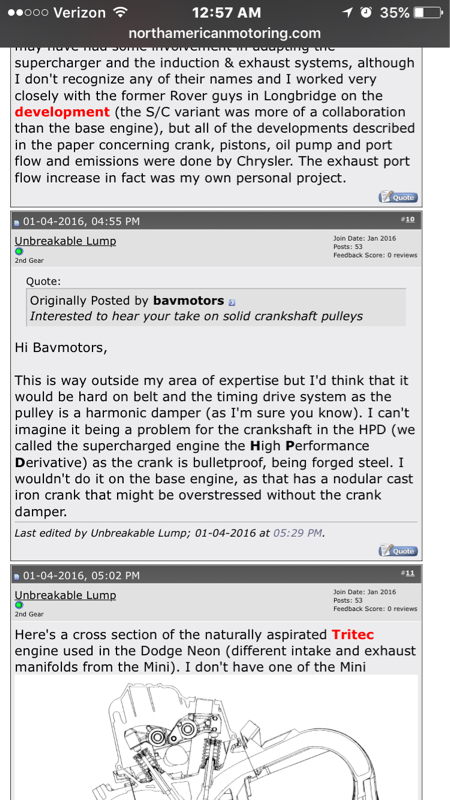

I hear you, it's my daily and I need mine for a long time also. I messaged a lot of guys on this forum who ran them for tens of thousands of miles without issues. There's a guy on here who helped develop the tritech who commented on the question.

Hey guys, people have gone over this before, but it has been proven again and again that a solid crank pulley is fine to run on the MINI R53. We've been selling these for well over 10 years, and have had customers drive on them for hundreds of thousands of miles and I haven't heard of anyone have any problems with their engines. If you guys want, I can probably dig up the original thread about it!
