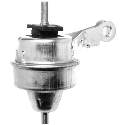

Notice how the black rubber extends up out of the mount. When the weight of the motor sits on this rubber; it compresses it down into the mount somewhat.
When you take the weight of the motor (by jacking it up); the rubber should return to it's 'natural' state. If it doesn't it is probably shot and worth replacing.

Thanks, must have read my mind. Was looking at this picture on Amazon. So, with the top of the mount missing and no weight present, it should look pretty much like this?
