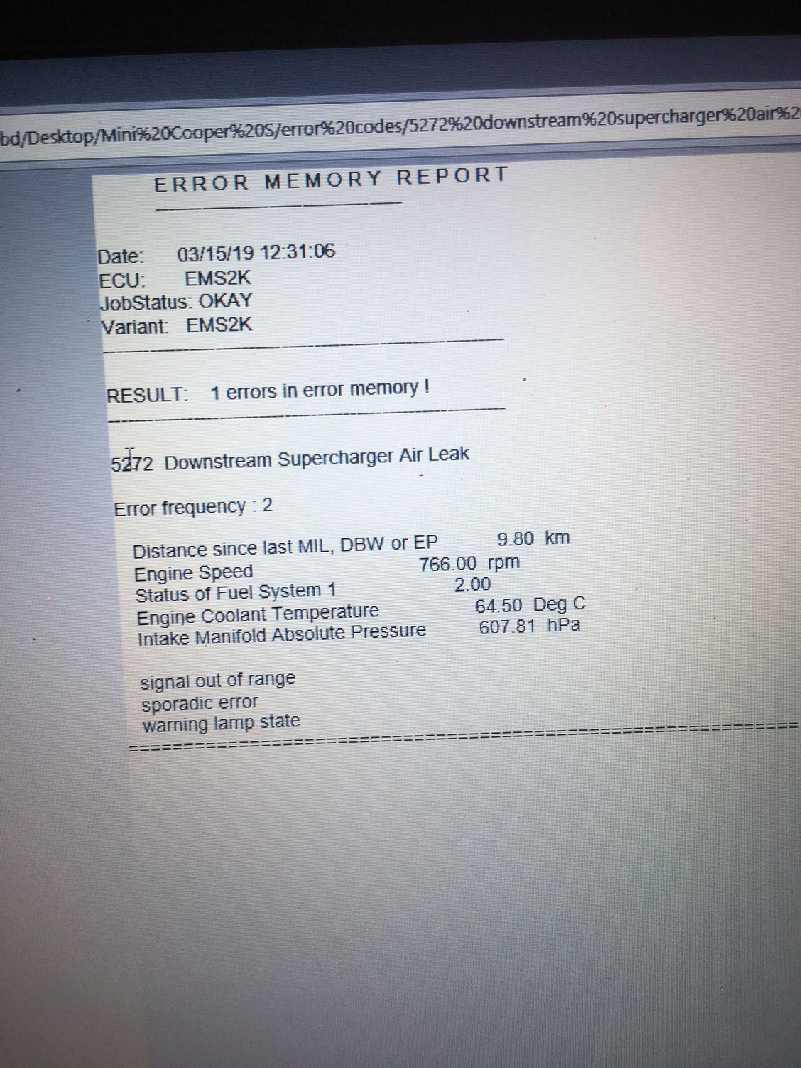

Hi forum, I'm getting a check engine light and EML light on and off / intermittently. INPA is showing code "5272 downstream supercharger air leak".

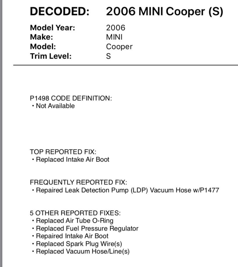

Hi I’m following this thread with interest. My 06 s is doing something similar. P1498 reported from blue driver obd scanner. Engine light on for all start ups now and remains on, eml is off on startup but appears after 15/20min driving full revs allowed I’m not in limp mode thankfully.
Looks like I have to do some hunting about the boots etc. See pic for what blue driver reported might help OP or anyone else.
