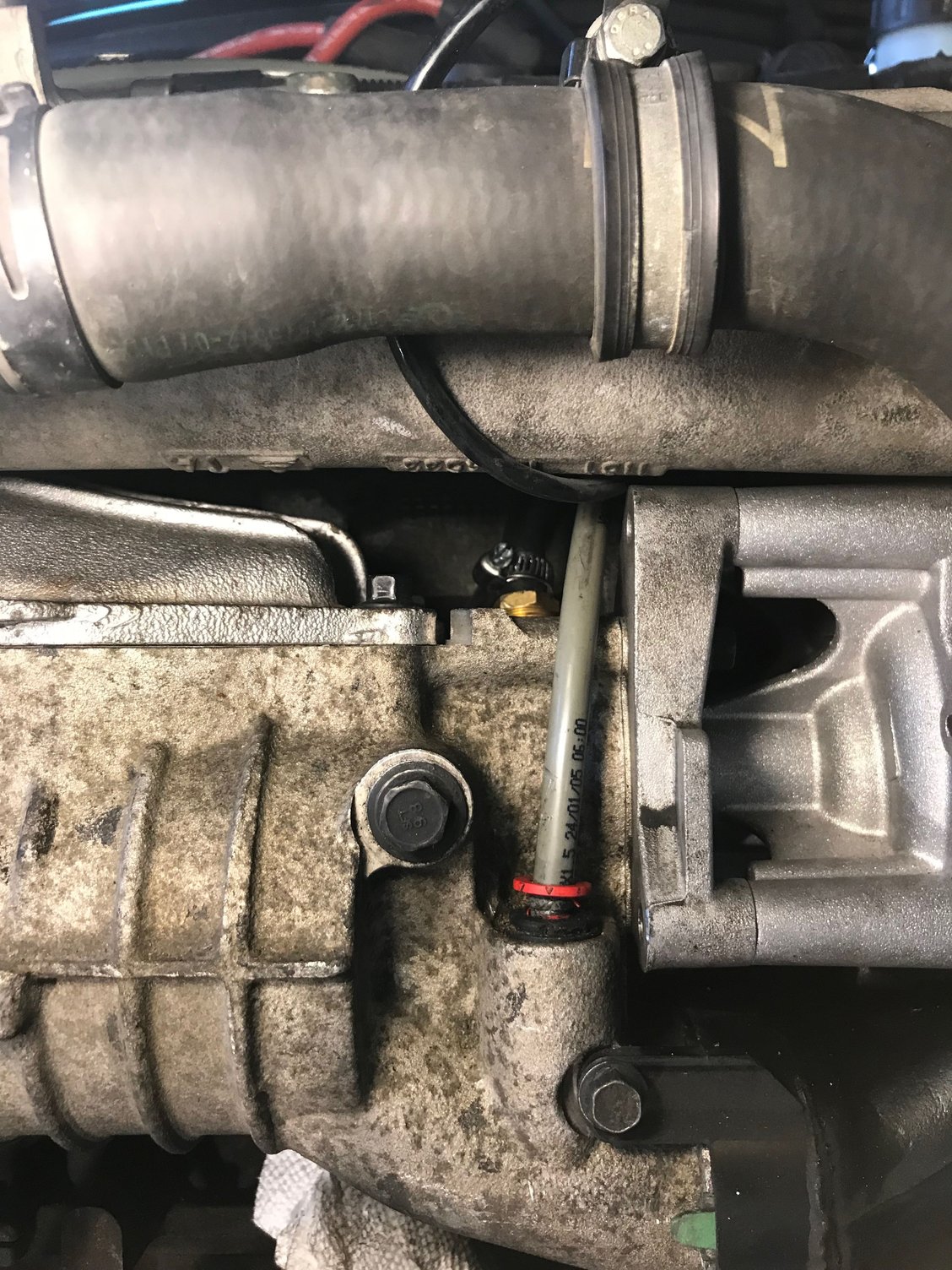

I added a hose fitting to the PTO side gear chamber. This is a brass 1/4" NPT hose fitting. This fitting has a tapered thread that requires a special tapered tap. That taper causes the hose fitting to seal tighter and tighter as it threads in. The size fitting is *almost* to large for this gear box, but it does just barely fit. You can see that it doesn't intrude into the gear chamber, so there is full clearance for the gear. I think the wall thickness of the gear box is about 6-8mm, which allows for a good number of threads to be engaged. I was able to put pretty significant torque on this fitting with no issues. I think a smaller fitting would be more appropriate, but this one was easy to get from the local parts store and it worked fine.
Make sure to buy the appropriate drill bit with the 1/4" NPT tap as it is over 1/2" and probably won't be in your workshop already.

Here you can see the oil fitting tucked away under the intake manifold. There is just enough clearance to fit everything comfortably.
