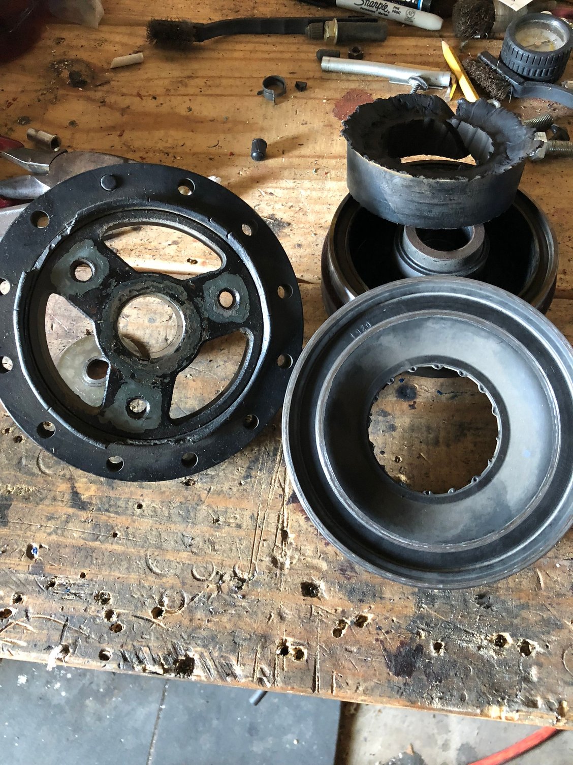

Your stock pulley has a rubber core that essentially holds it together. When compromised (separated), your accessories like the water pump, alternator and A/C compressor won't work properly due to crankshaft pulley slippage (you would also smell burnt rubber). If you're removing it to change out the front engine seal, you should easily be able to determine if it needs to be replaced. The crankshaft pulley is not hard to access/replace (remove the wheel and fender liner and it's right there in front of you), so my suggestion would be to wait until you're sure it's bad (good ones are not cheap) before shelling out the coin.

Yeah, here’s my filter after only 70,000 and a pic of a factory damper after only 68,000. That’s a damper off a 71 Chevelle that lasted 46 years as a comparison of good design vs bad design.
