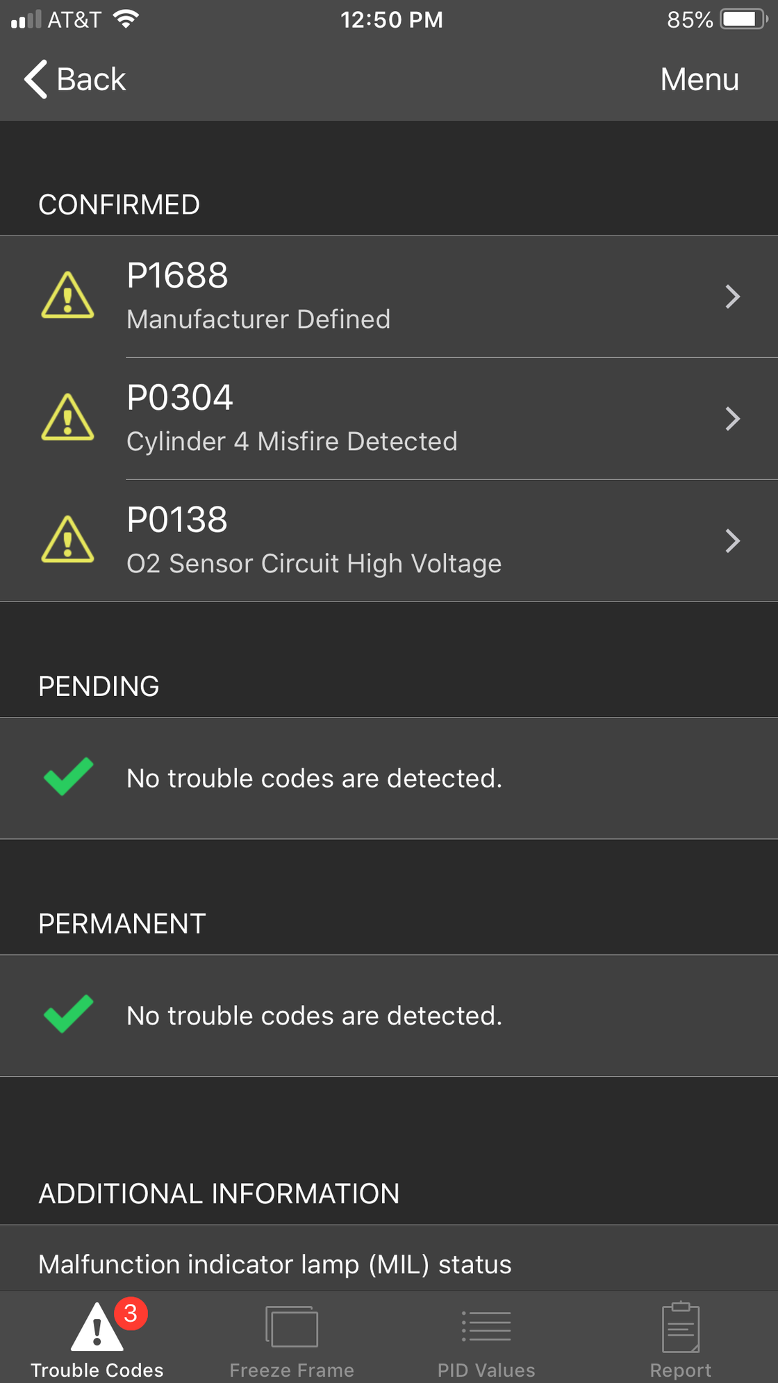

I have a 2005 MINI Cooper S with 125000 miles. Got a service engine light and my code reader kicked back a code PO138. Seems like I need to replace the number 2 oxygen sensor. It has never been replaced before. Was wondering if an aftermarket sensor on Amazon ($28.79) is sufficient enough quality vs. dealer part ($250.00) ? Also, should I buy a rethread tool to "clean the treads" after I remove the old one? Also, it looks very easy to replace by the YouTube videos I have watched, any suggestions before I start the job?
Thank you in advance !!!
or is it not necessary?

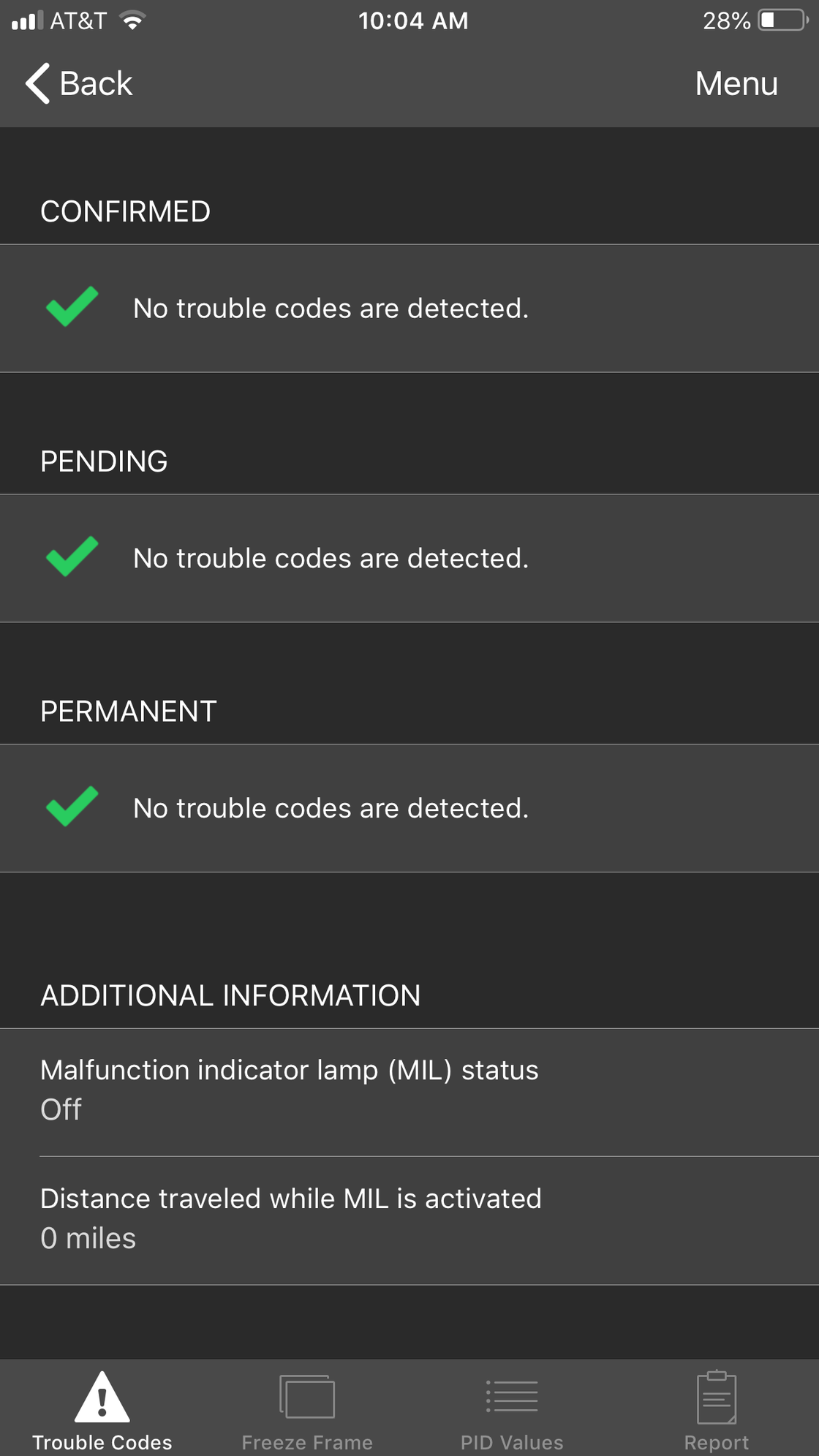

Old Nov 7, 2018 | 01:49 PM
beken's Avatar
beken
Joined: Nov 2004
Posts: 1,203
Likes: 21
From: Delta BC, Canada
Nicely done. Congrats.
