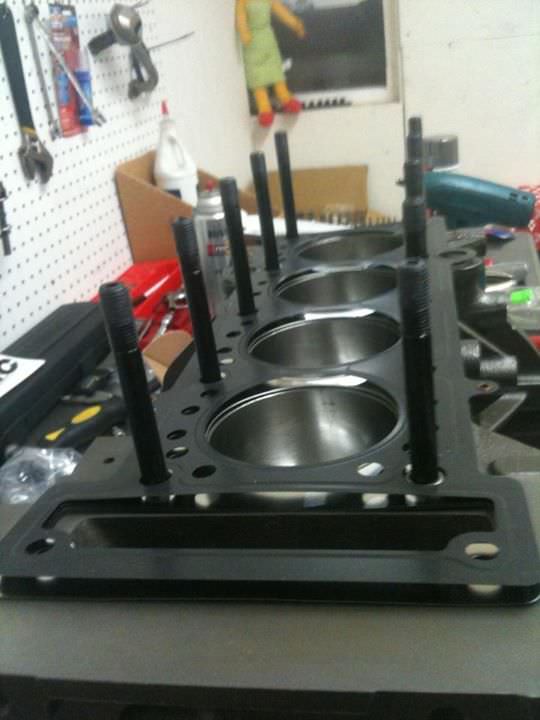

Block ready for the head:

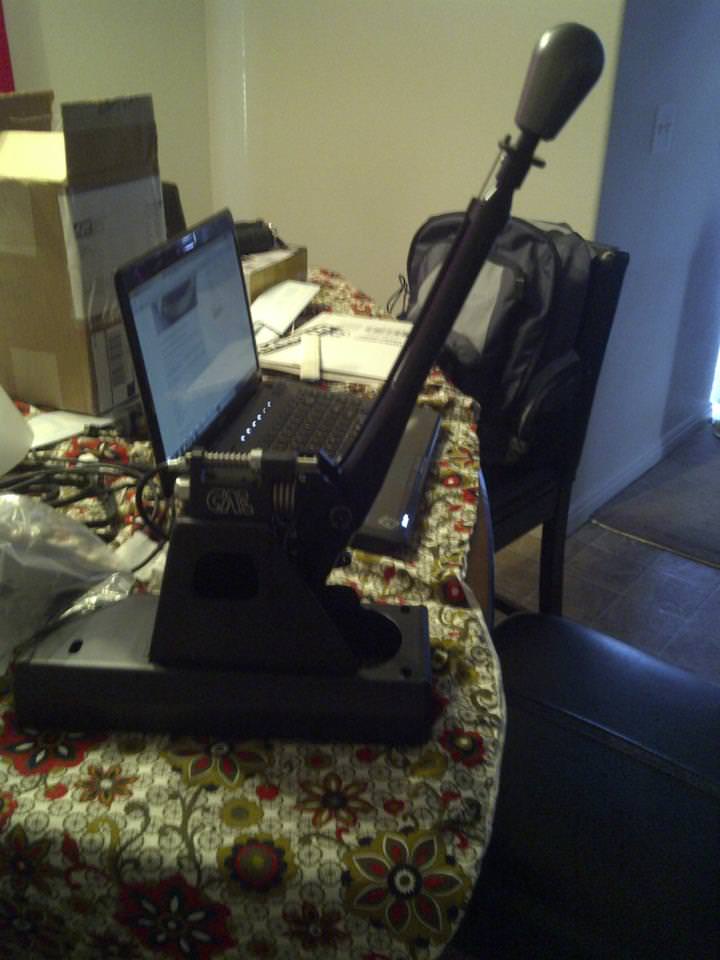

CAE shifter:

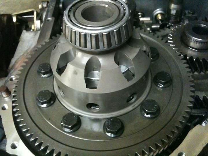

OS Giiken:

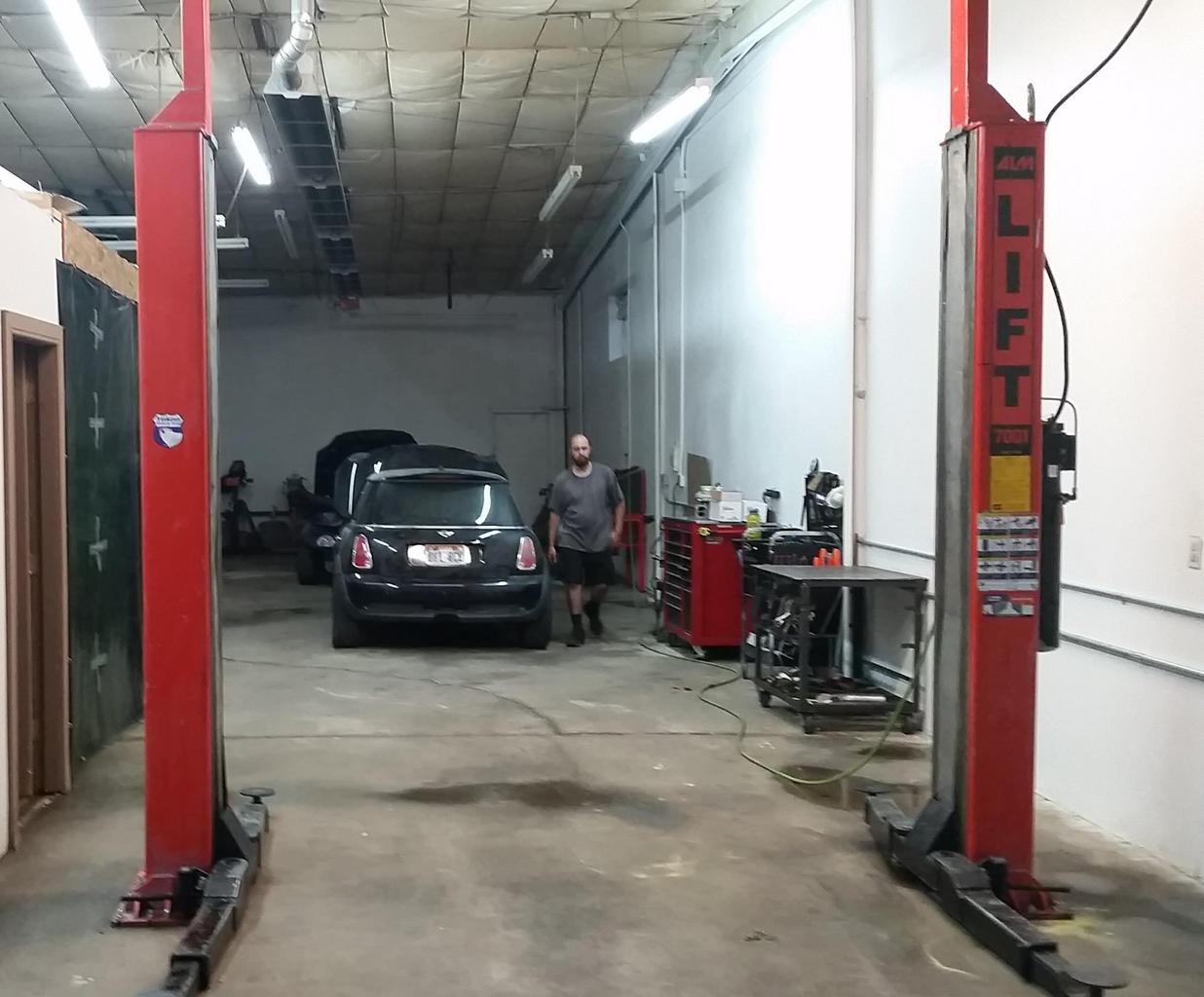

When I dropped it off to Cole for fab:

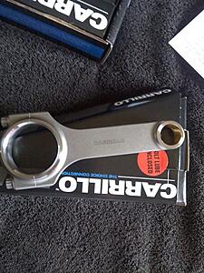

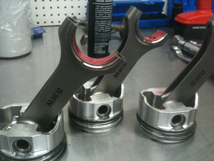

Rods:

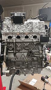

RMW engine built and ready to go:

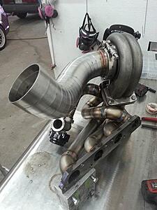

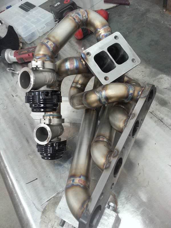

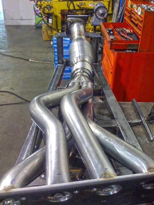

Exhaust Mani, and building the exhaust:
Mani with wastegates:

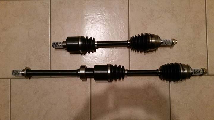

Axles:

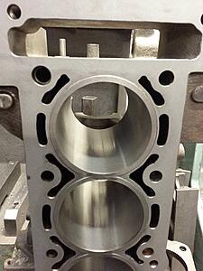

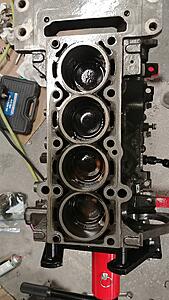

Block:

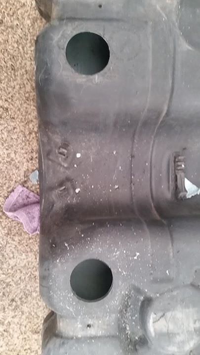

Sumped the fuel tank:

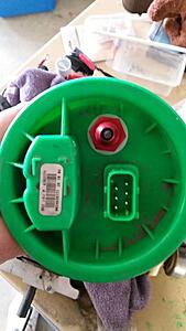

AN Fitting install on the stock hat:

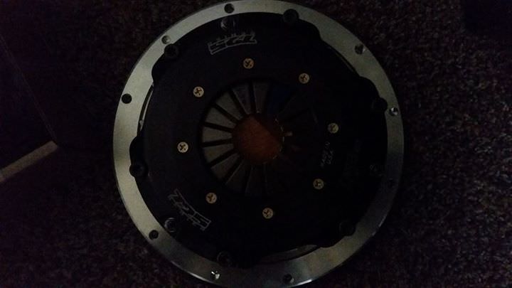

Twin disk:

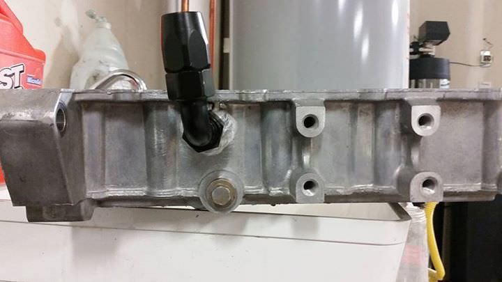

Pan with -10 return:

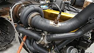

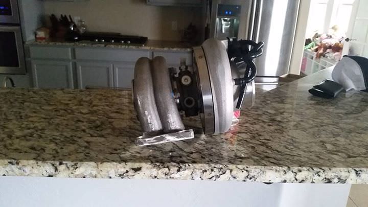

EFR8374:

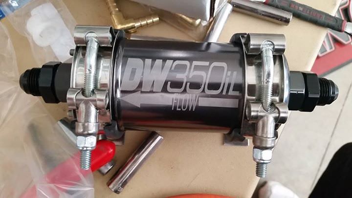

DW350:

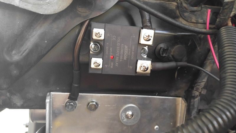

Solid state relay for the W2A water pump

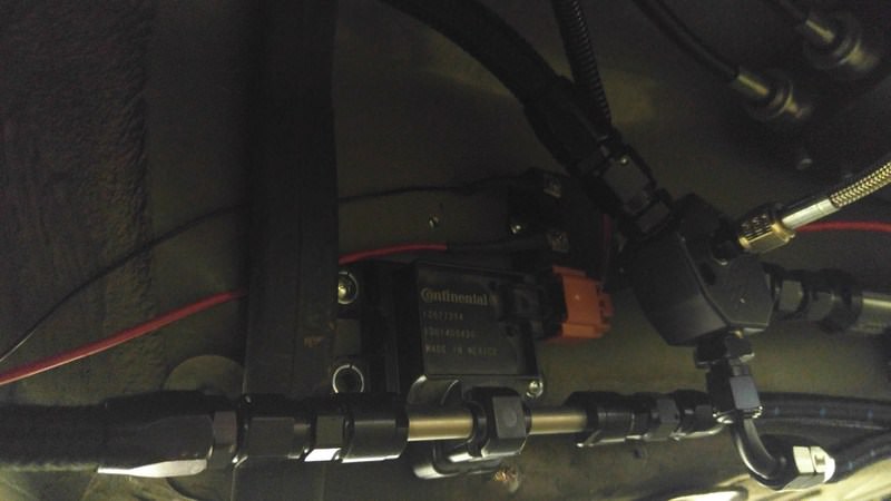

Flex fuel sensor, fuel pressure, and solid state for the external fuel pump:

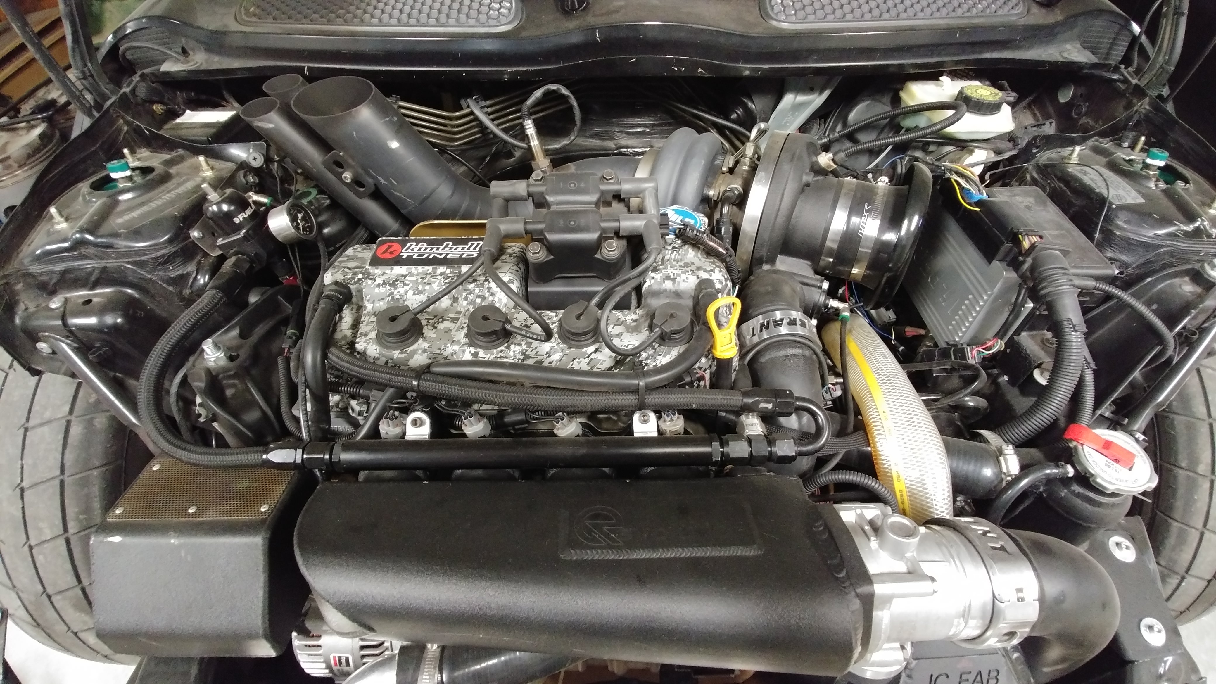

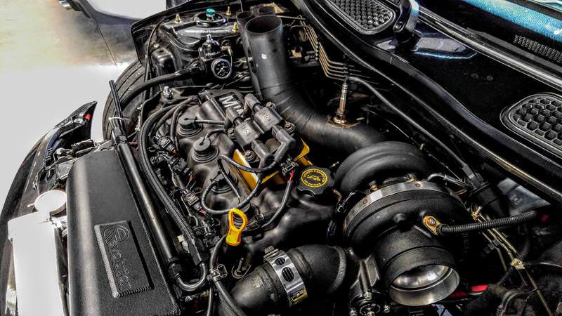

The assembled engine bay:

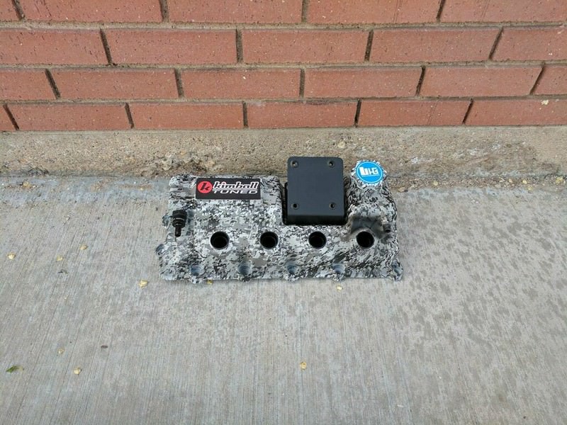

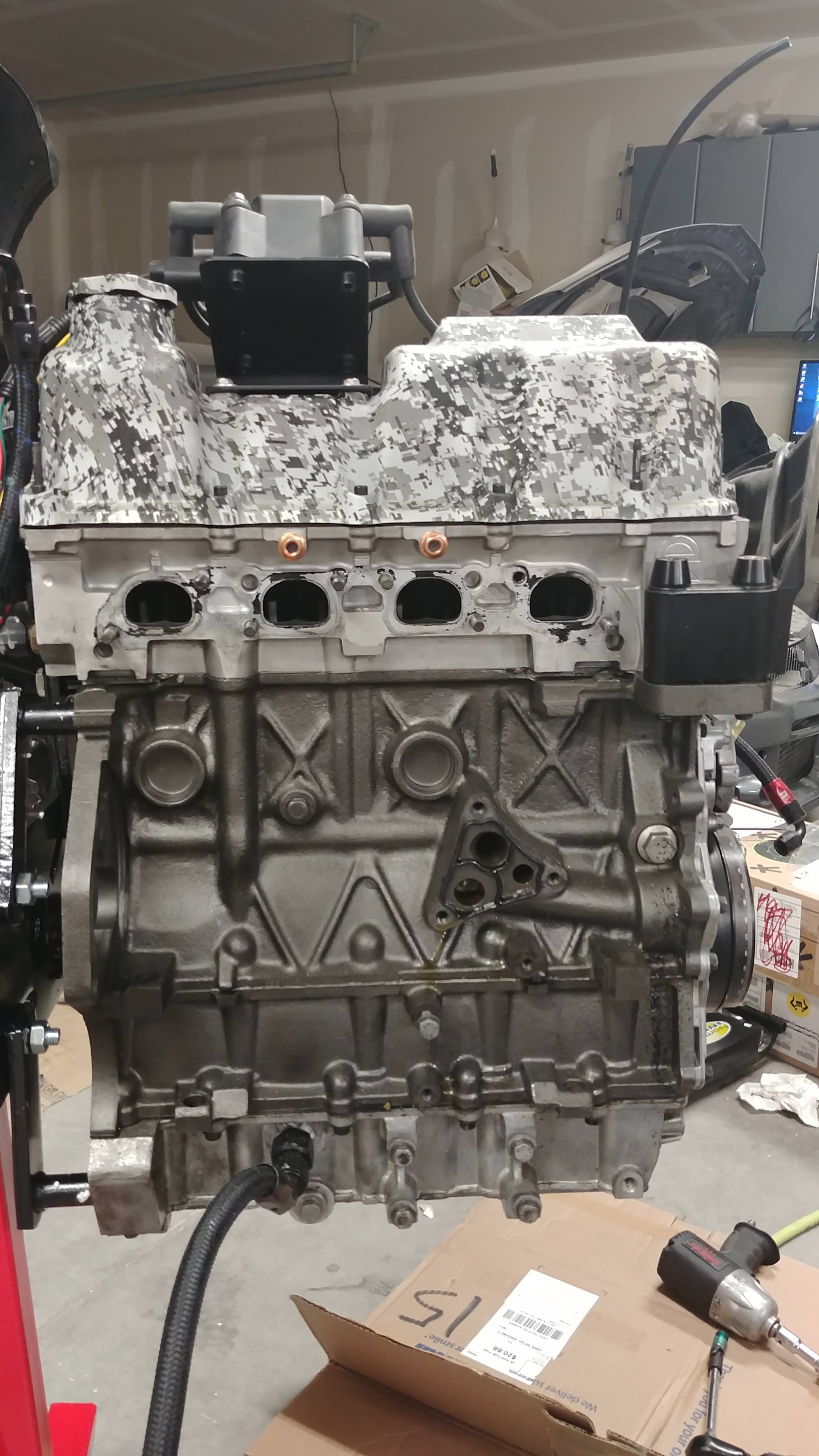

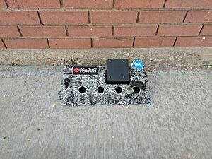

Dipped valve cover:

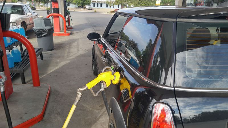

First Fill up of E85:

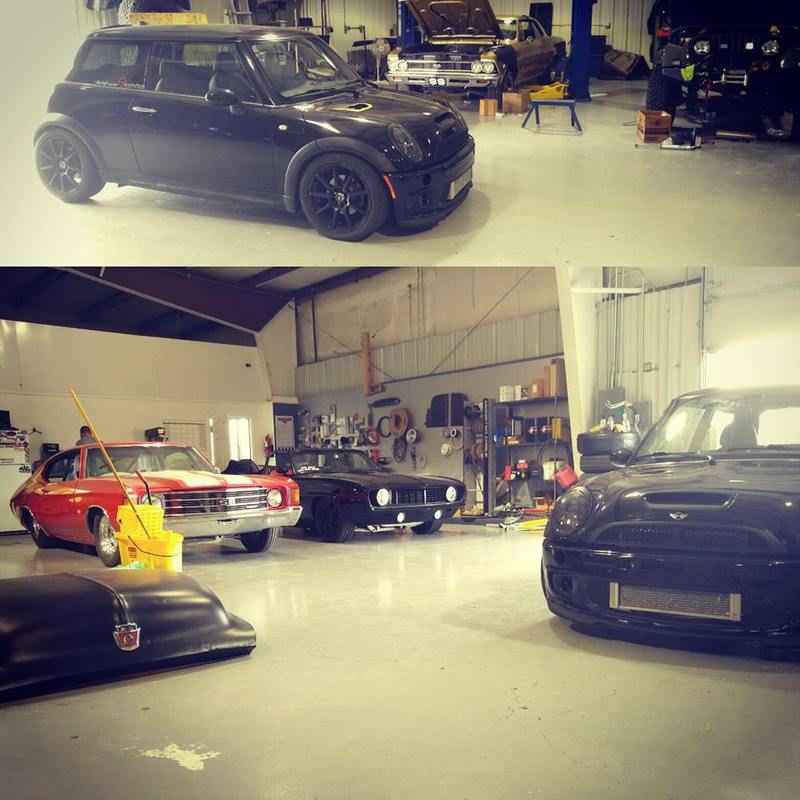

The Bomber sitting in the garage:

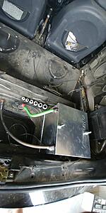

Did a battery box install:

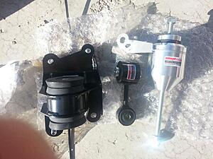

Mounts:

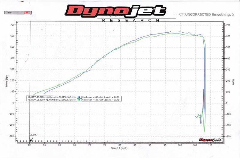

Dyno Sheet:

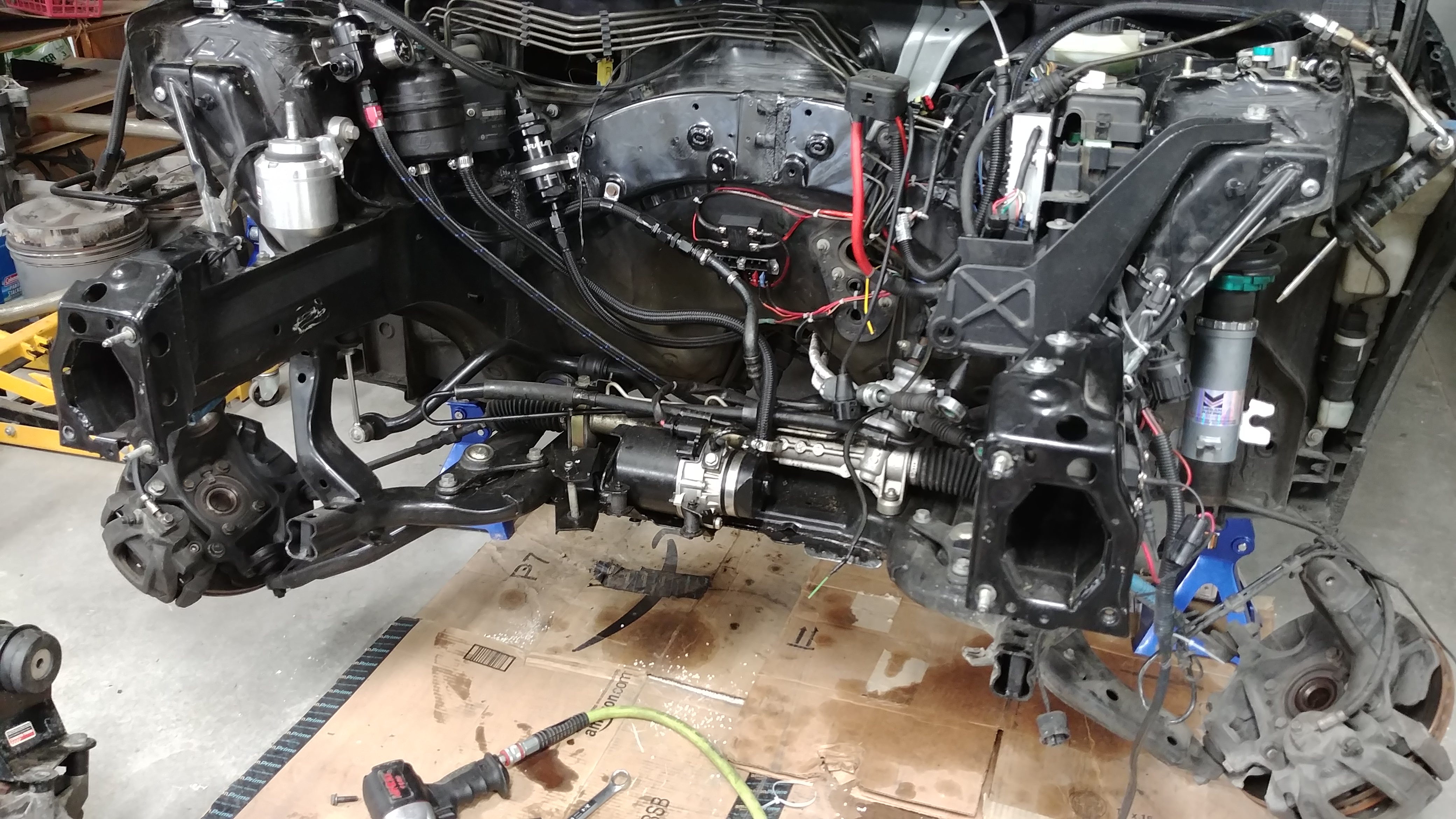

So I got to yanking out the engine:

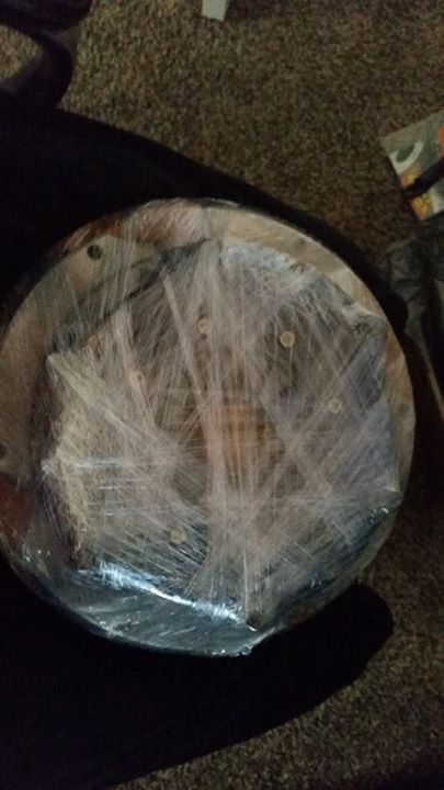

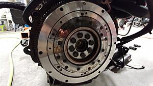

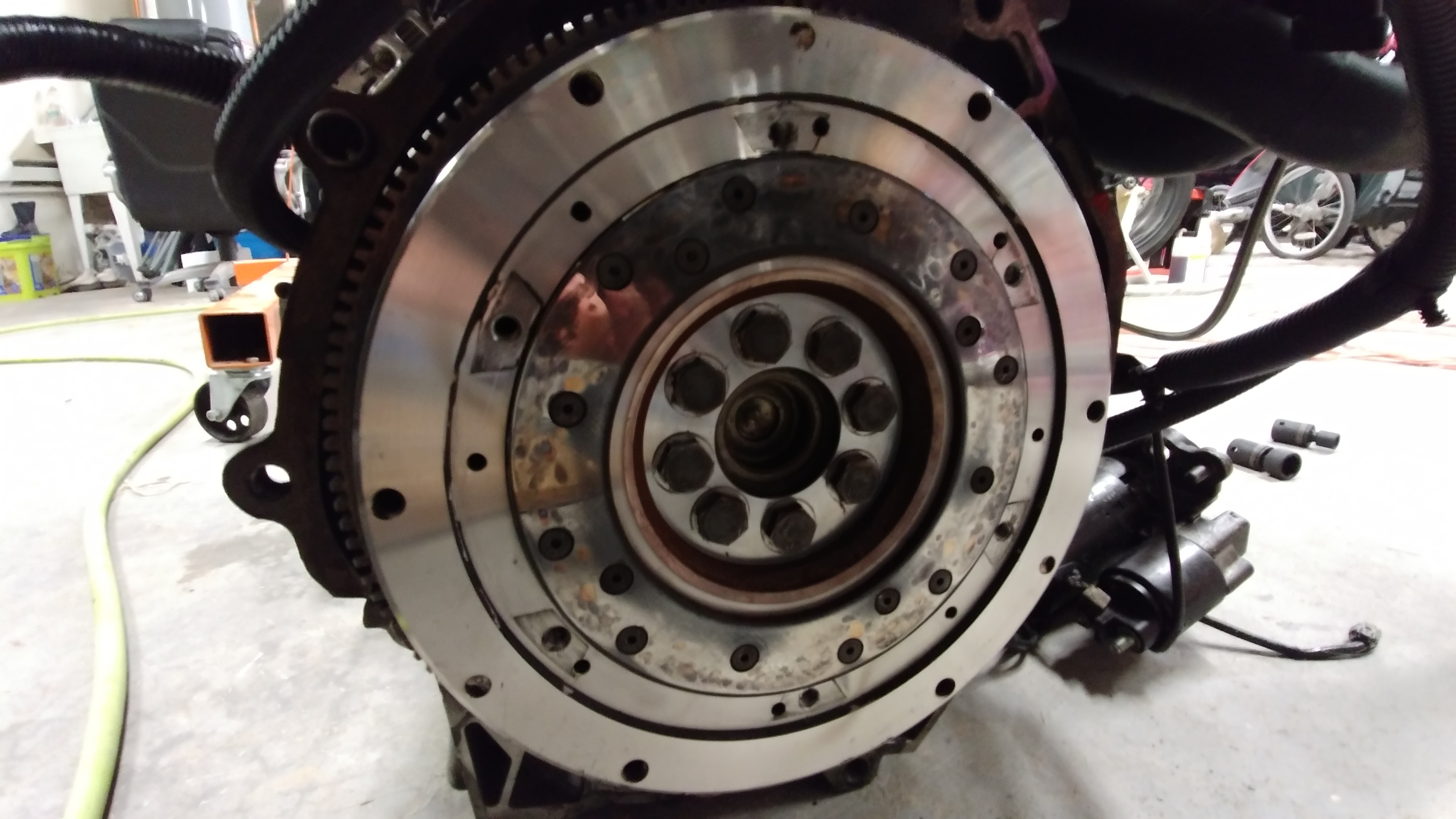

Clutch:

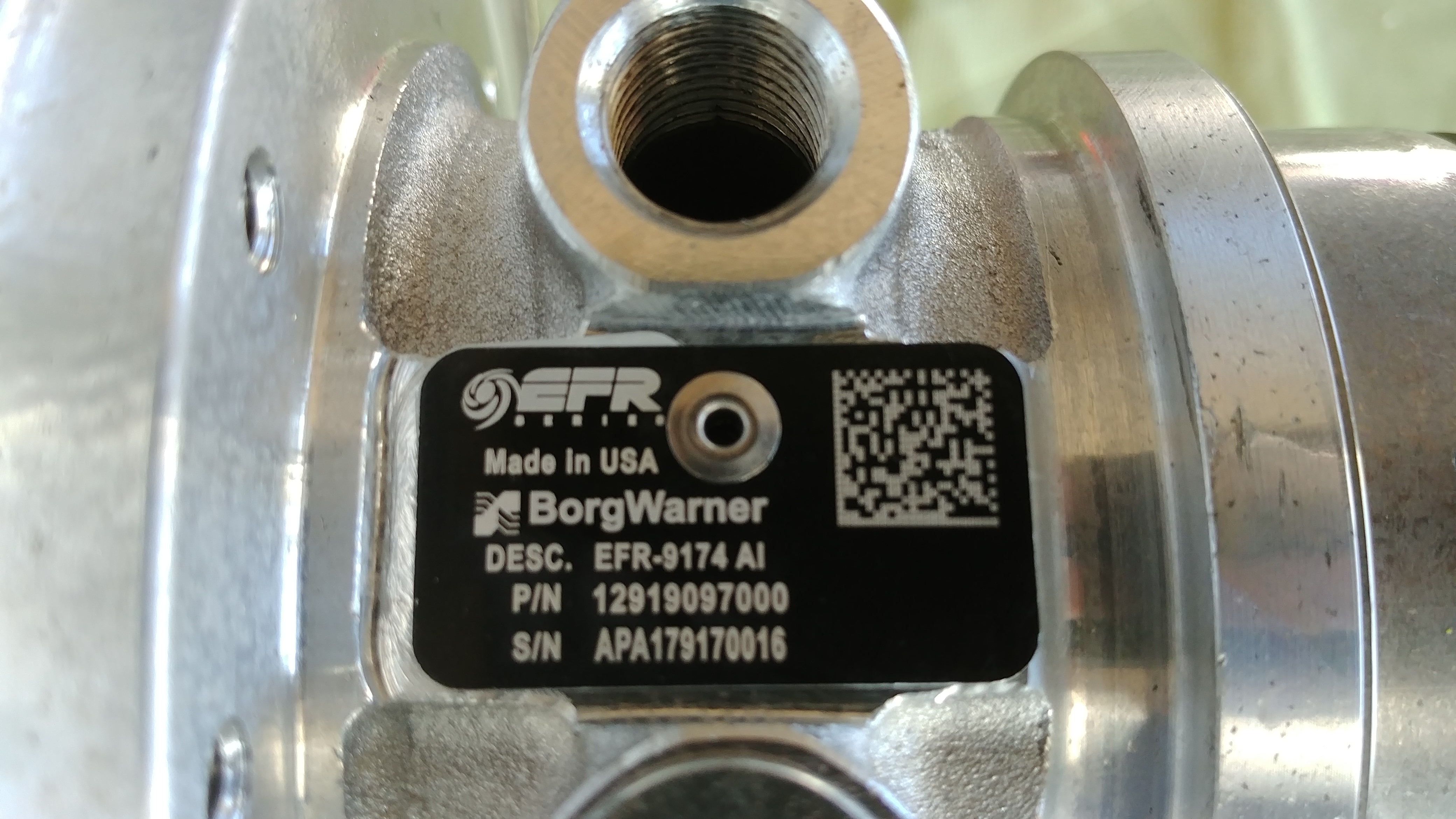

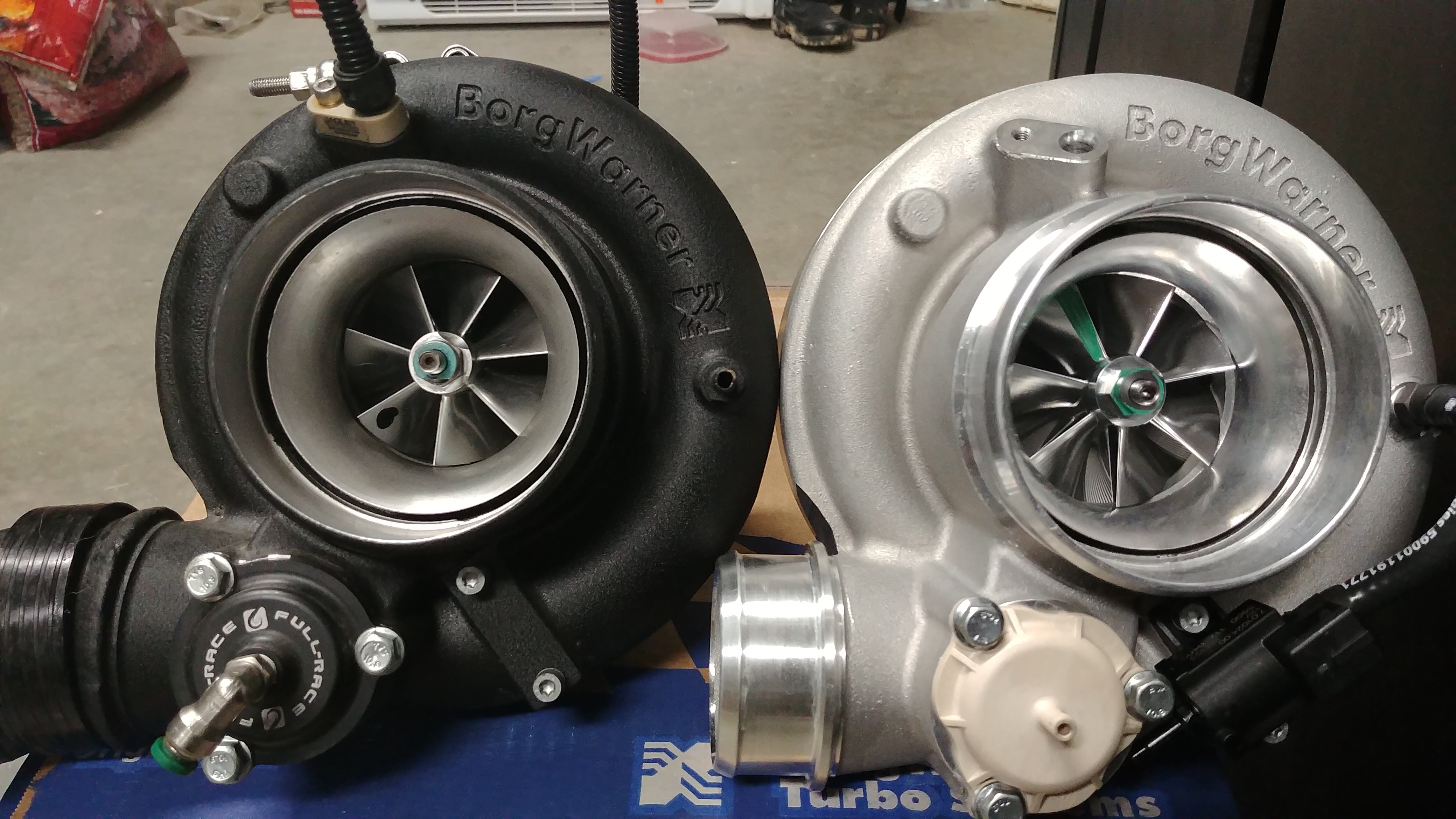

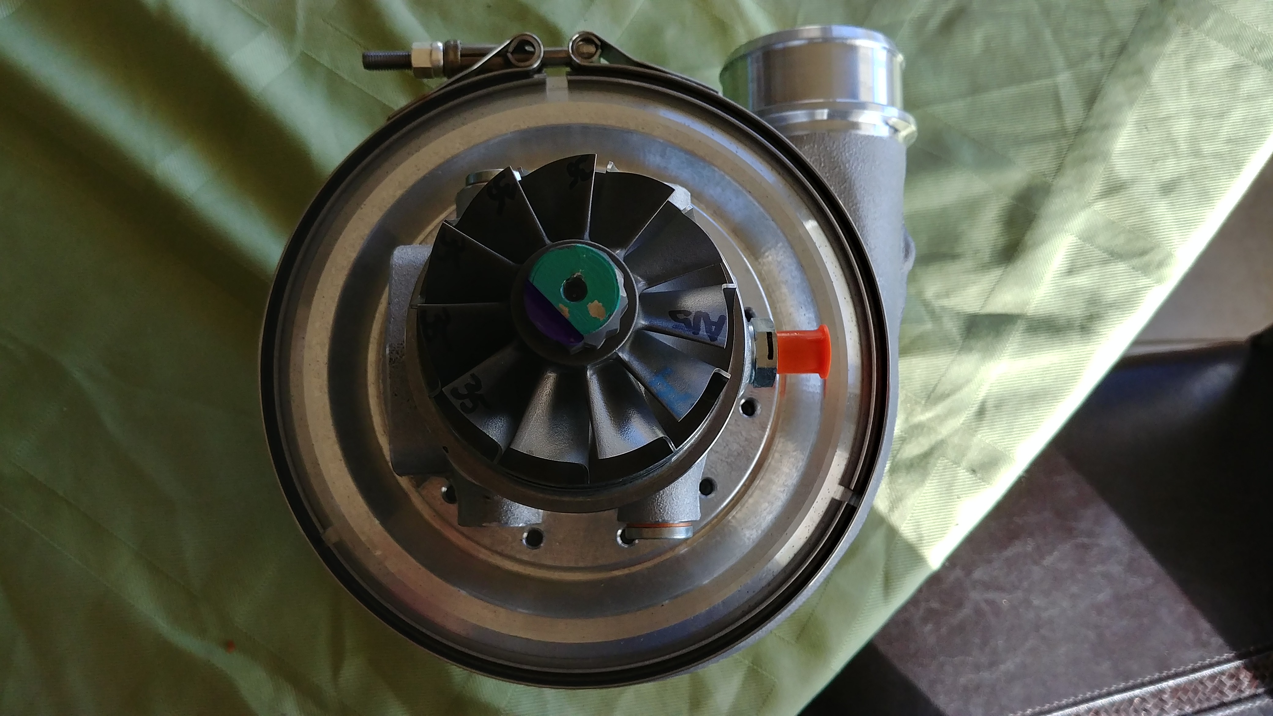

EFR 9174

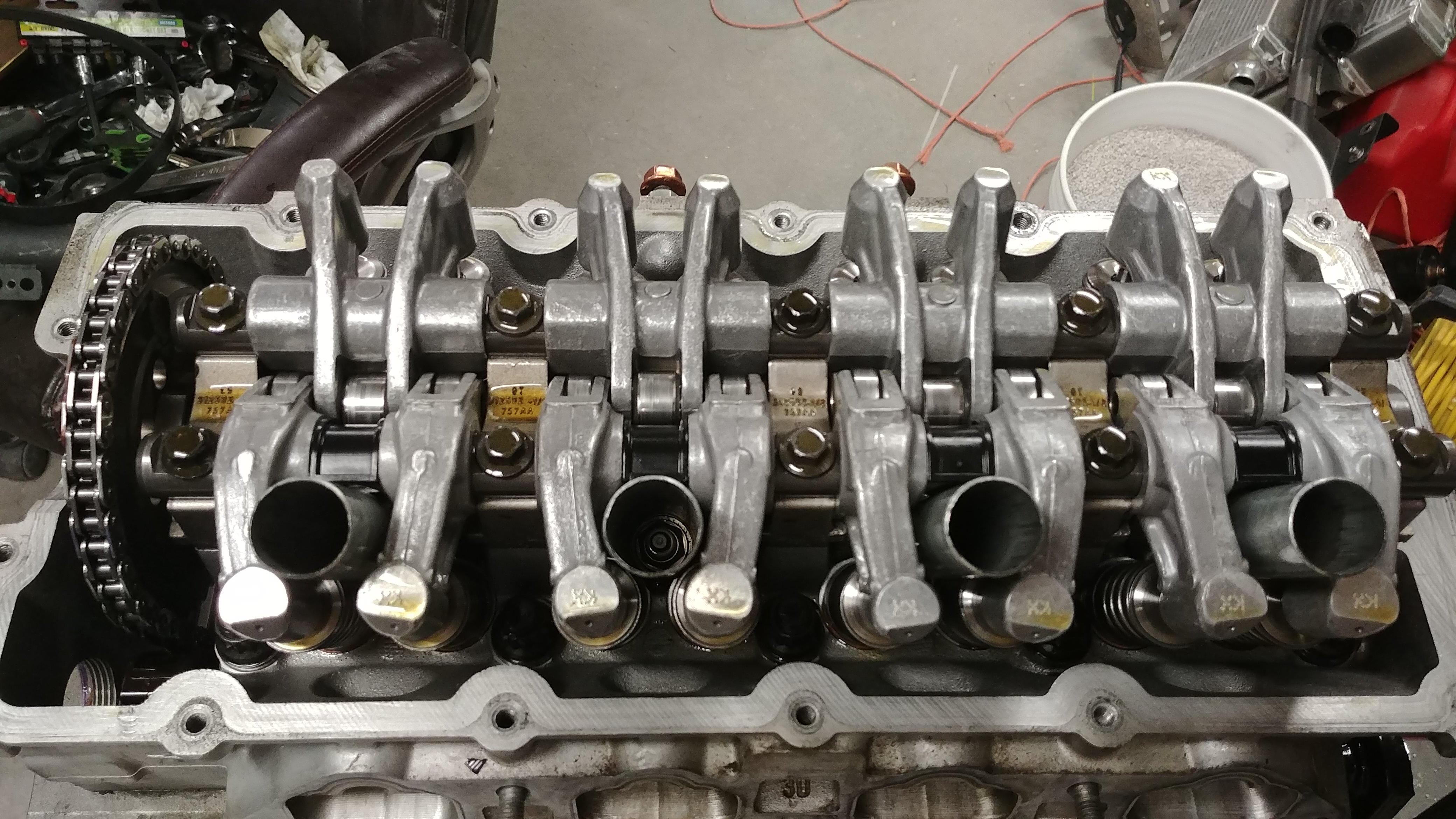

Under the valve cover:

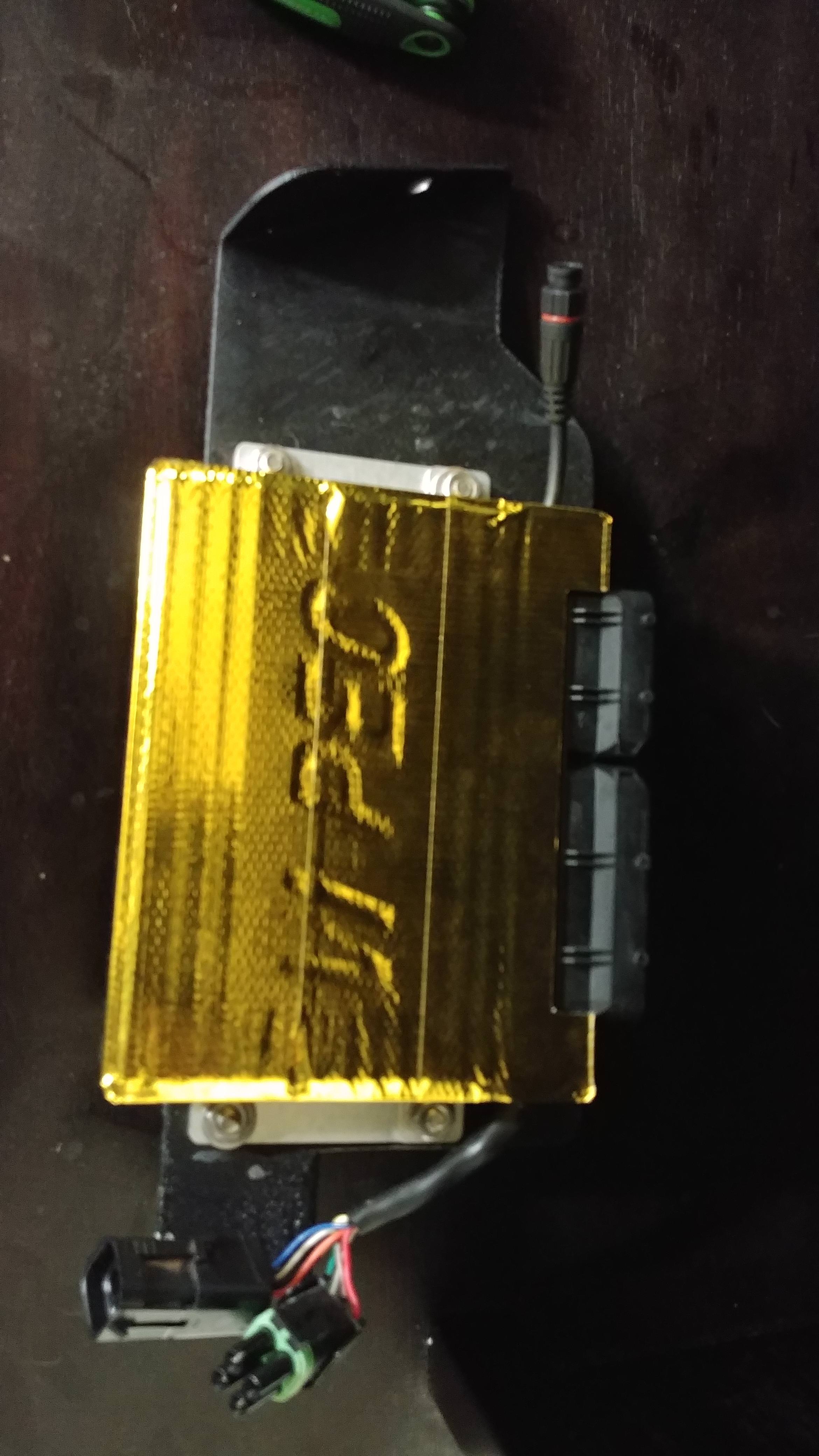

Wrapped the ECU, it was getting a little warm with the last setup:

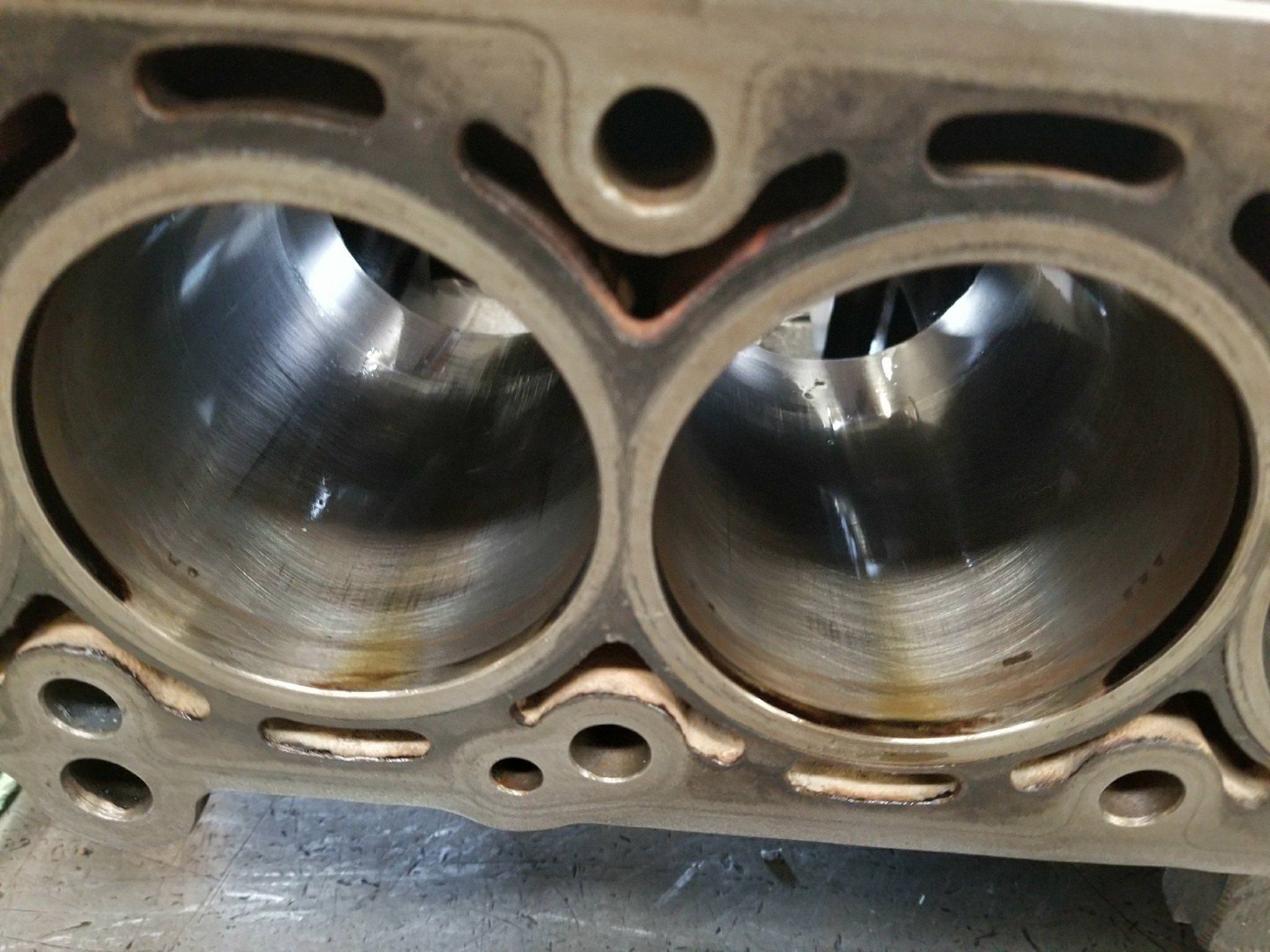

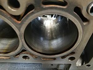

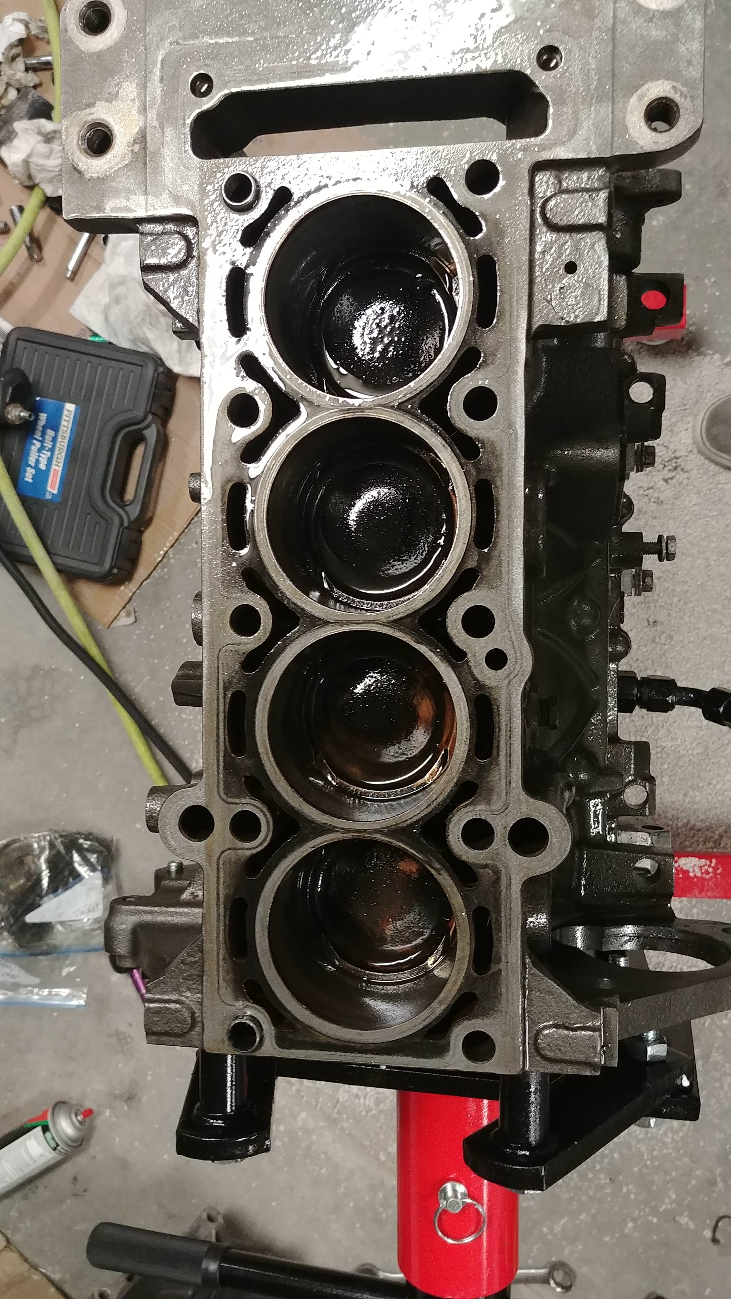

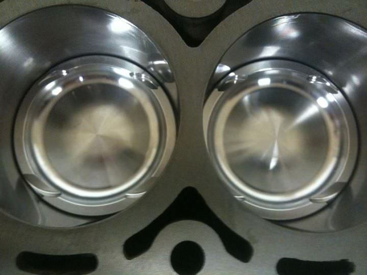

Sprayed everything down with WD-40 so that nothing would rust on the way to Jan. Pistons looked great, cyls looked great. RMW built one bad *** egine

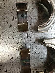

Engine looks good. Bearings look good, even for running them out of oil at 9K when I had a loose oil pressure sensor. Cross hatch is still in the cyl. Crank spins free and nice.
Now just a slight bore for the new pistons, solid rockers, I need to send my modified OEM pump back to Jan so he can start getting this thing back together.

A bit of wear there. Looks like it got through the coating and was headed into the material. How many miles were this? Were you logging oil pressure? I would be curious to see the reasoning behind this.
Old Jul 7, 2018 | 08:12 AM
llabmik2's Avatar
llabmik2
Joined: Sep 2007
Posts: 159
Likes: 35
From: Fruita, CO
I log a ton of data. Oil pressure is always logged, and safegaurds are setup to prevent it from rolling a bearing.
I lost oil pressure on pull at about 9200rpm. My oil feed came lose with vibration and emptied the pan. Engine shut down due to the safegaurd, but it was still in gear so it was deceling, as I tried to figure out why I had no power. Pushed the clutch in and took it out of gear and pulled to the side of the road. Then I figured out what happened with the whole back of the car was covered in oil.
Old Jul 7, 2018 | 08:18 AM
downshift1's Avatar
downshift1
Joined: Sep 2005
Posts: 423
Likes: 58
From: Disneyland
Got it, that make perfect sense then.

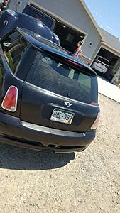

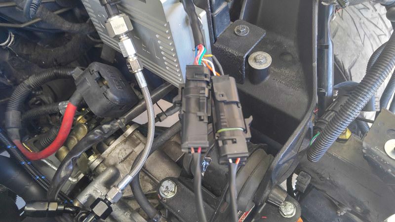

Here you can see the back of the car covered in oil right after that. I tighted that fitting on the side of the road, buddy brought me some oil and I drove it to this spot that it is parked at.
At this point the engine had 5000-ish miles on it. I put another 1000 on it after this happened and before I tore it down. Oil pressure was no different from when I first started the engine. The stock oil pump also sucks at that high of a RPM. I have modified it though, so I am hoping that it gets better now, when I get the engine in the car. If not, I am going to go dry sump and rev it closer to 10K.

Originally Posted by sevin
Was it you who shredded a couple gears? What have you done to build the transmission?
That was me.
I am making some parts. I don't want to discuss them yet, in case they don't work. Ill just say I am altering the oiling inside of the case, and working on getting sycros made. Other things also but I am keeping those close to the chest until they work out.
The trans seams to be just fine up to 500WHP. No worries at all at that level. Once you surpass that, things start getting iffy inside of the trans.

Originally Posted by llabmik2
That was me.
I see. And you’re running a pre-facelift trans with the taller ratios, right? Do you happen to know if it was just the 1st and 2nd speed gears + the ring gear that’s different between the two, or if it’s more than that?
Can you discuss what you’re doing to get the bottom end ready for 950hp? Isn’t your 650whp bottom end setup just stroked/sleeved with RMW forged goodies? Was it bored some or just honed?
I'll answer any question that I don't want to hold close to the chest at that point.
I am running the preface lift box yes. I believe that its 1-2 plus the ring gear. I will check when I get back home in a couple days.
Its a RMW stroker. So it has Jan's stroker crank and his sleeves. It is not a 1.8L though because we keep the bore smaller. So that makes it a 1.7L. The new engine isn't really new. The only thing we are changing on it, is the compression, who makes the pistons, and going to a solid rocker setup. So it will be: Smae RMW crank, Same RMW sleeves (bored a little for the new pistons), Mahle pistons, and Carrillo rods, same exact rods that were in the first 1.7L build. Just putting in new CARR bolts.
