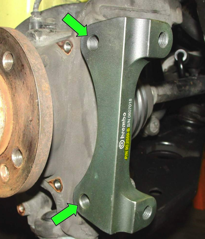

mm i could not find the part number however i found a picture of the adapter bracket from pelican parts i emailed them but they only sell as part of a kit
Old Jun 23, 2018 | 06:17 AM
p4ntb0y's Avatar
p4ntb0y
Joined: Jun 2018
Posts: 7
part number
Old Jun 23, 2018 | 06:42 AM

I would:
1.) Mount the rotor
2.) Place the caliper on the rotor and by using wood blocks/brake pads and soft wood shims get the caliper centered and placed so that the rotor is protruding above the pads by at least 1 mm.
3.) You are now able to determine what type metal angle you need; 1.25" x 2", 2x2, 2x2.5 etc. I would want at least a 5/16" think angle.
4.) As your holes are 130 mm center to center, I would start with a 7" long angle.
5.) With the caliper/rotor shimmed back in place, place on leg onto the hub/carrier connection and the other up to the bottom of the caliper. You should be able to use a small c-clamp to hold the angle in place. Cut the angle if the caliper ends are hitting it due to the curvature.
6.) Now mark the locations of the holes on both angle legs.
7.) Place the hub/carrier bolt from the back side so that you can place a nut on the face of the angle you can see. The hub/carrier is a 12 mm bolt.
8.) Do the same thing with the leg that is against the caliper.
Of course what I can see in my head cannot always be explained so others can figure it out.
