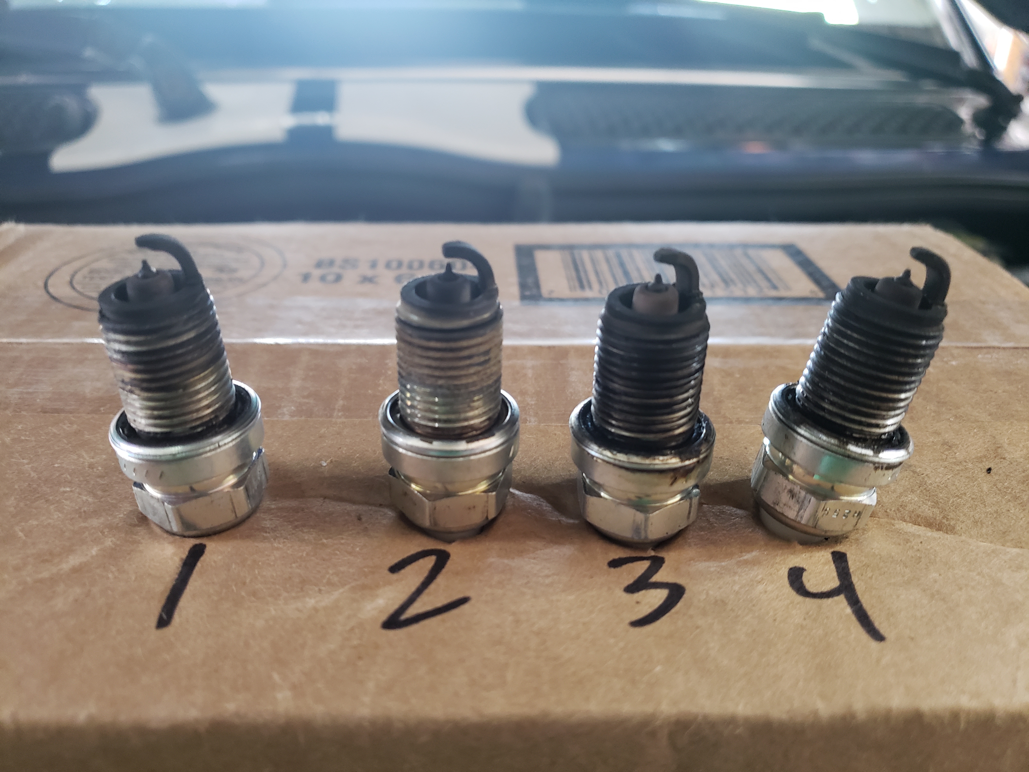

I changed the spark plugs. . .
Attached Thumbnails Project: '03 R53 Resurrection-20180623_173758-1-.jpg

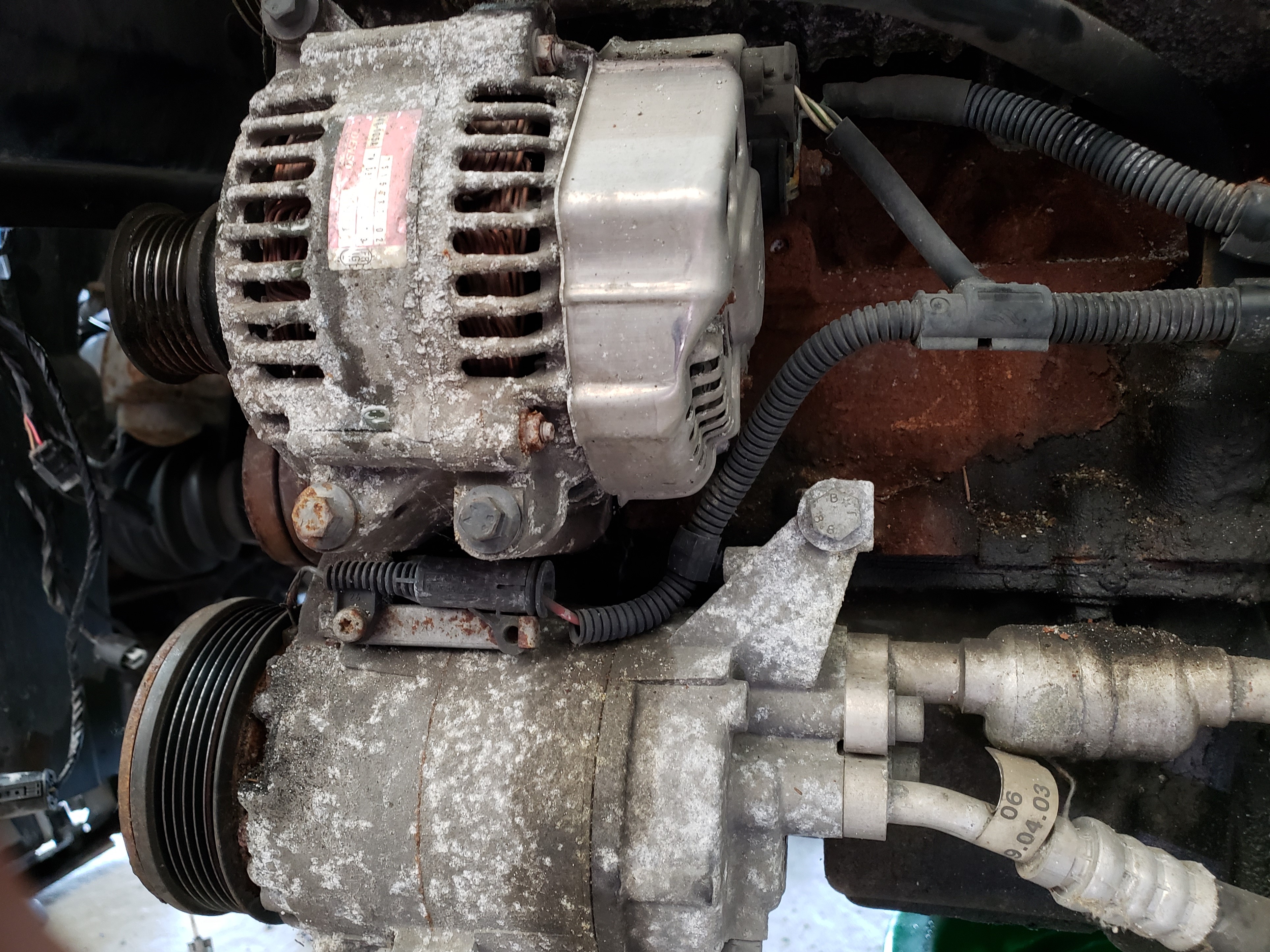

It's alive! The alternator is seized.
Today I removed the starter, took it in for testing (passed as expected), and reinstalled it. During starter R&R process I replaced the oil filter housing gasket (thanks again Whine...) In the process I managed to misplace an exhaust manifold bolt somewhere in the chassis. I'll find that later. After no improvement to the cranking speed, I decided to remove the belt and try to spin everything independently. That's when I found out the locking tab in the tensionser spring is bent inside the housing, so it won't come out. After a quick snip with the HandiCut the old belt was out. I reached down to spin the alternator and it won't budge. That was the ah-ha! moment. Then the car fired effortlessly on the first turn. . . at 12:30AM. . . with open headers. . . while everybody else was sleeping.

Warning: attached pics contain potentially offensive images- especially to residents in the southwest US.
Attached Thumbnails Project: '03 R53 Resurrection-krusty-.jpg   Project: '03 R53 Resurrection-krusty2.jpg

Nothing to see. Just a life of high sodium diet. You can do the same frohliching Daytona beach all the time.

Thankfully it's all light surface corrosion and wipes off with a finger. I haven't found any heavy scale, pitting, or rust-related damage. So, that's good. I haven't snapped any bolts off, yet, so I'll take that as another win.

Marvel Mystery oil does a job cleaning up the salt/white oxide bloom.

My compressor looks like that with almost 300K. But I replaced my alt, so its still looks pretty new, but yes the salt up here beats its up pretty bad.
