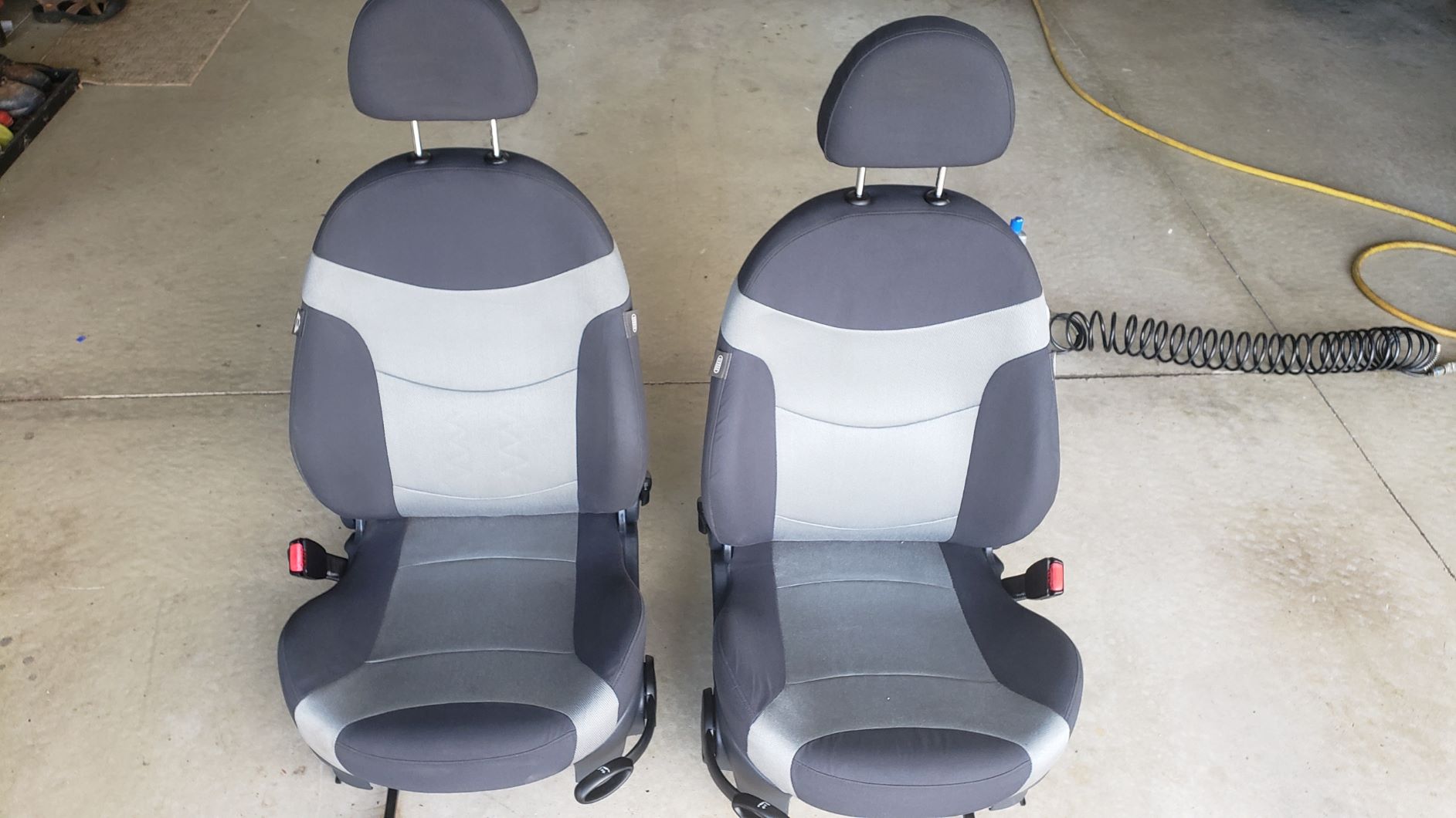

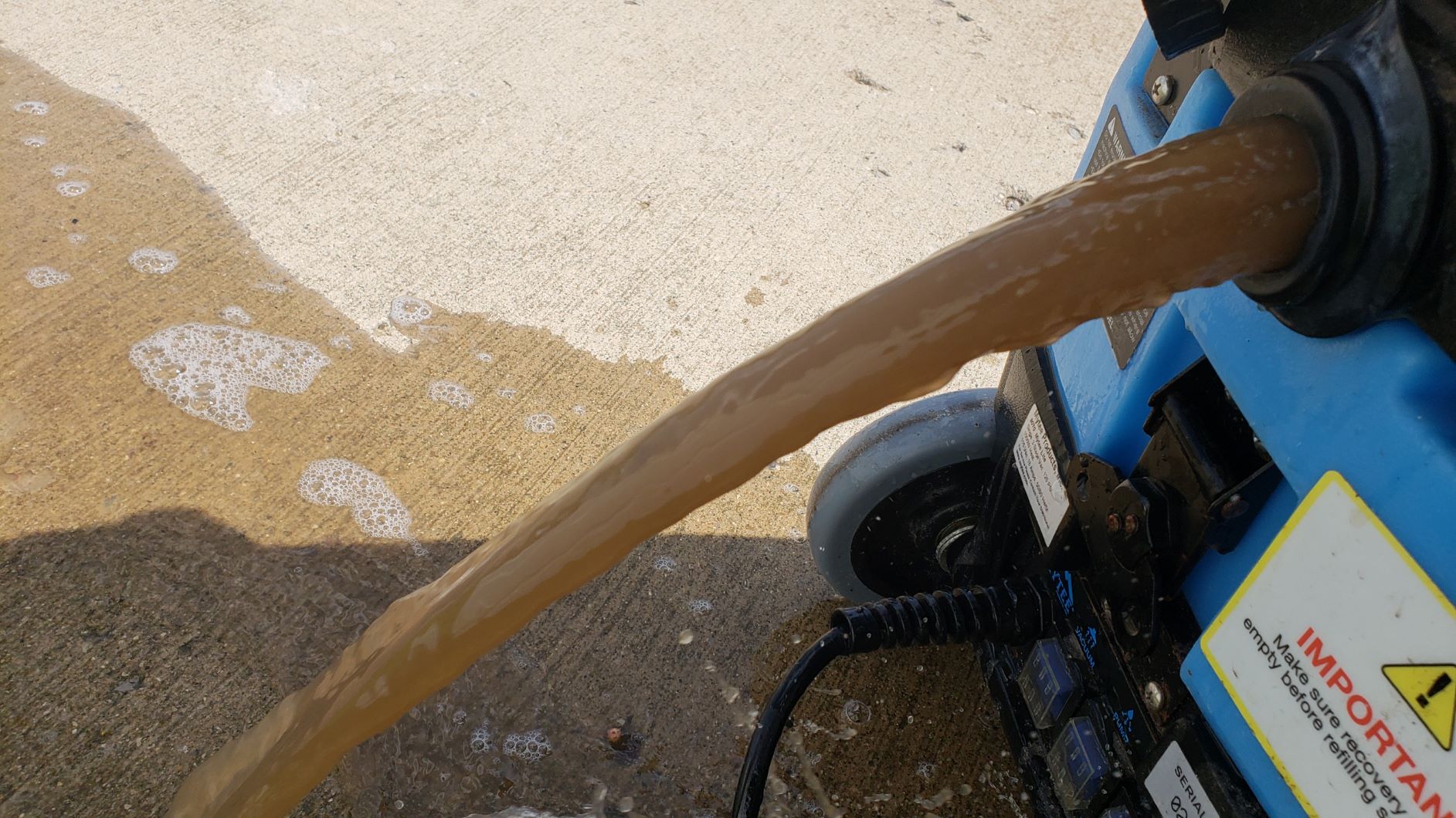

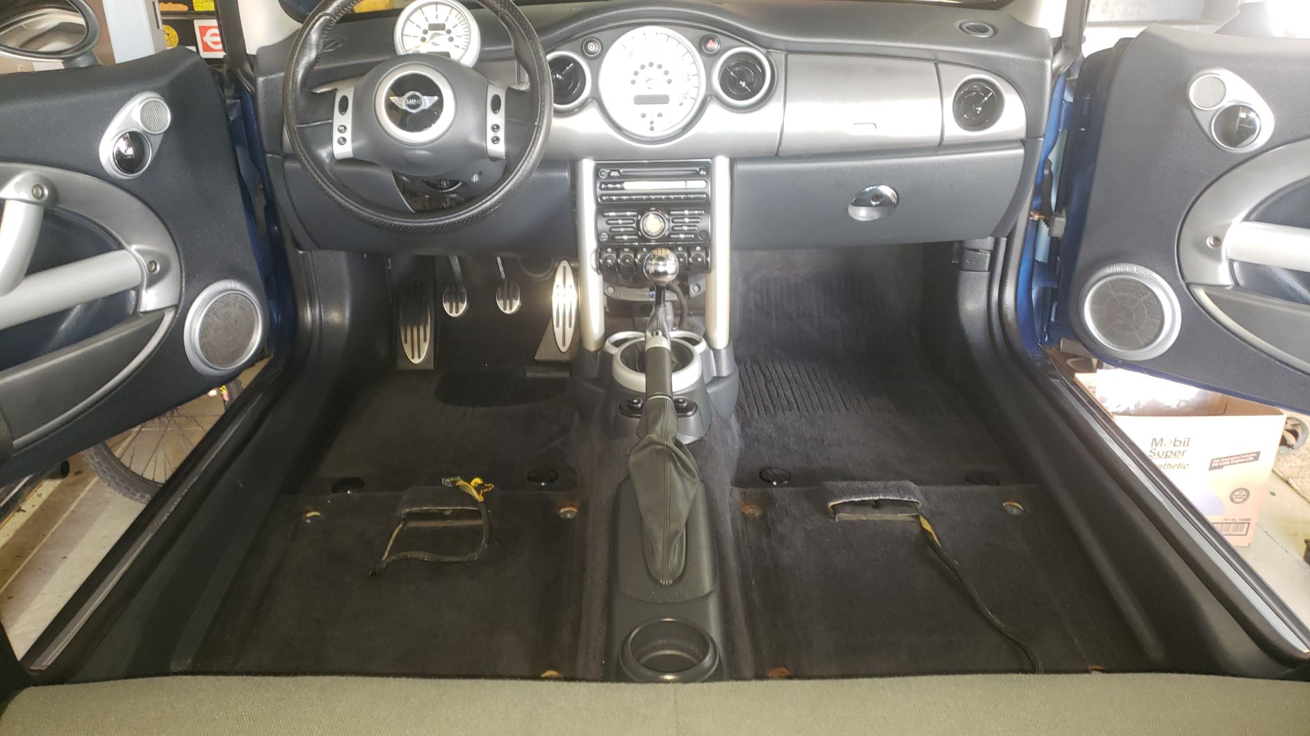

Today I accomplished cleaning the interior and depleting any cleaner that I was running low- stain remover, glass cleaner, plastic restoration dressing for hard plastics, plast-x on the gauge faces, and diluted Simple Green. The Mytee vac doesn't get used too often (usually for cleaning up after dog accidents in the house), but when it does it's the MVP. Sure beats the heck out of bucket, stiff brush, & towels.
One thing has me stumped. . . the removable panel for accessing the rear of the heater controls and radio is covered in some black, sticky toxic goobage. Tub o' towels, full strength Simple Green, liquid dish soap, WD-40, nor carb & choke cleaner were up to task for cutting through this stuff. I'll try acetone or mineral spirits next. The strange thing is that this stuff is only on that panel. It doesn't have a distinct smell- I was expecting a coolant smell- and it's not on any of the other surfaces in the area.

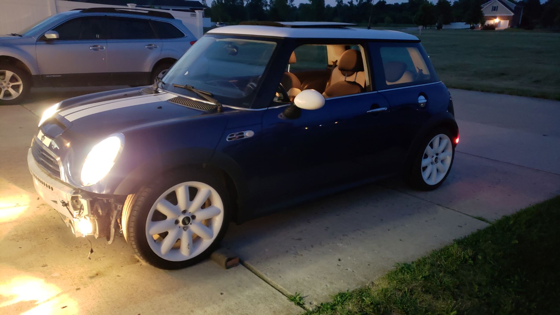

The valve cover bolts arrived and the productivity dam broke loose. Valve cover on. Intercooler on. Oil added. PS fluid topped off. Coolant added- filled as much as possible through the tank, then filled the rest through the bleeder screw using a syringe. By this point it was only ~8:30PM. So, figured what the heck. Slapped on the wheels and took 'er for a test drive around the neighborhood. Didn't get out of 2nd gear and no aggressive shifts from 1-2, but everything worked as expected. . . except the brakes. The brakes totally suck, but I have SS lines, parking cables, and fresh fluid to install. I'm pleasantly surprised that everything worked and all the diagnostic lights remained off. The first impression is overwhelmingly positive. . . the exhaust note might be a bit too aggressive for our taste, but we'll see how it goes.
Aside from the brake work, the next tasks are to install the bumper cover, align the rear hatch, fix the battery hold-down, replace the windshield, detail the exterior, get insurance & plates, then terrorize the local cloverleafs.
