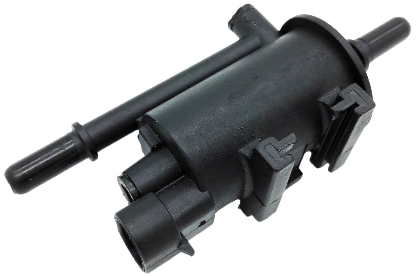

So two things maybe you guys could answer
after suspension replacement the ABS, TPMS, and DSC lights had gone away that was untill i hit a bump then they came back, but if i turn the car off and back on they go away untill i hit a bump again.
Second is the P0442 code i ordered this should be here today
https://images-na.ssl-images-amazon....L._SL1378_.jpg
however if i clear the code and drive all day with a few starts and stops did about 80 miles and it did not return awesome because i need to go to inspection when to run it again to pass a 100 hundred miles so the computer is in readiness mode so i can pass inspection and it came back on the next morning
I have tested this a few times now and it almost always comes back the next morning on start up.
Any suggestions other then replacing the part listed above

So i fixed the evap code with 20$ part from amazon. Then after resetting and driving 40 miles i popped a P0130 code o2 Sensor circuit bank 1 sensor 1. I have reset it and put about 30 miles on it with about 6 starts and stops so far.
