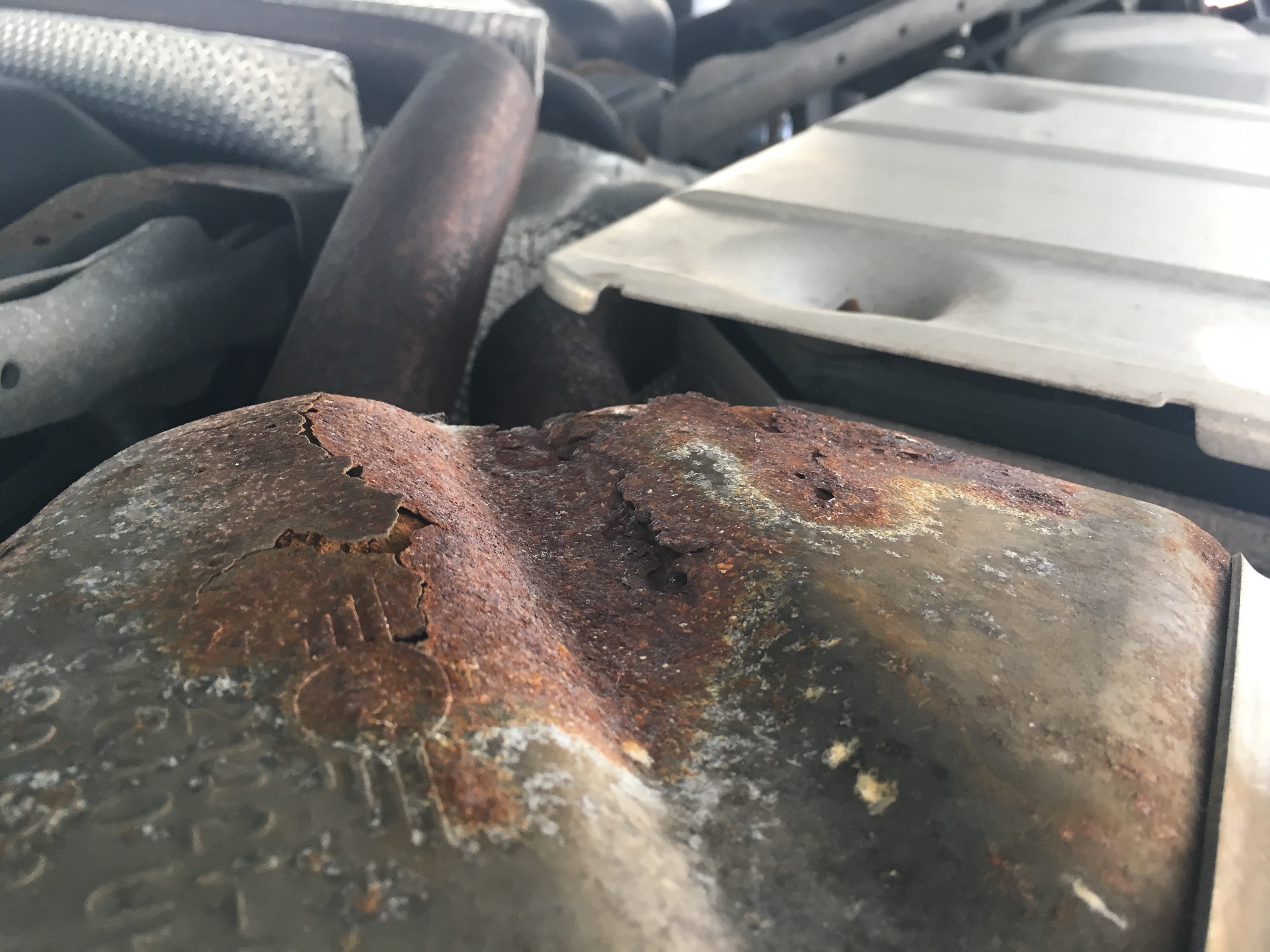

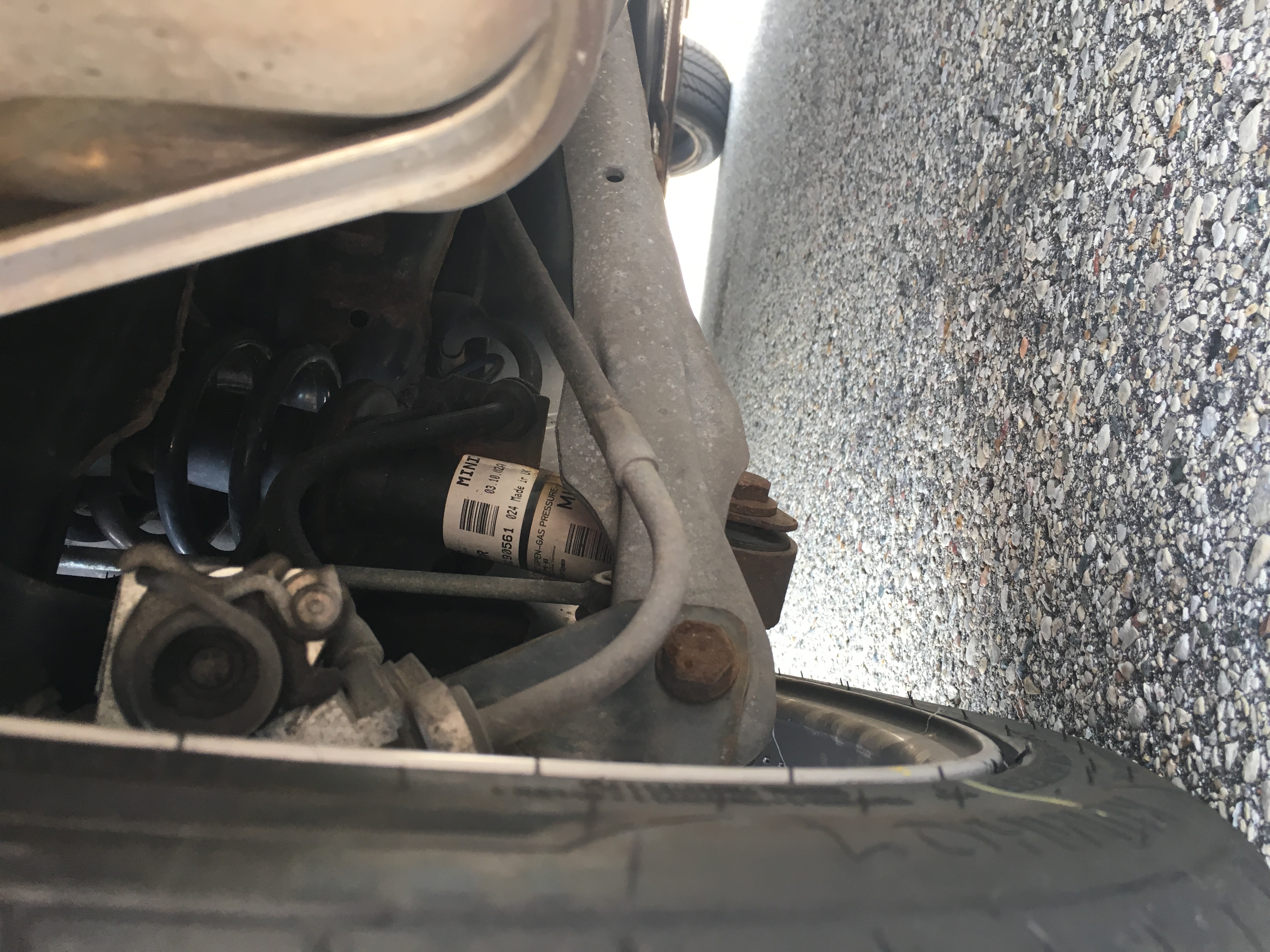

So let me start off by saying I really appreciate everyone's input and advice. It really helped me with making my decision and knowing what to look for.
The PPI from my mechanic revealed the following (as expected from most of this group):
After reviewing the PPI list with the seller, we agreed on a selling price of $3,250, so I felt that with knowing the work involved to bring it up to speed and only 44K miles, what the heck - I'll buy it and see what happens.
I was happy with the fact that when put on the lift, he could not find any evidence of rust (besides the resonator). It looked very clean and well kept. Not even a door ding on the car. I did pull the rubber door gasket/seal and noticed moisture, but no rust there either.
No oil leaks of any kind (although I know they are coming) and nothing else was discovered during the inspection.
Once again, I appreciate everyone's advice and I'm sure I'll be asking for it again - but probably in the performance modification forum instead!
