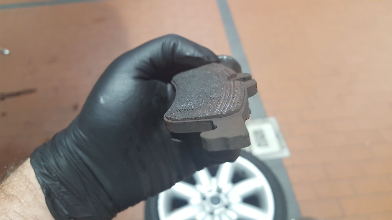

So my low Brake pad light was on. The previous owner informed me that I needed new brakes.
I did.
That's not even the worst.
This one is.
You can see the groove on the backing plate the rotor made.
I don't have any pics of the new hardware but they were: New stainless braided hoses, brass caliper guide pin bushings, Centric NON-Cryo blank rotors from Tirerack and Hawk HP+ Brake pads.
I also needed a new right rear caliper as the boot was torn, didn't want to deal with rebuilding it.
