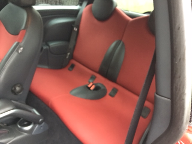

I just realized I never posted up pics of my new toy in this Thread; although I did in another Thread. But I'll some here too! lol
