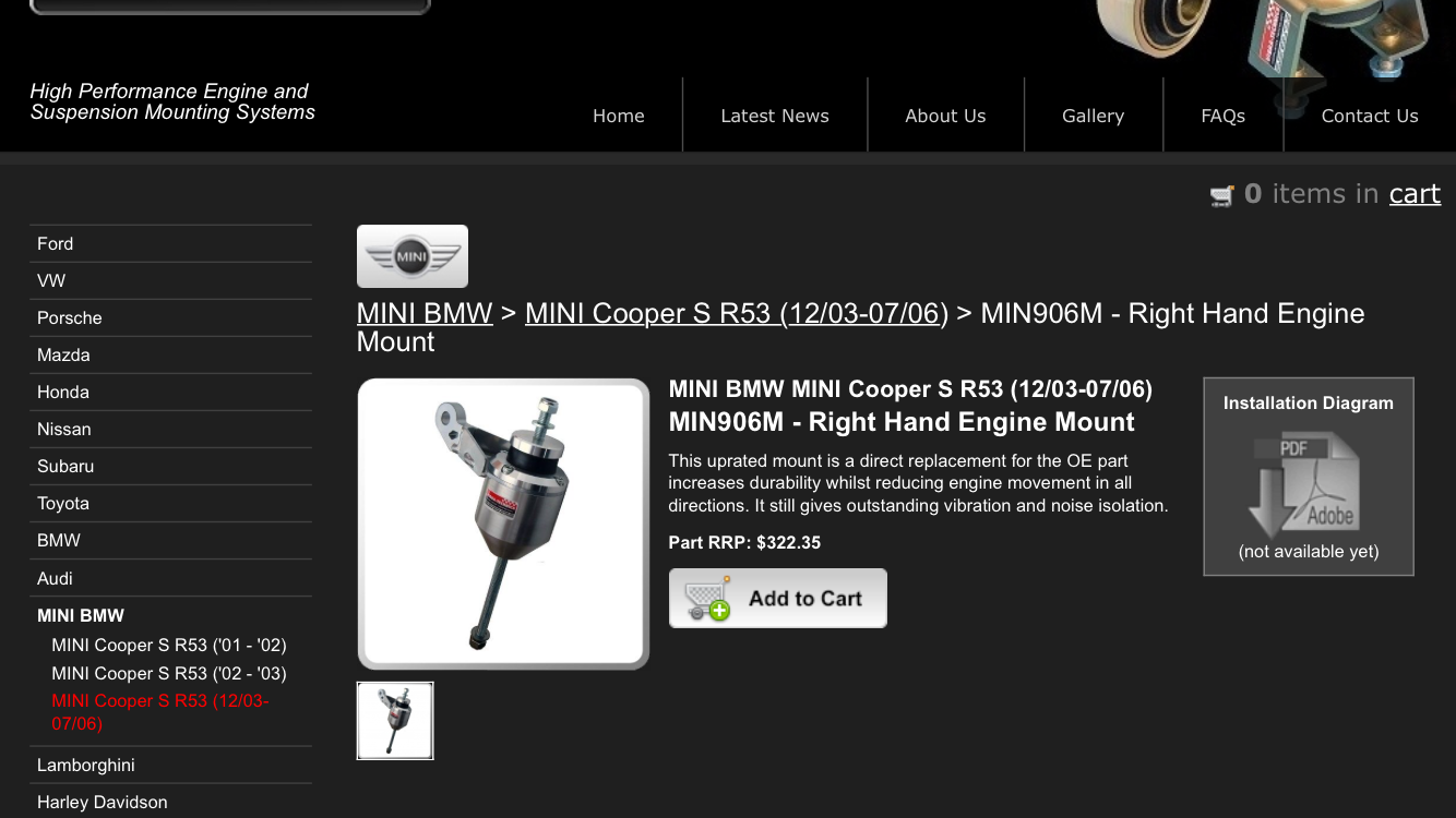

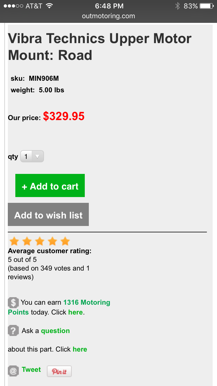

As for the engine mount, and I always appreciate you guys in the know recommending "best practice" repairs, but I'm thinking of sticking with the inferior OEM mount (that sounds so stupid even as I write it). I know...I know, pay me now, pay me later, but there are a couple of reasons, at least for me in my particular situation, why I think I should go this route.
#1-is the cost unfortunately. I bought this car as a 3rd little fun car. Really it was suppose to end up being my "beater," but I can't stomach the thought of not taking relatively good care of it. But that doesn't mean I'm going to spend the dough as if I were planning on restoring the car. Sure the OEM engine mount will fail again in 30k miles (what a piece of crap), but the chances of me still having the car after 2-3 years are very slim and the mileage won't be even close. Even if I do keep it longer/add the miles, I could go through 3 OEM engine mounts ($65) with labor, for the price of one Vibra Technics mount ($325) with labor. From what I read, it seems like an easy repair/accessible and so labor with my mini tech shouldn't be a big deal. And ultimately, it looks like I need to plan ahead for some other costly repairs (Power Steering? Clutch?), so every little bit helps.
#2-I also read that with these aftermarket engine mounts VT or TSX that there is a significant increase in NVH. Not that I'm old, and not familiar to firm rides, but I already find the ride pretty firm. I actually cringe going over some of our very poor PA roads now, I couldn't imagine what it would be like with these aftermarket mounts. Then again, I was reading reviews and threads from several years ago (I guess when these mounts first became available), so maybe they have improved the design/comfort level?

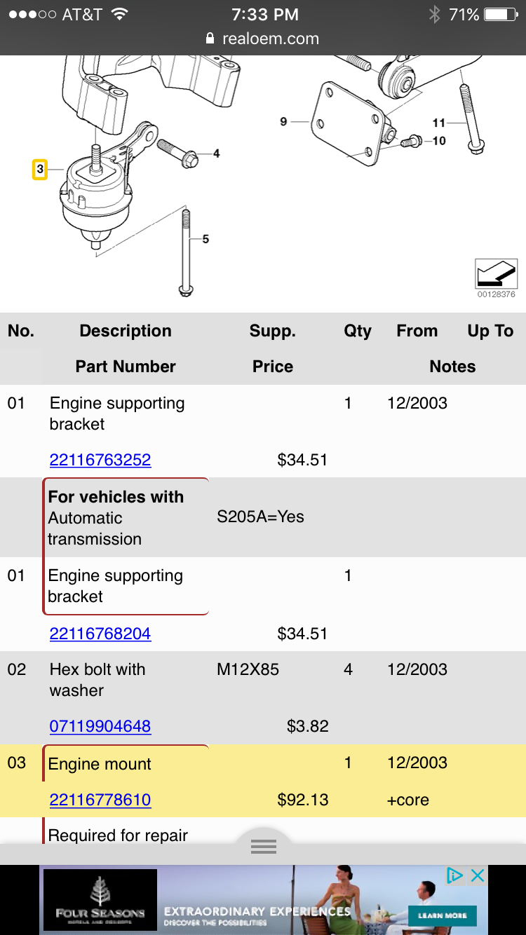

I know I'm going against the grain, but can someone please confirm that the OEM engine mount in the screenshot from Rock Auto ($69 Rein Automotive #22116778610) is the correct engine mount I need to purchase?
Now as for the clutch...I'm confused, b/c I read mixed advice. Some say it isn't a problem and actually not atypical for clutch pedals to squeak--especially it shouldn't be a problem if the noise is still generated with the car turned off--focusing on the clutch pedal itself. But then I've read other accounts like what you are saying about the guide tube. So what are we actually talking about $$$ wise? You mentioned earlier to me that the noise will get progressively worse over time, but then what? Will I need a new clutch job or can it be a "simple" replacement part (I know, nothing is simple when working on the trans)? Honestly, this is the frustrating part! I must have been delusional thinking I could enjoy this car for a few years with just attending to some standard maintenance issues, but the list is growing fast and I haven't even owned the car for a month yet! It bothers me (at times) to already be thinking what's my breaking point? How much do I want to invest in this car? I imagine it's like a gambling addiction...I'll play one more hand and this one will get me out from being under, but then it doesn't, and I fall deeper, and I'm constantly playing to catch up. Talk about being so dramatic so early in the morning!!!! Man up! Maybe I should go to the gym??? LOL
Attached Thumbnails Findings After PPI-enginemount6.png   Findings After PPI-enginemount5.png   Findings After PPI-enginemount2.png   Findings After PPI-enginemount3.png
