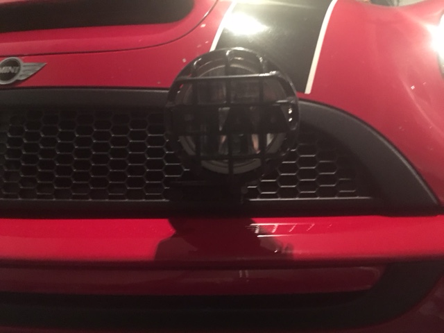

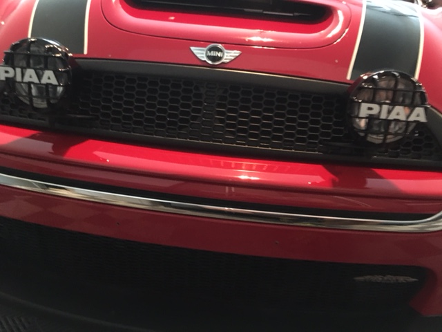

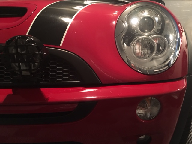

It's going to take some time, but I did just complete my first DIY cosmetic exterior modifications with some plastidip Haha. I also touched up the numerous rock chips. Baby steps...baby steps LOL
Before and after pics. Previous owner didn't install the lower aero bumper and I didn't like the chrome look or the white lettering on the PIAA.
Don't worry, I made sure to cover up all the inlets so plastidip didn't get everywhere.
