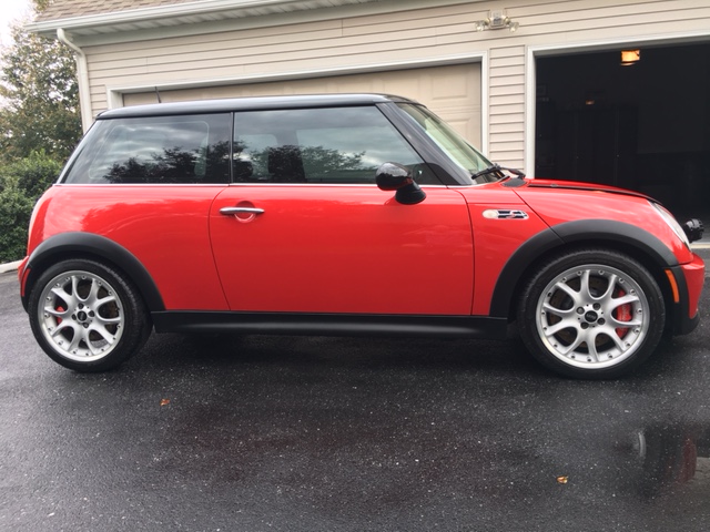

Here are a few pics after a good wash/sealant. I'll probably start a new thread on how pretty she is

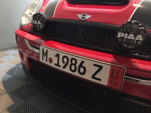

Tell me your opinions...I'm in PA and got this car from MD which has front plates, PA does not. Obviously when I removed the MD front plates I have two holes in the bumper. Should I leave as is, purchase bumper plugs (which seem relative expensive for what they are), or use one of my Zoll plates from when I did European Delivery on my M4?
Also, rally lights, keep the PIAA covers on or off?
My clutch squeaked a bit....never had an issue...might want too look to be sure it's dry, and not weeping, but mine squeaked on and off for a few years....seemed to be temperature dependant.
Imo a euro plate on a us car kinda looks a bit doushy...maybe just due to my background....guess depends on the other items you add on to dress up a car, but MINI are about individualism so it is about what you like.
I'd just get the plugs and forgo the euro plate. And the clutch squeak will eventually turn into a crunch and that's when you should start thinking about repair work.
Also, get yourself a cargo area cover to protect the interior from dirt and dog hair.
Yeah, I'm not feeling the zoll plate either. Too bad the bumper isn't black like my previous 335is from a few years back which I had transferred from MD (also had a front plate). I just went to Lowes and found these black plastic plugs that cost pennies and it worked out well.

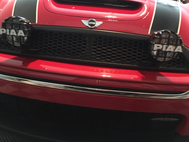

I am thinking of plasti dipping the chrome strip black to match the upper section (not about to get the aero bumper) and also black out the PIAA logos.
