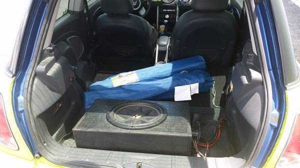

That makes sense, it has an aftermarket sub and amp in the hatch, it was there when I bought the car so I haven't went wire searching back there yet. Any ideas what to look for?

I'd bet $ they either did a bad splice, or just yanked the constant 12v "stay alive" wire for the radio to do something....where they cut/tapped it, who knows....it SHOULD be connected to the back of the stock radio...
Guessing it will be a mess....the stock radio does not have RCA or line level outputs, making it a poor choice too add aftermarket Amps too....it can be done, with so.e extra parts, but the sound would never be as clear.
Looks like the car was repainted too.... apparently a quick job...no trim done...ouch...

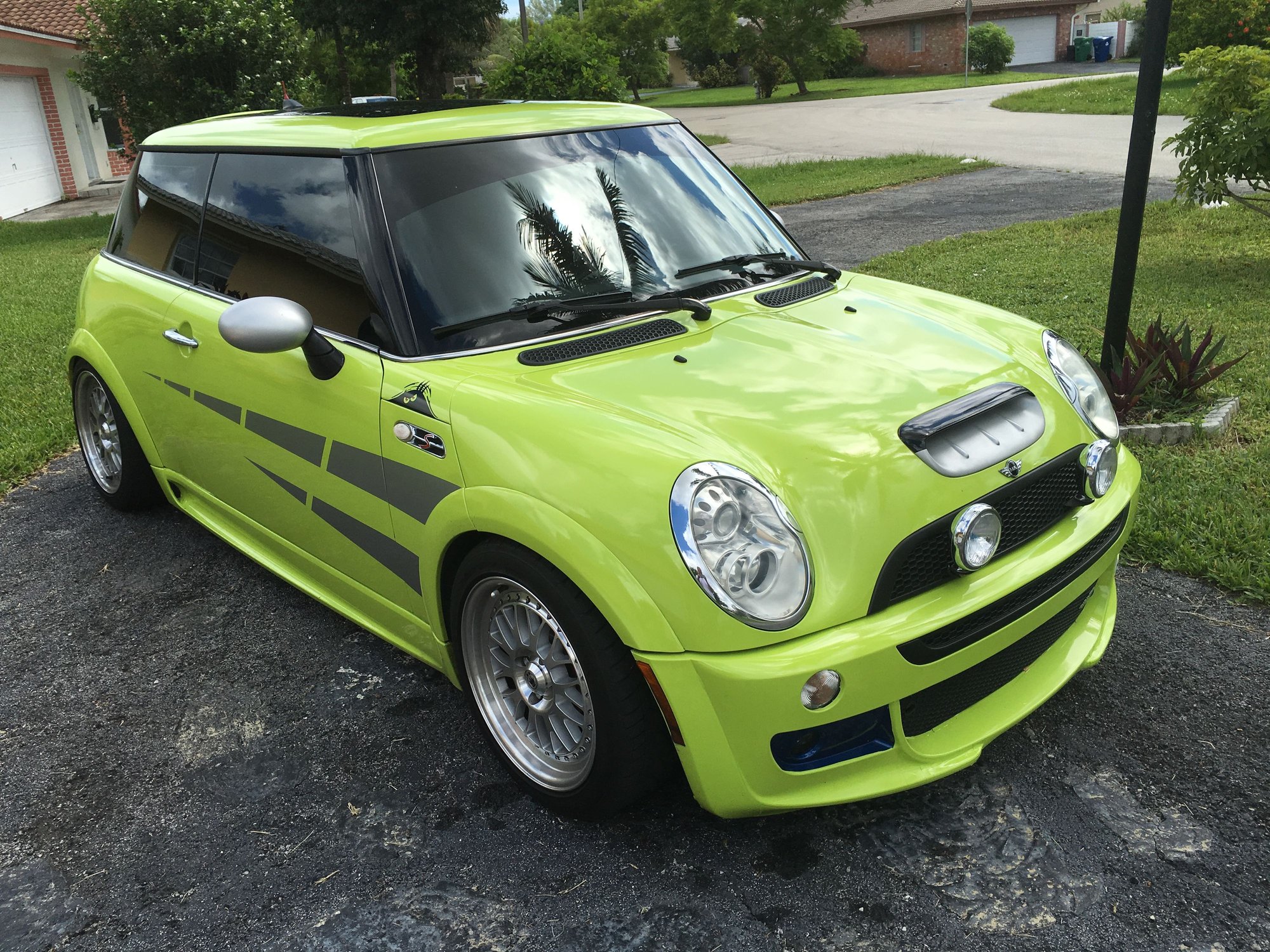

I think that the amp and sub are wired to the HK amp, not sure though. I have taken out the head unit before to check if a wire was disconnected and there's nothing out of the ordinary back there. I haven't taken the panel off yet where the HK amp is or where the stereo wires go in yet, might have to and see what's back there.
As for the blue in the jams, the car is wrapped in lime green vinyl, not painted. The PO did it himself with a friend so it's definitely not professionally done and is eventually going to change once the money comes available to do so, but for now it is what it is lol...

Looks pretty cool!

You should look for a dumpster so you can dispose of that sub responsibly.
Look, I know that a lot of people like a thumping bass. But the Mini is a small car inside. A sub is just not needed... in my opinion.

HOWEVER (and this is a big however) if the sub installer did some crazy wiring stuff (which they would have to have done because of how the H/K system works with the OEM H/K amp, etc) you may never know what they did. I think it very unlikely that the H/K amp is even hooked up or functioning. There's just no feasible way to wire a sub into that system.
