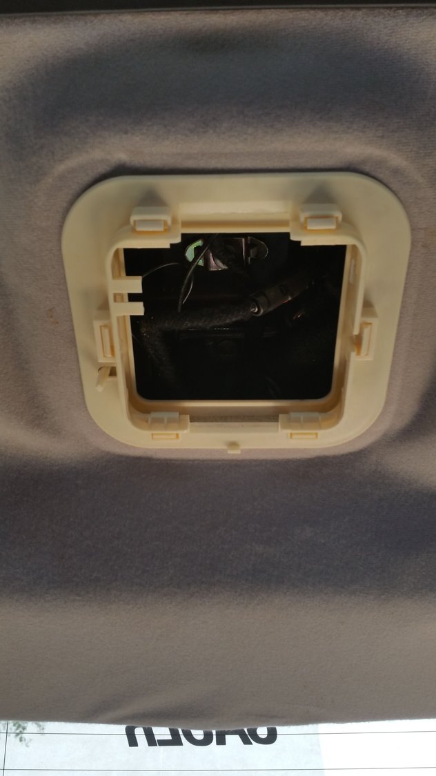

I had searched and read all I could find about replacing it, after the dealer wanted to charge me $700 to do it. Everything I saw or heard entailed removing the headliner to get at the bolt. I have a piece right behind my sunroof and just underneath the antenna that I've been told is for the factory alarm system.
I was able to pry that off carefully with a flathead screwdriver and this is what I saw.
Upon closer n inspection and after moving the wiring out of the way I could see the nut holding the antenna on.
I was able to use a Rob Grip and break the nut loose enough that I could unscrew it with my fingers. After that I disconnected the wires fairly easily other than the fact that one of them is fairly short. After that I was able to put the new base in and reconnect the wires and finger tighten the nut back on. Once I had it finger tight I used some good needle nose pliers (don't have the 22mm socket or wrench that it takes) and tighten it down good. Here's the new nut after I got it all tightened.
Next I just stuffed the wires up into the hole and replaced the cover. And here's the finished product.

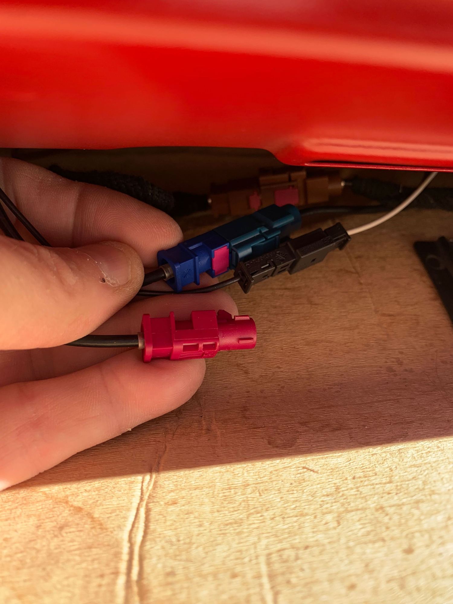

I have the same problem, my antenna looks just like Gadgetrunt's first picture, all smashed up. My car has also got the Navigation. I dropped the headliner a little and fished around for the wires? I saw this?
R53 Antenna with Nav
If I have the Navigation System, shouldn't that pink connection be connected to something?
Did you have the same problem Vincent?

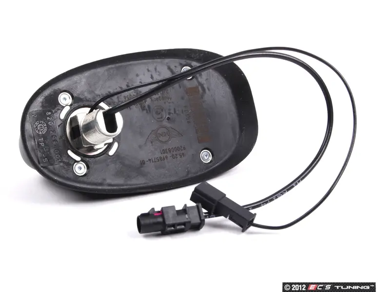

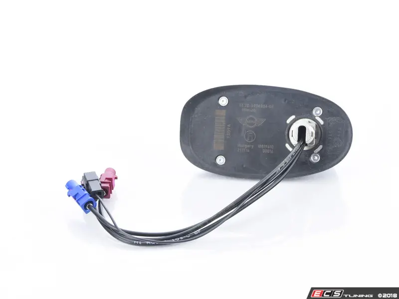

To anwser the base it should be a match to match and the plugs should match up.
In 7/2004 on gen 1 MINIs their was a split year
https://www.ecstuning.com/Mini-2005-...rior/Antennas/
More plugs for navigation 65206934304
Less plugs for NON Navigation 65206985714
Early design non nav
Early design NAV (shark fin design)
Old Jul 17, 2023 | 03:44 PM
