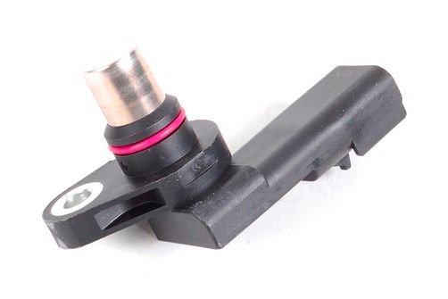

Originally Posted by ladsjohn
Is there a cam position sensor o-ring?
Yes there is -- it's on the passenger side of the head, behind the engine mount, which has to be removed in order to get to it.
Unfortunately, the car will need to be in front-end service mode to perform this service.
To change it, you need to have the car up on stands, support the weight of the engine from underneath with a block of wood on a jack, Remove lower engine mount, remove nut on upper engine mount, remove ground cable (on engine mount), slide fuel vent cartridge and associated lines to the side, then jack engine up enough to clear stud on top of upper engine mount, loosen and remove the four bolts holding it to the block and wiggle it out. You will then see the camshaft sensor on the side of the head attached similar (10mm bolt) to the crankshaft sensor you replaced earlier.
Other sources of oil seepage that you could have are the crankshaft seal (on the timing cover behind the crankshaft dampener pulley), timing cover gasket or timing chain tensioner.

Originally Posted by Mini Mania
Here is the O Ring and the assembled unit. Do you think this is what is missing?
The parts pictured above are the crankshaft sensor and o-ring.
The OP was referring to whether there was a camshaft position sensor o-ring.
Correct part pictured here:

Posts: 9
Do you have to change the complete cam sensor or can just the gasket be changed on the sensor. I assume it is the red ring in the picture from AoxoMoxoA.
Don't waste your money on an o-ring that is going to leak again, just apply a bead of black RTV over the existing o-ring, clean the surfaces and reassemble.

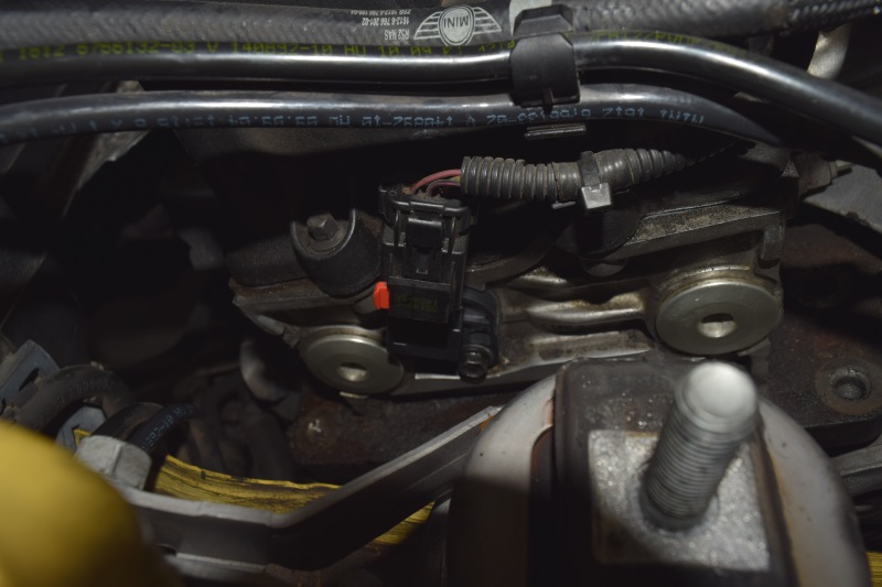

Yeah, I broke down when I did all of my work and just replaced the sensors. Need to still replace the valve cover but I am loving how dry everything is again.
The cam sensor threw a CEL at 114k miles so it was replaced. While the MINI was in service mode, I was not messing with the o-ring and replaced the crank sensor as well while I was "in there".

Cam Sensor:
Hope this helps.
