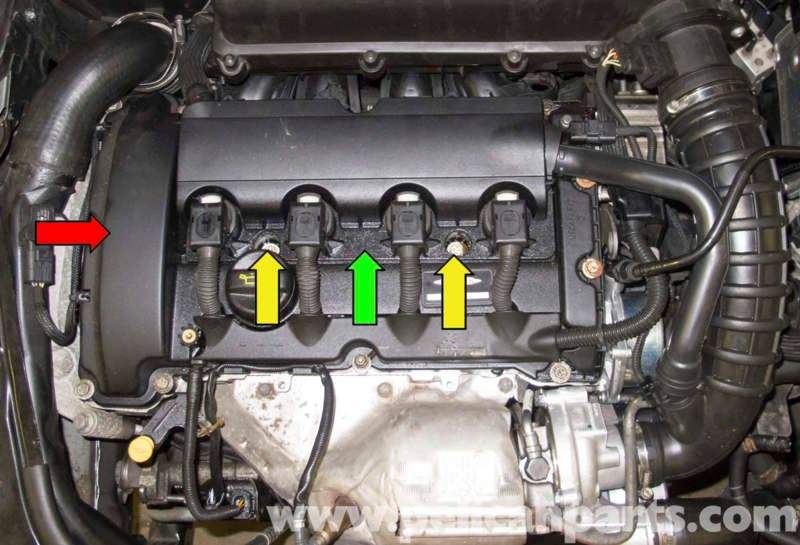

Seems like you're on the right path as engine oil can also leak into the spark plug holes in the cylinder head, contaminating the ignition coil boot. Thoroughly inspect the valve cover gasket and look out for oil residue. The R56 is also known to have issues with the valve cover cracking and leaking. You can see the residue by the coils on the photo below (ignore the arrows). You're also about at the mileage for a carbon clean up. Has that been done yet to your MINI?
