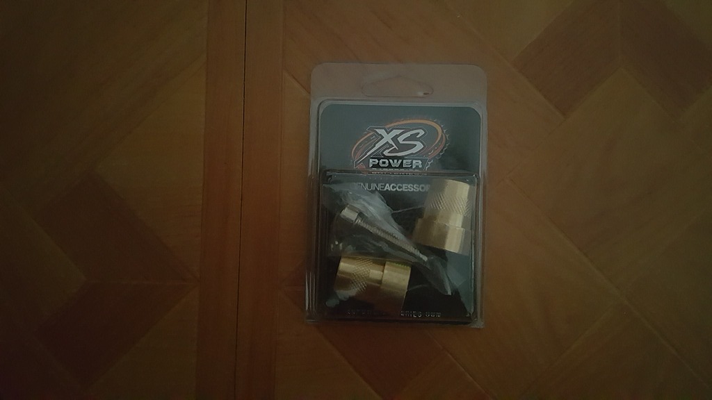

Yeah mine didn't so had to buy them separately. As for the CCA, it may seems low, but my car starts every times. Doesn't sound like it's struggling or anything. I've had the battery for two months, so I can't tell you if it's bulletproof or not yet! I avoid doing anything that involves leaving something on while the car is off (listening to the radio while cleaning it, etc) as the reserve is 30 minutes, which is a 1/3 of a normal battery.

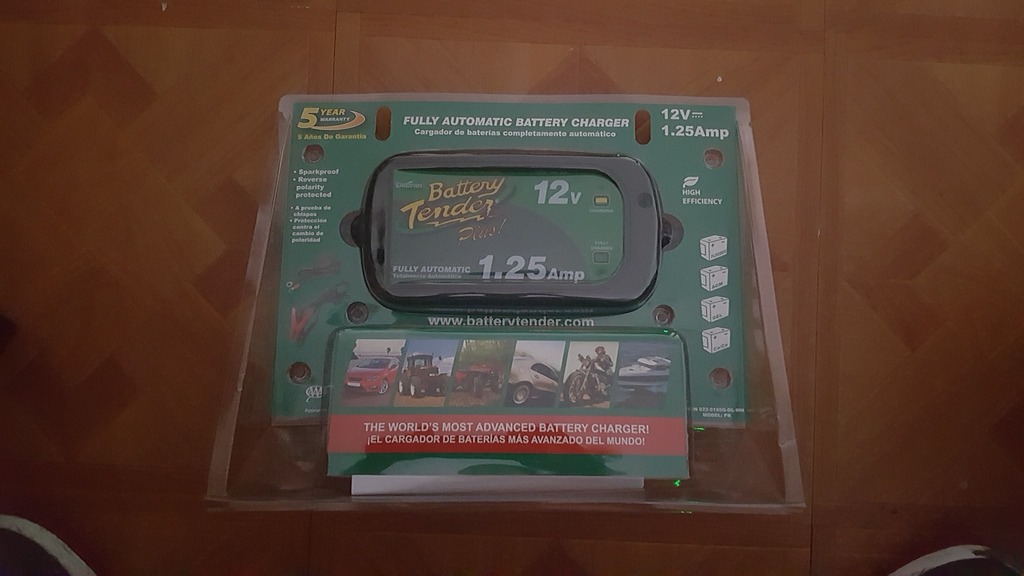

I ordered the PC680 and terminals. Also got the 5W Solar Battery Tender. Waiting to get the battery to see if i can make the stock work or get the holder for it. I'm not doing the delete like you yet at least lol.
Old May 31, 2016 | 05:13 PM
HaveATank's Avatar
HaveATank
Joined: Jul 2015
Posts: 460
I just got the battery OMG is this thing super super small. Also got a Regular Battery tender and the Solar Panel one.

Charging it before i got put it in the car

Old Jun 1, 2016 | 02:59 AM
JKo's Avatar
JKo
Joined: Oct 2012
Posts: 179
Likes: 25
From: Finland, Europe, Earth
The Odyssey PC680 was useless in the winter, so I got a Braille B2015. It's still only 15lbs, and while it's not the perfect winter solution it's CCA rating of 425A is far better than the Odyssey's 170A.
Old Jun 1, 2016 | 05:30 AM
HaveATank's Avatar
HaveATank
Joined: Jul 2015
Posts: 460
Wouldn't a jump do the trick? I dont plan on driving this car in winter more then likely it will just sit. Ill turn it on just to get things going and all. Maybe drive it around the block. I guess ill keep this other battery in mind let see how this one perform.
