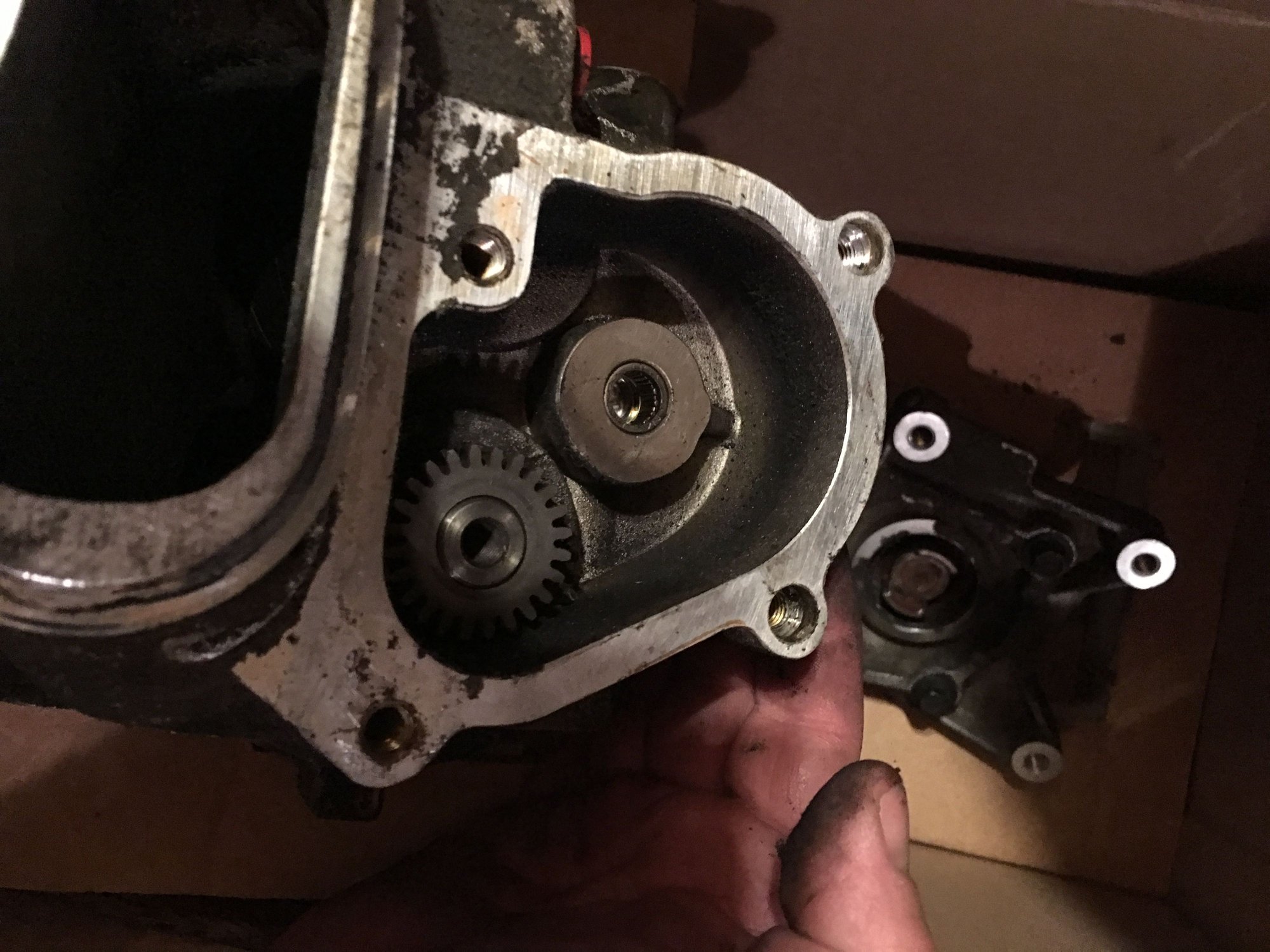

Thinking about pulling the supercharger and performing an oil service at some point in the coming months.
My question is:
Rather than just dumping and replacing the supercharger oil at both ends, is it a good idea to crack open the water pump end to inspect and clean up the internal gears & chamber? I assume to open the pulley end, you would have to remove the pulley, but what about that location as well?
If either can or should be done, I haven't seen a gasket for when it is reassembled. Is there a gasket, or does one just use high-temp RTV?
TIA

If you have it off, you might as well take the water pump side off and see how it looks. I'm always curious to see how the water pump gears are doing. I suppose if you get oil out of the end then you don't really need to look. And if you don't get oil, you probably don't really need to look. I have never messed with the nose end.

I know you're in the middle of an engine rebuild... Have you already, or do you plan to take the water pump end of your supercharger off? When putting it back, is there a gasket that you know of, or are you planning to use high-temp RTV?

I've taken it apart a few times, for the life of me I can't remember if there is a gasket or not. I will take a look at my old one when I get home tonight.

Sorry for the delay. My old supercharger was buried under all my new parts finally dug it out last night. There is no gasket on the water pump end.

Originally Posted by ZippyNH
The water pump users an anaerobic sealent, but some have used black high temp RTV.
No gasket, but as ZippyNH said, anaerobic sealant is used

I used high temp grey rtv for nose cone and rear gear plate. No leaks. I had a ***** of a time getting my pulley off, picked up a rebuilt nose cone without pulley for a hundred bucks on eBay.
The green gasket must be replaced and must be installed properly or vacuum leaks will be the death of you.
Use AC delco supercharger oil.
Use the correct amount (Google is your friend)
If you put too much the oil will aerate and premature wear will occur on gears and bearings.
