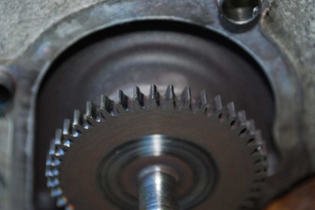

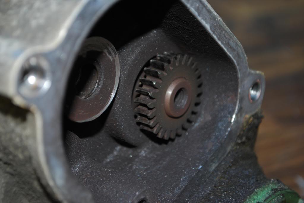

well i guess better late than never.... finally remembered to post these pic's
when i cracked this open it was completely dry and quite a bit of powered metal poured out. as you can see the in the first pic the bushing is ovaled out and i dont rember if it was touching the casting. and i dont have any other pics. the small gear was warn out, and the big gear turned to a knife blades. not really a big deal it could have gone much longer i think. and i dont have pics of the other side with the bearing and how wobbly it was.
