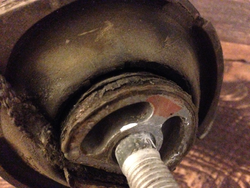

Careful with the engine mount - the early models 2002 and 2003 don't necessarily leak fluid - they crack see my photo. You could not see that from the top with it installed. It crumbled in my hands. The engine mounts wear - I kind of go with the ounce worth of prevention rule on things like this - engine slopping around isn't really good for the drivetrain.
